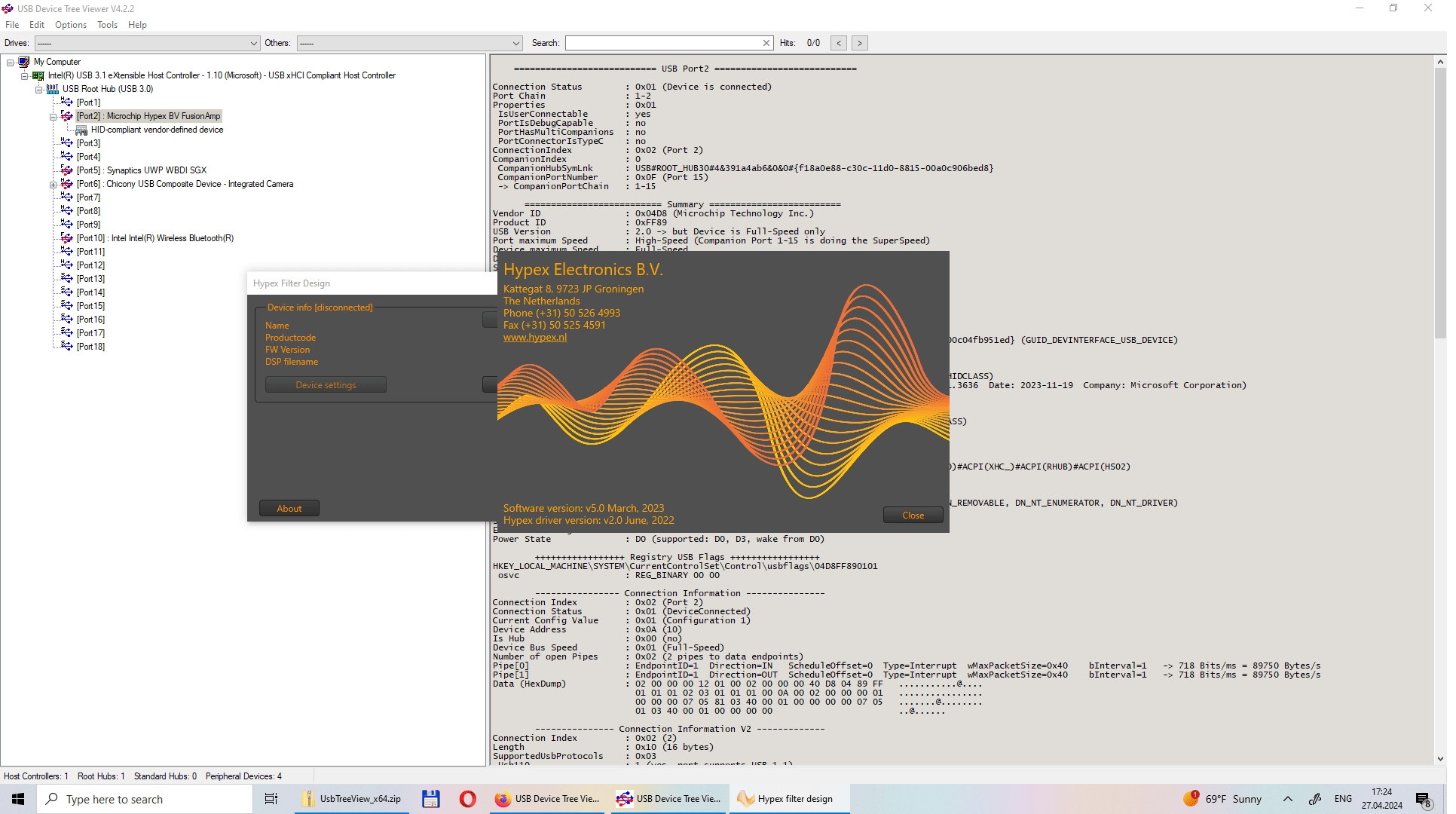

so I tried changing the file location for the filter design. It was defaulting to "d:/" which is where a usb drive shows up if I'm using one - which I wasn't. Changing the drive folder didnt seem to work: it kept defaulting back to "d". So I plugged in a thumb drive so there would be something there and that worked. Now I can build my filters, as long as I have usb drive connected.
Not sure if it matters, but check that you have selected a database location. I think default is documents/filterdata/
Edit: ah, did not see your last post. So then you must select a location that exists ;-)
I think you are right. I had some trouble uninstalling the old version too. Anyway its wprking now so I appreciate the help from members who chimed in!It might be issue with filter files created with old versions.

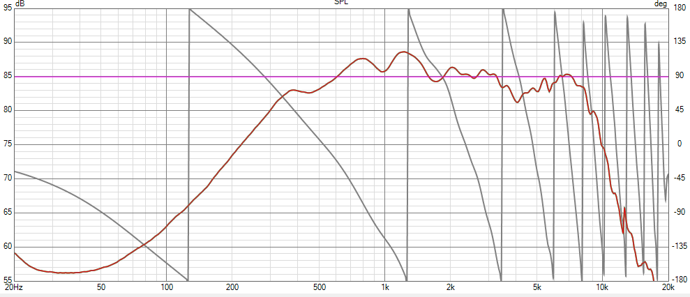

Hi all,
I searched for hours but it's shocking how I seem to be the only one with this problem. Must be because I'm a noob?
When importing impulse responses from REW into HFD, the magnitude/SPL is all over the place
.. like there can be 100db difference between drivers 🙂
I measured all my drivers 0-24000hz. Using scarlet 2i2 and Dayton EMM6. Measurements look great in REW:
Purple=Woofer, Blue=Mid, Green=Tweeter
So I export the impulse as text, I keep my REW IR Window (not that it makes much of a difference), I don't normalize. Normalizing gives other crazy results. I basically tried using all combo's of the Export impulse window in REW.
Import impulse response into HFD and then I get:
These are just midrange (channel 2) and tweeter (channel 3). The woofer (channel 1) is 100dB louder and nowhere to be seen 😏
Can anybody tell me what I'm doing wrong?
Thanks!

Hmm that's bad 🙄 Admittedly I'm more experienced with REW than with HFD, but I feel like REW is more user-friendly and intuitive to do these kinds of things. So splicing a nearfield and farfield is also possible with HFD?

What happens when you load your impulses into VituixCAD? Same result?

Cheers, I do speak dutch and I understand the instructions. It's too late here to tell my kids to go outside for new measurements 😛 but I'll give it a go next week.
About VituixCAD: the difference is that you can (have to?) import a frequency response there, not an impulse file. I just exported my MID in REW and imported. Perfect match. Peak 88 db. In a way logical of course since the frequency response contains all this data. HFD y u no import frequency response file 😊
Edit: I found the option to import Impulse in VituixCAD and they look as weird as they do in HFD. So on one hand, my IR are broken, on the other hand, if I could import the FR into HFD I wouldn't care about IR.
If I find out how I can fix my exported IR I will report the fix here, might help somebody else.

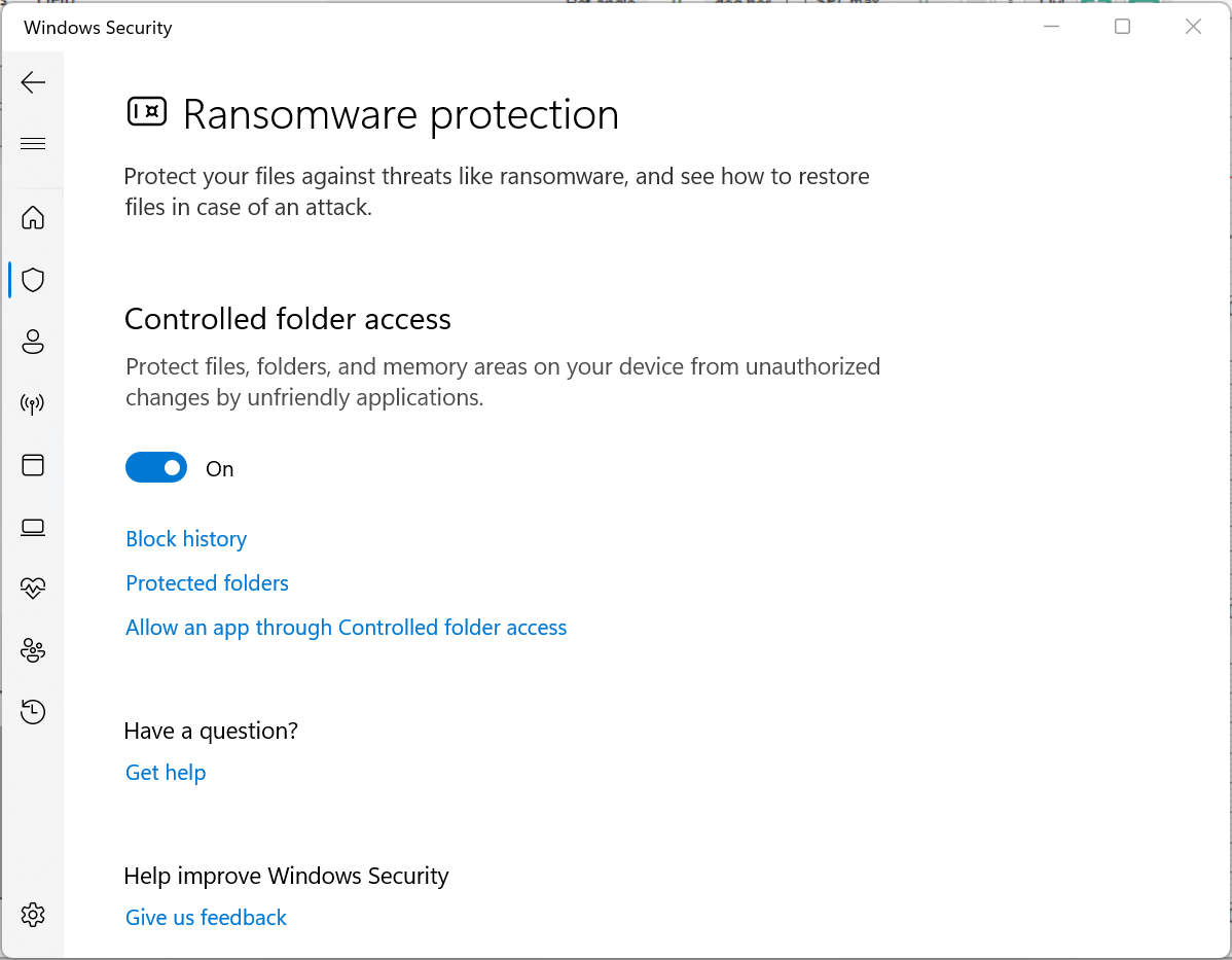

Hi, I'm sorry for the late reply. Try to disable the Controlled Folders feature in Windows. This should help.Hi! I'm having the exact same issue at the momwnt. Did you manage to resolve it? Thank you!!

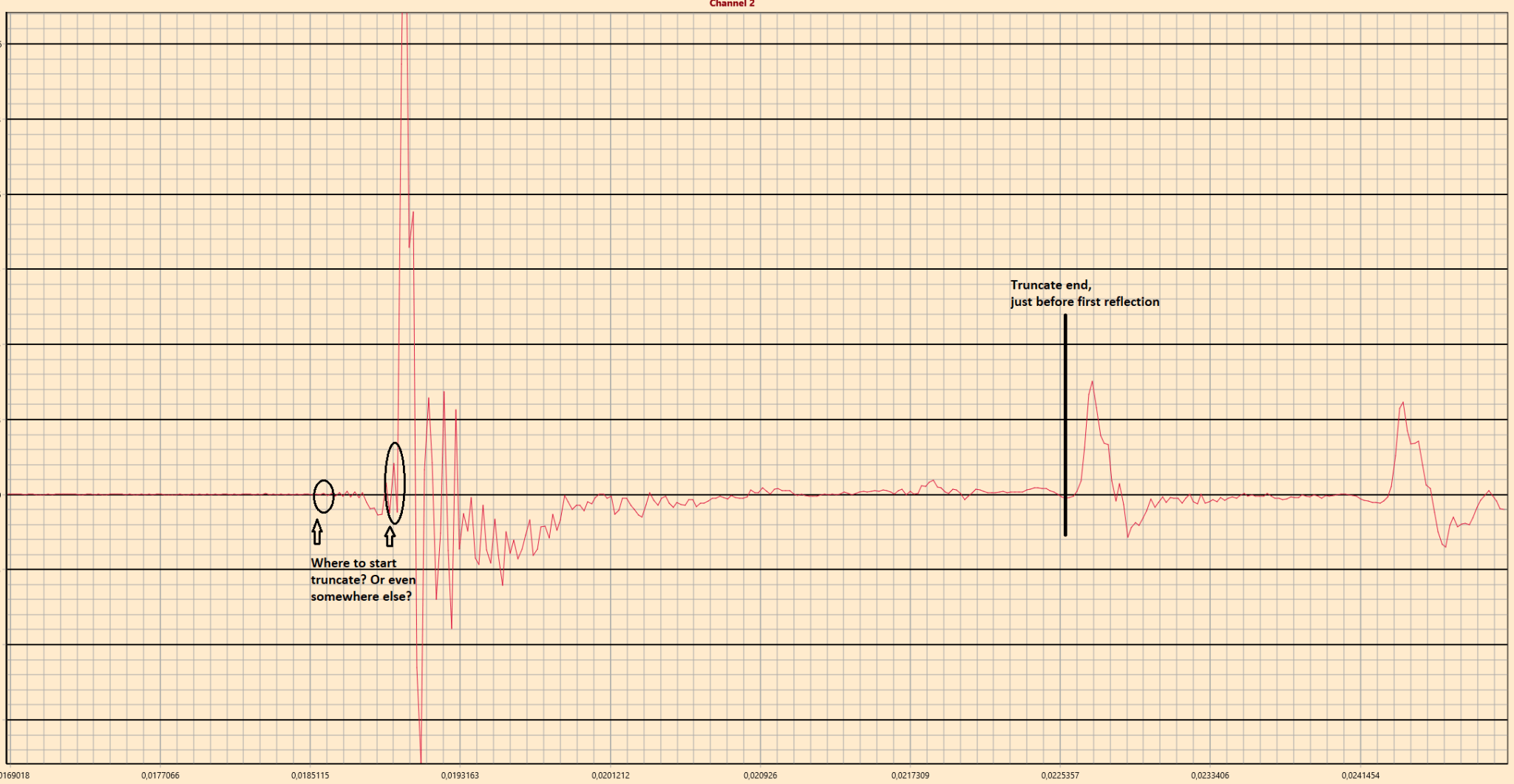

A new day, a new question I'm afraid 😊 I'm hoping somebody here has some experience with Recording/Take measurement in Hypex Filter Design.
So my goal is to use the Recording feature in HFD, and to design a filter that results in a FR in REW that's more-or-less identical to my designed filter. However, there's a difference that's probaby related to something I'm not doing or doing wrong in HFD.
In HFD, in the Impulse window you can truncate the response, much like the IR window in REW. Where to end the window seems logical. But what about the start? It seems to make a huge difference in the resulting SPL sum. What should I choose?
Related question: you can click on a piece of the impulse and set the "Phase start time". What should I choose, and what does it do? It doesn't seem to alter anything. This is what Hypex says about it:
What "right delays" are these? I'm also using delays in my channels that I've found to be correct, trough measuring in REW. Do I still need to set this "Phase start time"?
After truncating the impulse response, you can set its start value to be used in all channels. That way, your SUM response will always use the right delays which were inserted during the measurement of all drivers. But only when your measurement setup did not change during the actual measurements.

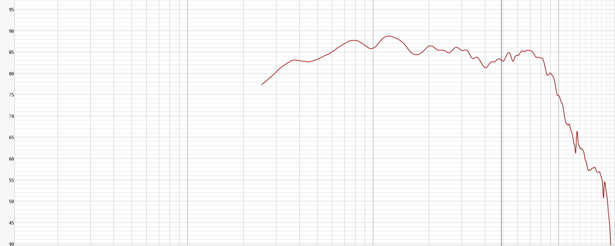

What hardware do you have? If you're thinking about importing measurements from the manufacturer, I think you should measure your drivers in your own enclosure.
