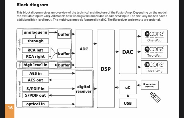

If I understand the diagram correctly, as I use a digital source via S/PDIF in, the signal that the second FusionAmp received is routed through DSP from the first FA’s S/PDIF in -> digital receiver (?) -> DSP -> digital receiver -> S/PDIF out -> FA2's -> S/PDIF in. No issues with latency whatsoever?
And you have to set delay anyways for correct timing of the speakers + filters? The rest is stable.

The "proper" solution, having the powerful FA version, only routes the source into the DSP once, and while the DSP processed signal in the main amp already continues to the DAC, it must return via the digital receiver into the other FA, where it is transmitted to the DSP and finally, five steps later then with the main amp, enters the DAC of the daisy chained FA. I just wonder if they will play together quite well this way and what it means for integration.
This is were I took my information about the routing from. The signal would pass through DSP, not?
Yes, but the DSP operation could be simply "pass on unchanged".The signal would pass through DSP, not?

There is no arrow back from the DSP to the digital receiver. You also can't send channels AFTER DSP to a digital output (which is A PITTY!).This is were I took my information about the routing from. The signal would pass through DSP, not?
So I'm pretty sure they just pass the digital signal 1:1 from input to output in the "digital receiver" circuit, there should be minimal delay if any.

Yes this is also my interpretation of the flow of digital signal. Also the digital signal is passed on unchanged, with both left and right channel information (logically) so when you connect your sub (digitally) you can selct both left and right channels in the initial set up screen so that the sub is reproducing the total content of L and R channels.There is no arrow back from the DSP to the digital receiver. You also can't send channels AFTER DSP to a digital output (which is A PITTY!).
