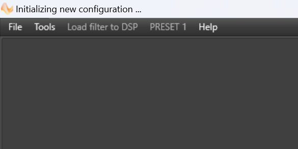

Hi! I'm having the exact same issue at the momwnt. Did you manage to resolve it? Thank you!!I'm trying to configure filters for FA123 plate amplifiers and it seems that HFD software isn't working. When creating a new filter configuration, the app hangs at that state:
It never initializes new configuration. My computer is an ASUS laptop with Windows 11 installed. I tried both 4.981 and 4.97 software versions.
Is there something I can do to fix the issue? Probably, there are some log files to figure out what's going wrong with the software?
Yes, I started with that version, then tried the 4.97 with the same result. Now back to 5.0And you have tried HFD v5.0?
