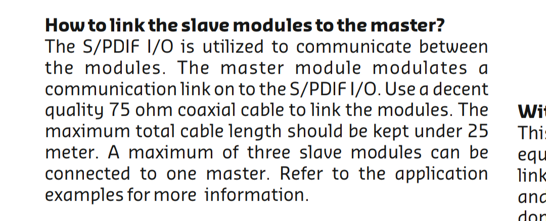

I just got 2 Fusion amps and I'd like to connect the master with the coaxial spdif out on my streamer, then daisy chain the slave via aes. Cable length will be something like 5-6 meters so I'd prefer aes.
From what I read in the manual I think this should be possible but it's not 100% clear to me.
Can somebody confirm this works, before I start buying cables 🙂
So spdif in, aes out

This works. I got miniDSP SHD -> SPDIF coax (3 meters) -> Hypex FA123 -> AES (5 meters) -> FA123.

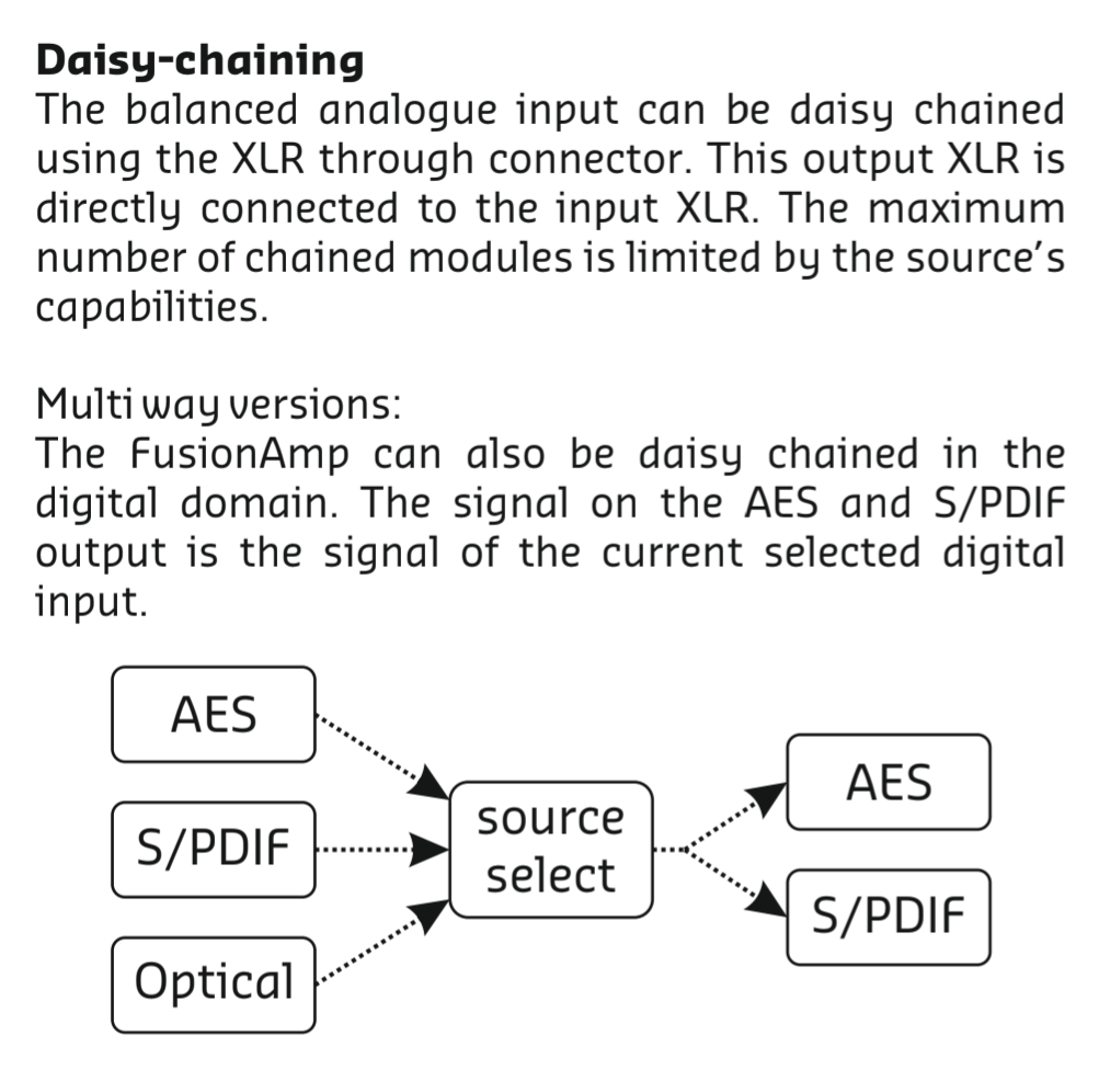

You will get the sound but usually one box is the master and the other the slave. Signals from the master regarding volume or present changes are only transmitted via coaxial spdif. This might be ok if you put the remote kit in both speakers but if one gets the IR signal and the other doesn't you have a problem as they are out of sync now.
So interconnect between the speakers should always be coaxial spdif.
This is also in the manual. I attached a screenshot.
Good news: According to the manual up to 25 m cable length is fine.

@mysterious and @CoolJazz I forgot to mention that both of my FA plates are in master mode. That way the volume is controlled in the miniDSP before going to the plates. With digital connection that does not introduce any unwanted noise and works very reliably.
The screenshot in mysterious post is related to using a remote and there, if I understand it, I have never tried it, you can use spdif to relay the volume information from master to slave plates, but audio goes with aes, so two cables!
The screenshot in CoolJazz post is related to daisy chaining in general and shows how inputs are routed to outputs. If the spdif comes from a digital preamp, I would suggest that you do same kind of setup than me: both plates in master mode and volume control in the preamp.
In my setup both control signal and audio go over spdif.
If you attach a laptop with HFD you can see that the master actually tells the slave to switch input/volume/preset.
As this is all digital I don't see any benefit from using AES unless you need more than 25 m of cable length.
If you don't change anything on the w.r.t. volume/preset/input there is obviously no need to even have the spdif connection.
