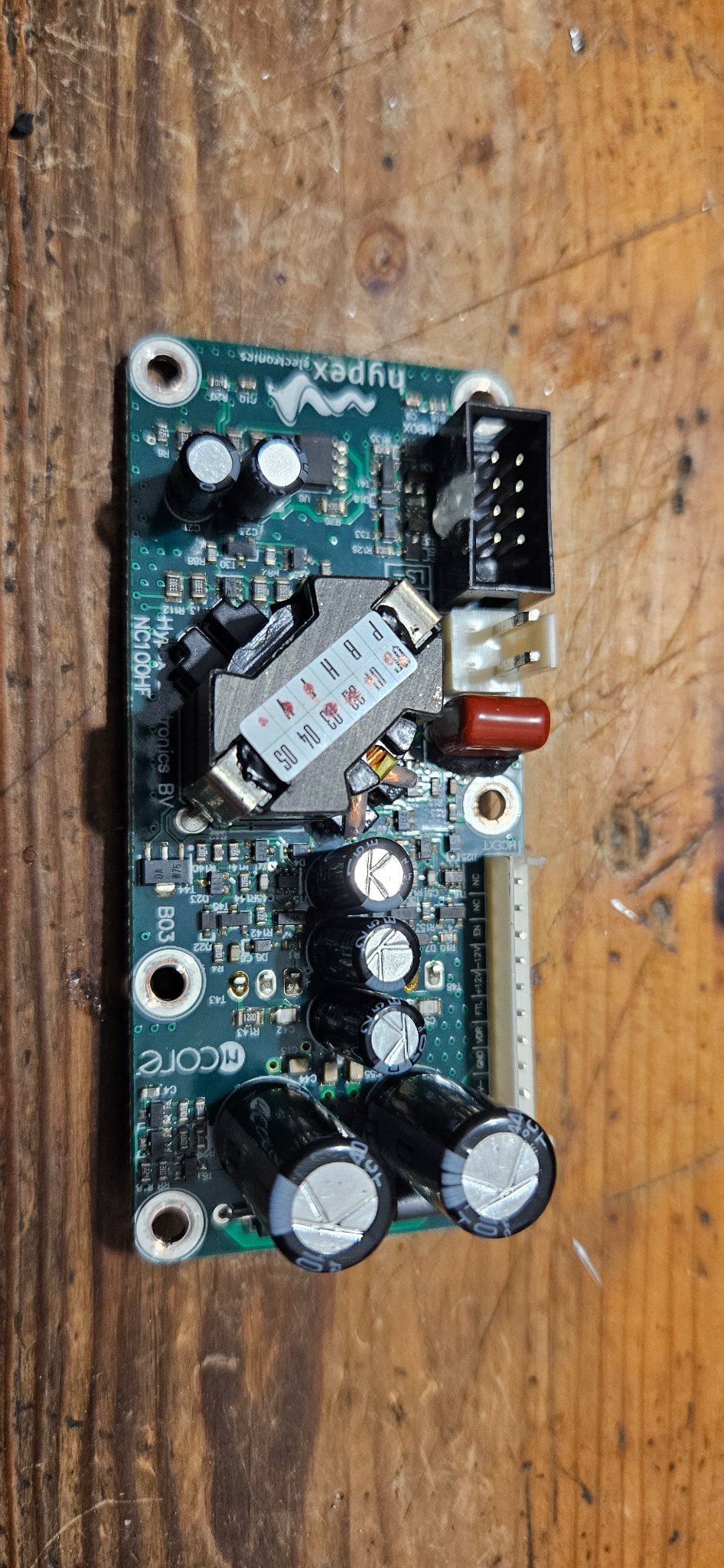

Okay, after discussing the tweeter channel whistling with the Hypex customer service, I decided to replace the caps on the NC100HFs because the support suggested that some of the electrolytic caps might have gone bad after the 6 years of use.
I choosed 7.000 - 10.000 hour Rubycons (the originals are 2.000 hour Su'scons), this somewhat changed the whistling but it remained audible.
After that I decied to replace the single MKT cap of the amp's low-pass filter and wow, all the whistles are gone, the amp is total silent, not a single hiss from it.
I choosed Wima MKP2 (similar to the higher tier Hypex and Purifi amps) 0,68 uF, 100 V (values as the original). This cap fits to the board but it needed to replace the Phillips head screw near the cap to a cylindrical head Allen bolt.
The amps now sounds better than ever, IMO.

Oh - that's interesting news! I use these amps for near field speakers and there is always a "tonal" component to the remaining noise (which you hear on a midrange dome cause of high sensitivity). Does it help against these or was there a definitive error with your board?
Yes, there was a squeaky, whistling noise over the basic "shhh" noise. It was not loud but audible. Now with the new caps, there is just a quiet "shhh" but nothing more and even this basic "shhh" is quieter than before.there is always a "tonal" component to the remaining noise
BTW the other channels of the FA is more tricky to change caps because there is even tighter space for the two film caps. These both are 1 uF, two pieces per channel. The Wima MKS2 fits there but this is a polyester cap, although a new polyester probably better than an old if you have audible squeaking.which you hear on a midrange dome cause of high sensitivity
I ordered a 1 uF MKS2 and an 1 uF MKP2, these caps are in parallel, so one of them will be a better type MKP and these fits to the board, although it needed to remove/crack the unused plastic leg of one of the filter inductor.
Will see how it works.

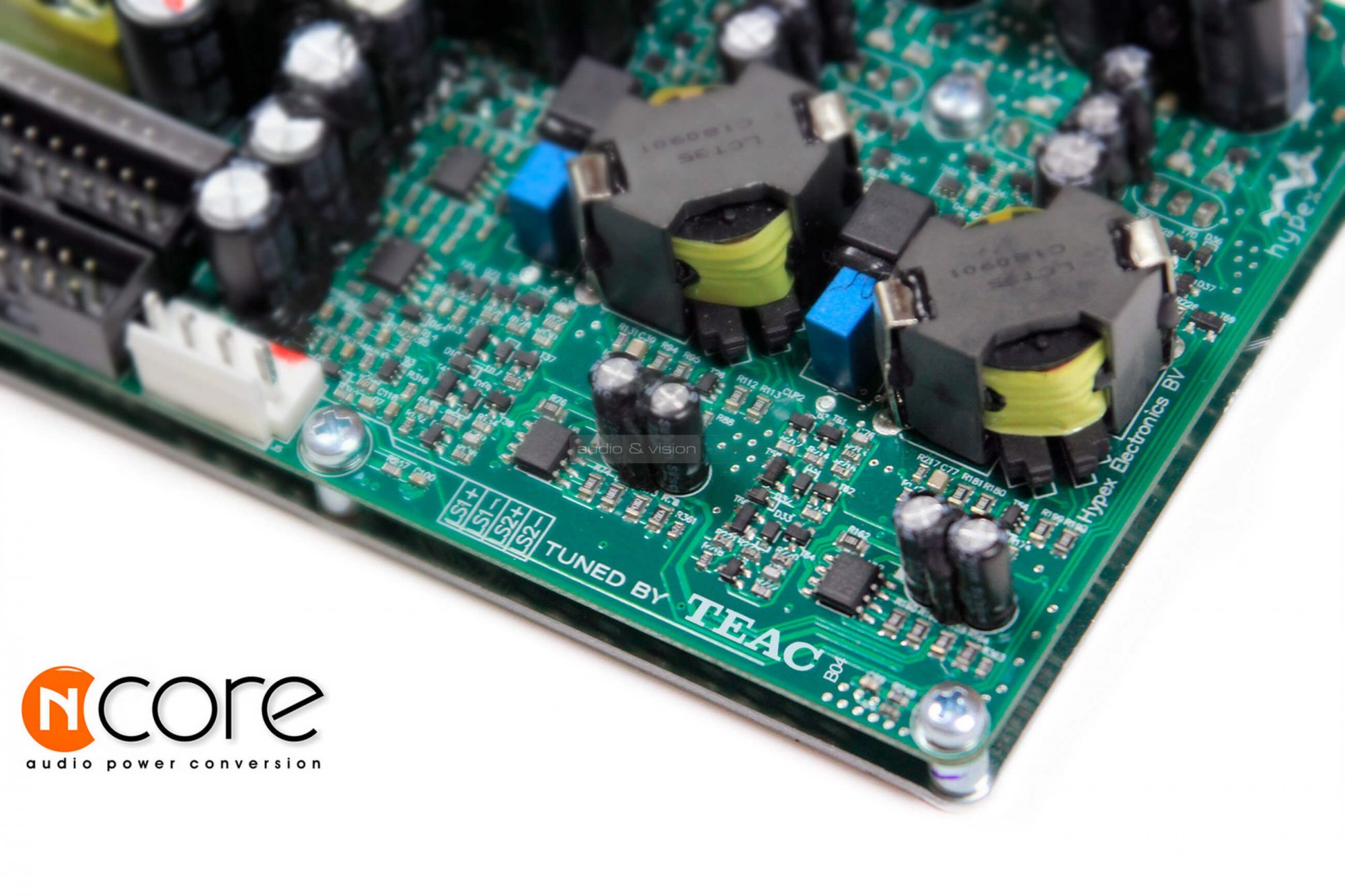

TEAC also using different caps (a default blue as the original and a larger black) here in its ncore based amps:

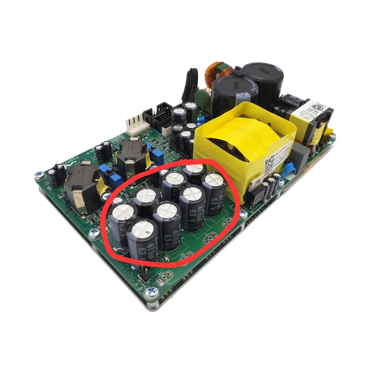

Of course never tried - probably ask them about it?Does anyone knows it would have any benefits of enlarging these 8 capacitors (capacitance and/or Voltage) that is marked on the pic? Or it would be detrimental to the performance or totally unnecessary?
These Amps don't have a problem with short time currents at all - they are thermal limited long therm. So increasing will probably have not a significant effect? Could harm the power supply section if you go crazy, thats for sure.
Maybe using caps with lower ESR to dampen parasitic frequencies better?
