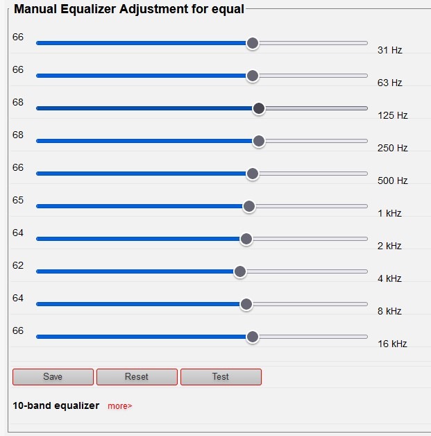

what is the correct input level for S/PDIF of Hypex FA123? I use a Raspi with Hifiberry Digi+ and when I use 100%, it currently has some distorted sounds with high level passages of a song. I mean that at some point this was actually not happening and went away, but I cannot tell for sure.

Yes, this problem occured the first time when I enabled ALSA 10 band equalizer for some corrections that I had not yet transferred into the Hypex filters. Curiously, I immediately took note of it when I first did this and where looking for a place to lower total levels. But: it went away, I had not found a place within PiCorePlayer and could listen at 100% digital output without problems. I had to write the SD again, and set upt the player another time and since then, it is always there, only 90% solves the issue, 95% is still too high.Are you using any EQ anywhere along the audio path? Or a volume setting which allows volumes greater than 100%?
I checked again: It is connected to ALSA mixer. The funny thing it happens even without any changes at the EQ bands.
So are your actual output level at 100% or >100% ;-)View attachment 1027717
My line adjustments due to lazyness to implement them in Hypex. I find it a weird that they do not account for this issue within pCP.

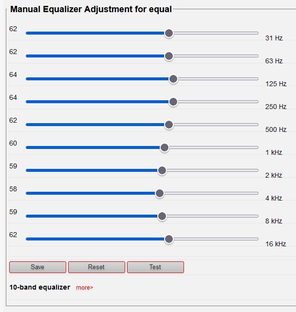

The picture above is not easily understandable, sorry. 66 is the zero position in pCP alsa 10 band EQ. According to this post, it is even slightly below: https://forums.slimdevices.com/show...liser-settings&p=969247&viewfull=1#post969247
With my above setting, there is some boost and I cannot rule out that the signal is higher than 100%, but as I had noted, this "clipping" also occurs with all the faders set to 66, which ought to be no boost at all.

That is in short what the article is about - you need a margin, even 100% will normally cause clipping due to intersample overs, caused by the filter ripple in the DAC's.I have not read the text, sorry, it's longer than what I can handle atm 😉

So while you are at it - ensuring a margin - make sure you add some extra (3dBFS) or the problems will be back on recordings that are maxed out.
