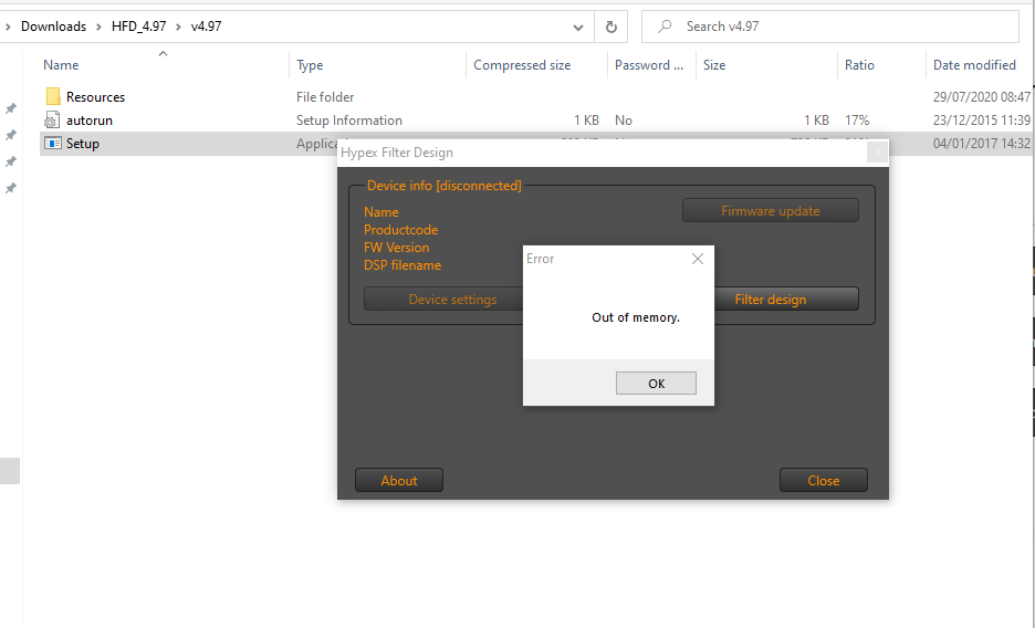

I downloaded the latest HFD ( V4.97) as I wanted to see how it works and to just play/practice with it.
For a day it worked, with the measurements made with its' recorder (I couldn't import any other measurements as they are are all in .txt format).
The next day when opening the program, I got the "out of memory" notification. Even after uninstalling and installing again.
What might be happening?
I come from VituixCAD and am eager to learn and see how this Hypex SW works - I don't actually own any FA series hardware (yet). Does the HFD work "fully" only with the actual hardware connected/recognized?

Hi Draki,
Not sure on the error, but there should be no problem to open the software and play with the filter designer without any hardware connected.
Unfortunately HFD doesn't include the ability to import simple frequency response data, and the built-in measurement system is rather basic, so it's still best to measure using more capable software like REW or ARTA, and then process the measurements and design using software like VituixCAD, then simply transfer the filter information over from VituixCAD to HFD.

I concur fully. That would be the way to be done (if it comes to that, meaning getting FA electronics at some point). BUT, to do that one has to be confident that such hick-ups are not happening. Say you have done all the filter design in V2 and then the HFD program won't open !!! This is giving me the scares...as good as the hardware is.
Joined 2003
Maybe some error with your previous project data, try deleting or renaming the "FilterData" folder that the program creates in your Documents folder.
The program won't open at all. It freezes at this point and can't enter. Restarting / reinstalling several times. 😕
I suggest you contact directly Hypex support. If they get enough complaints that it's not working, they might eventually put some effort into improving it. I complained about another problem some time ago, but no fix was promised yet.The program won't open at all. It freezes at this point and can't enter. Restarting / reinstalling several times. 😕

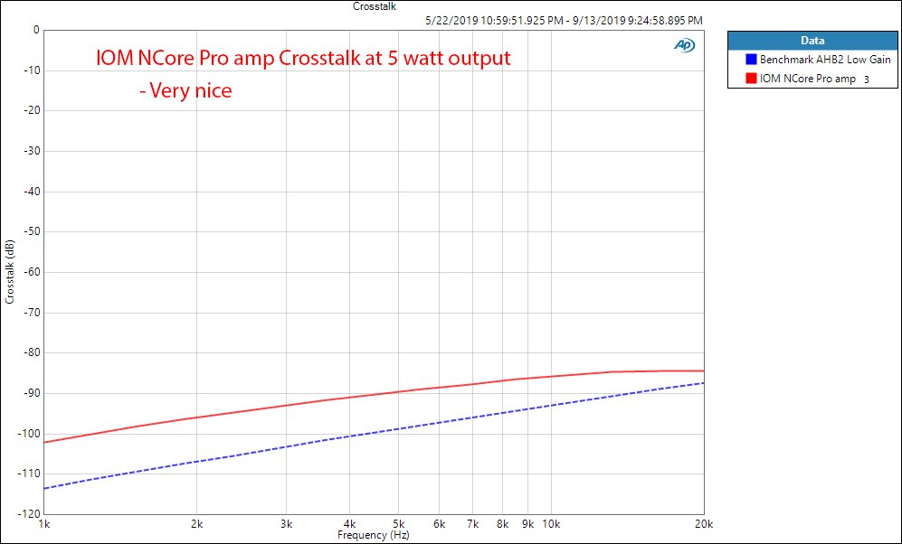

Does anyone have crosstalk numbers for FusionAmps? I just read in a magazine that some headphone amps can have channel separation as low as 30 dB, which is not much. When talking about active speakers where channel separation is between bass driver and a tweeter, it's a lot more important. Yes everyone should use a protection cap, but this is still useful information.
Okay, it's not exactly a Fusionamp, but an NC252MP board, same as the FAs have. Note that the 3-way FAs uses an additional, separated NC100HF board for high frequencies.Does anyone have crosstalk numbers for FusionAmps?
https://www.audiosciencereview.com/...d-measurements-of-iom-ncore-pro-pwr-amp.8979/
