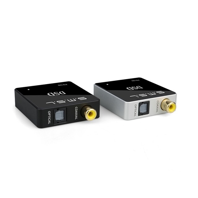

This dac seems to be made for the plate amp if you want usb -> spdif:
SMSL PO100 USB digital interface
I am using a topping 10s now but need a second dac. This looks nice and is cheaper.

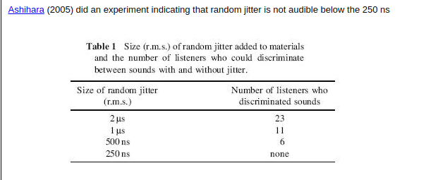

Have you actually measured the jitter of the Fusion? What level of jitter do you think is audible?
The asynchronous sample rate conversion (common in many modern DACs) and reclocking does actually reduce source- and cable-related jitter to the extent that it is mostly non-issue.
No, I have no means to measure this regrettably. I heard you need to go very low in jitter level to not affect audio quality (somewhere between fs and ps level). What exactly causes the audibility of jitter I do not know, but I presume it should not only be taken from a THD perspective. Though I also understand recordings may also have a high instrinsic jitter.

I am curious what your source for that is. It contradicts all I have read and experienced.

Have you verified that objectively, or is it subjective perception?
Don't remember where. At least something is mentioned here:
https://www.thewelltemperedcomputer.com/KB/BitPerfectJitter.htm
There are references to 10-20ns from scientific studies and 50-200ps from John Swenson.
I have only verified it subjectively.
Yes. It also references this study:
OK, so it might or might not have been actual. Anyway, as I wrote, the asynchronous sample rate conversion (common in many modern DACs) and reclocking does actually reduce source- and cable-related jitter to the extent that it is mostly non-issue, so I don't understand your statement that "(assumably) given the asychronous resampling in Fusion amp it is at least very audible there".
