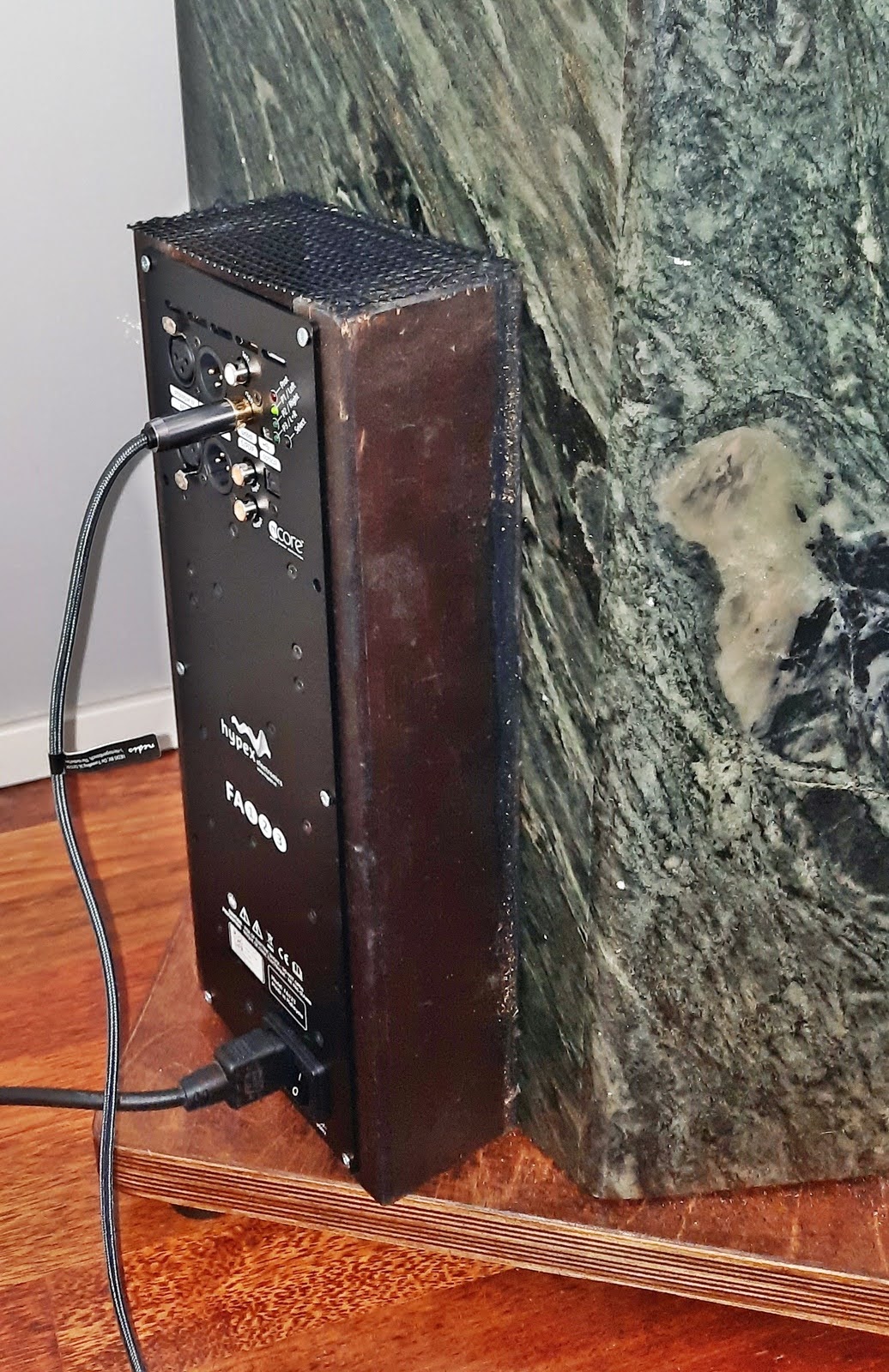

Signal sensing in use here too. Two pairs of FA123, older ones have had power on for 3 years now, no problems.
