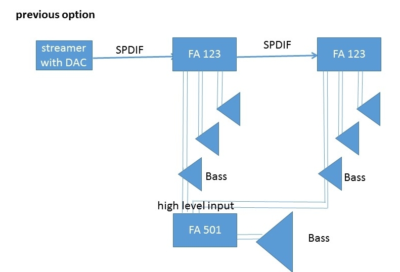

I use chromecast wih a linear supply as a tidal digitaI source. I have a following question: how to connect two fa 123 (feeding two loudspeakers) with one fa 501 (sub)? FA 501 does not have spdif input on the panel.
High level input (fa 501) connected to both FA 123 (amp outuputs devoted to low freq) is the only way ?

I would also consider to use the third speaker out of Fusion for this. You could add a resistor divider network to get output voltage to Line level and then directly connect to analog in of your sub.
If I understand your proposal correctly, I would lose an amp channel to the sub, and only be able to use my fa123 as a 2 way + sub setup, correct? That won't work for me as I want a 3-way + sub setup. Also it seems a bit wasteful dumping a lot of voltage into a resistor, but I get and appreciate the clever workaround
Then I misunderstood what you need. Indeed I thought you wanted two way plus sub. With three way, using analog speaker output for sub makes much less sense, though it is not totally impossible if natural roll off is used of woofer or a passive HPF is used on woofer...

YSDR, upon connection scenario: High level input (fa 501) connected to both FA 123 (amp outputs) devoted to low freq, the latency in fa 501should be considered, do you agree?
Sorry, it's not clear to me! High level input to FA501, then both FA123 connected to the FA501?

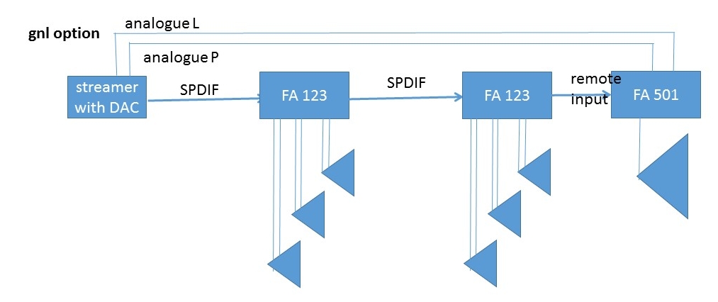

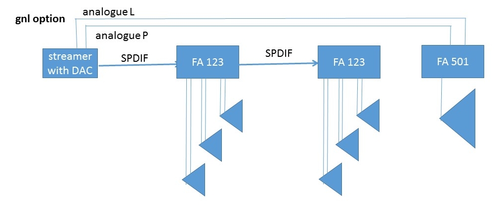

@gothi: Assuming you use one of the FA123's as master, the other FusionAmps as slaves.
What input do you want to use for the FA123's? I think SPDIF
- If SPDIF or Toslink (which as you stated FA501 lacks), why not use a cheap SPDIF/Toslink to Analog converter? You can connect the L and R outputs to the corresponding RCA inputs of the FA501.
- In case you want to use AES, then you can use the SPDIF output of the Master FusionAmp and link that through to the other FusionAmps and the SPDIF to analog converter.
- If Analog then use Y cables to the lowlevel inputs.
Otherwise please give more information about what you hope to realise.

@gnl: thanks for the help, following your advice I see a scheme 1 as a very nice set-up 🙂@gothi: Assuming you use one of the FA123's as master, the other FusionAmps as slaves.

@YSDR: just to explain my previous proposition please see scheme 2

@gothi: you need to pass the S/PDIF signal through from the last FA123 to the FA501 remote input as well, in case you want to use a remote control.
The FA501 can also pass S/PDIF through to a FA123, so the order in this chain is not important.
That is what I also wrote. However the remote input/output receives the remote signal via S/PDIF and also passes S/PDIF through. The S/PDIF audio signal cannot be processed by the FA501 due to the missing circuitry.
Sure, so the corrected scheme is given below. Just in case 🙂
