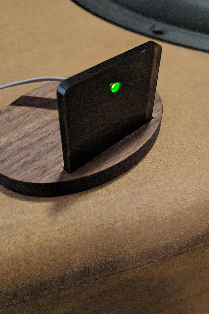

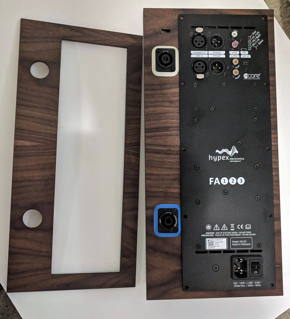

I made some boxes for my fa123's and a little remote sensor holder.
I used a laser cutting service to do the hard work. The top is mdf + walnut. There are two coats of "tried & true" original on them. I like this stuff because it is just wax and oil- the smell won't kill you. The top is glued to the box with loctite "power grab".
The box is a bud industries ac-411.
Side note feature suggestion for hypex:
Hypex, can you override the remote and have it play a keyboard command? It would be neat to have the left and right input select to play a next song command. Even if I had to keep the hypex app open I'd be happy. Since different apps use different commands there would need to be some freedom of what keys it sends.
