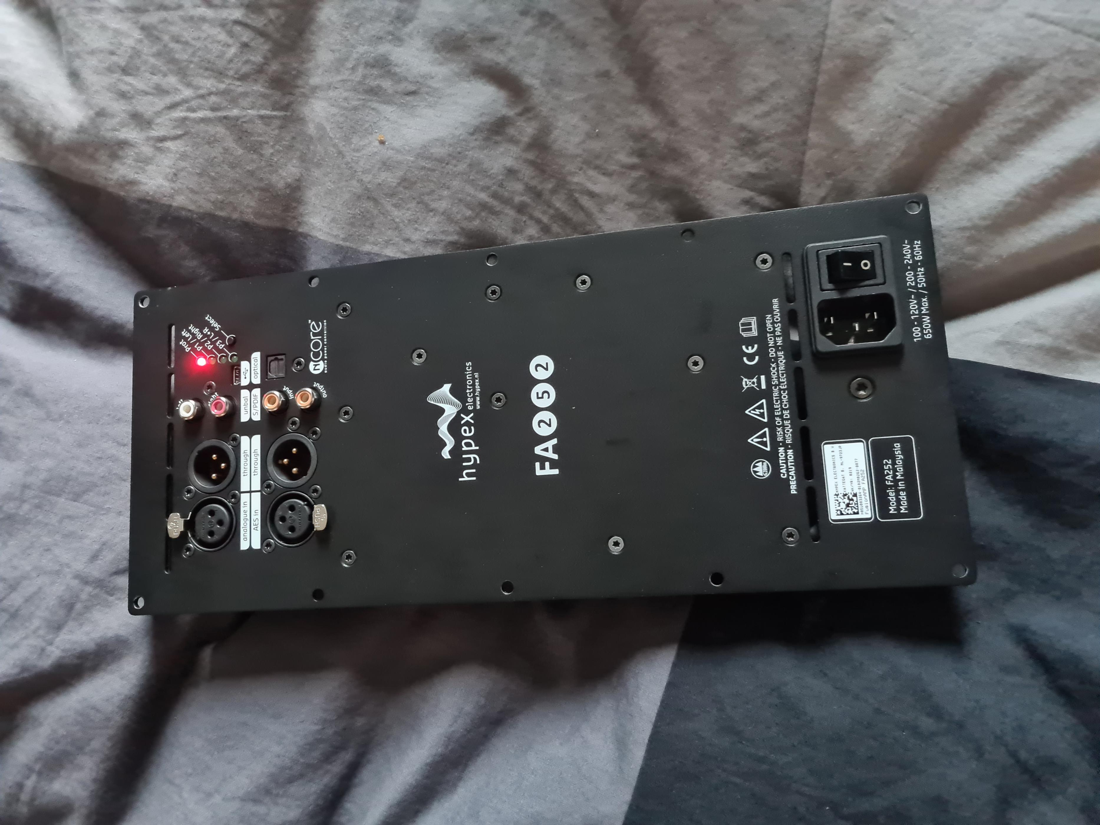

I've got a little problem. One 252 after when i switched of the unit, red led start steady on 20-30 sec. After i restart working well again. Two new 122 doing this same but the difference is when i turn back on still on the red led steady on after i push preset button switched back normal green led and working well. I tried upload the short video but looks like impossible 😀

Got the same problem with two newer units I received. Kinda annoying because the amp doesn't start for a while after turning off.
