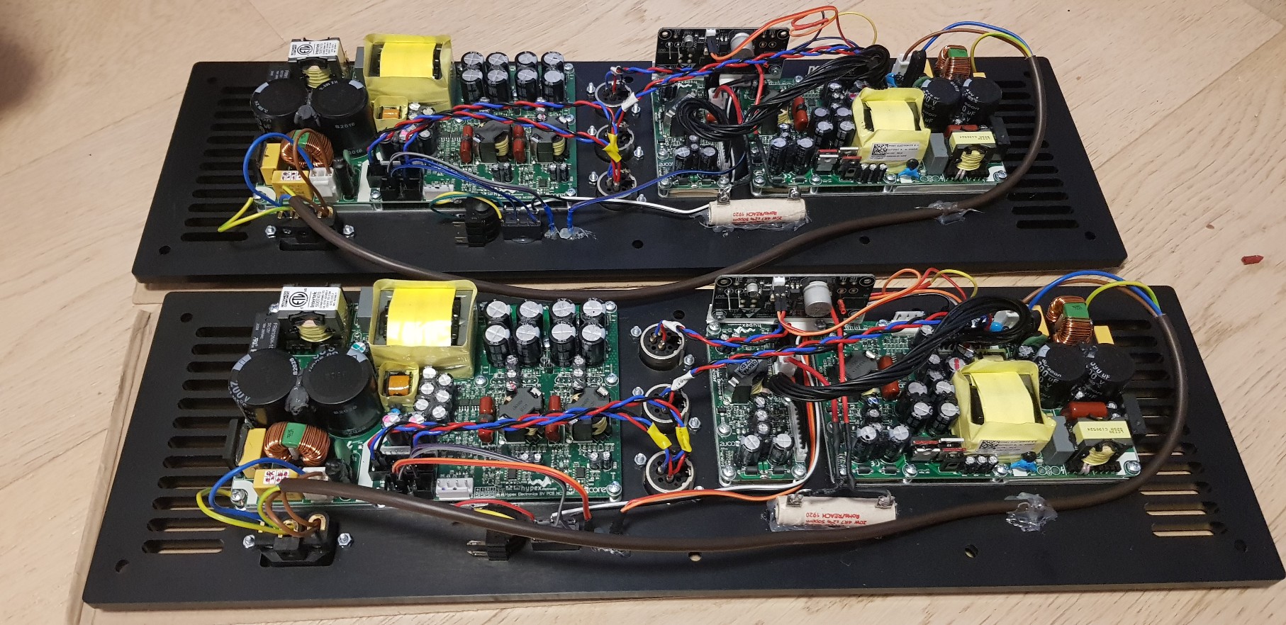

I'm not hard core audiophile but I don't miss my Aleph series amplifiers now that I transfer to NC252MP.
I used to have an active system with diy Aleph's (Aleph mini, Aleph 30, Aleph X) but at one point I realize that I don't have that much time for listening to music,so I don't have that extra one hour for heat up time.
I can't say that hypex NCXXXMP sound better or not (vs Aleph's) as I didn't make direct comparation.
I like the sound of NC252MP which for me is neutral, and nothing is in the face, there is nothing wrong with the picture.
It have great control for my type of music ( but I like electronic music, my favorite artist are aphex twin and squarepusher, but I like radiohead, even like billie eilish 😀 for it simplicity, I listen jazz too....so I'm open minded about music, but I like good sound ).
My speakers have Satori BE tweeter, MW16P and peerless XLS sub, amplifiers are NC100HF+NC250MP+NC252MP and analog precision DSP as digital crossover.
Now, this setup sounds really good.Very neutral, and people (audiophiles) who hear it say that it sound great.
Now the only thing you mide say that vocals miss a little warm in the sound...but only little.This mide be because of drivers, not just amplifiers.
I think that you can balance that if you use tube based preamplifier.
But I like them just as thay are and I have no need for anything else...maybe NC400 but...😀
Any way, I'm happy with my setup with NCXXXMP.

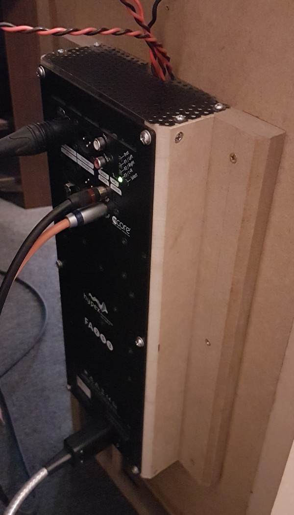

I'm looking for an enclosure for the FA122 (smallest of the series basically).
I'm planning to attach the enclosure to my speaker, so the lighter (weight) and stiffer the better.
