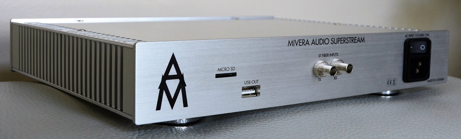

Just like my Superstream streamer now, I will have ST fiber Ethernet inputs on my system. With fiber, it completely isolates any possible noise or interference from getting into the system. Also no chance of ground loops. Very cheap as well.

I see. Thanks.
For my intended use this would mean having an AES/IP MUX on the front end (e.g. mixing console)?
What's your intended use? All that needs to be done to make one of these plates fiber compatible is use a fiber PHY instead of copper on the inputs. But not sure if Hypex does decide to end up putting AES67 into the plate if they would go that far. For me having heard the difference it makes in sound it's a no brainer. I also like that you can run up to 9km of cable with no losses. But the biggest bonus is audiophiles don't end up spending more time tweaking the Ethernet cables than listening to music. Because there's absolutely no way the fiber can be improved upon. A $12.53 Corning cable from Monoprice is as good as you can get.
