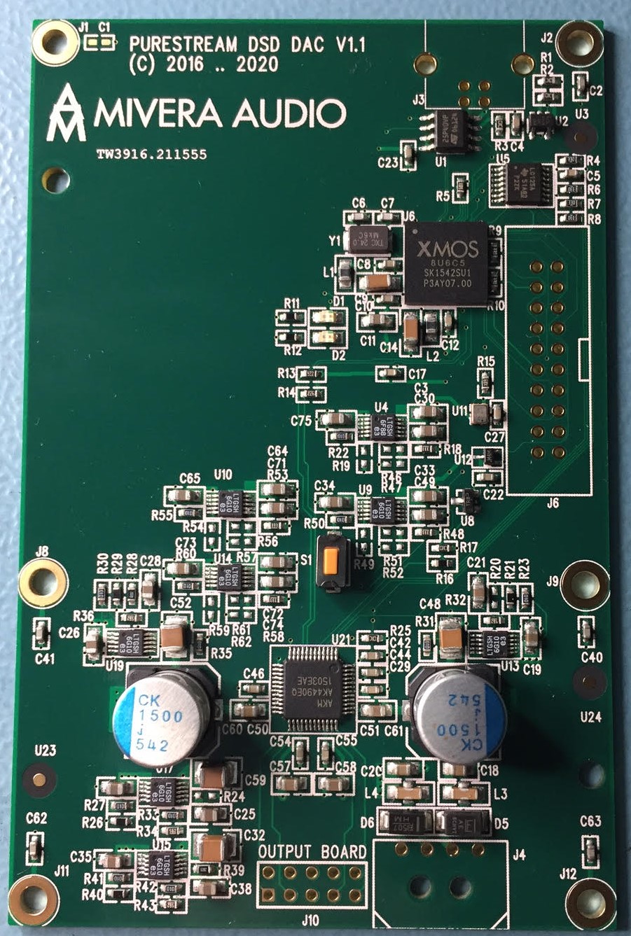

You don't need to parallel them. But when you do the performance is better, and current output capability higher. But they do have the 3045 as well with 500mA.
On my 2 channel Purestream DAC I use 8 of them. 6 to power the AK4490 DAC chip alone, 1 for the clock, and 1 for the Xmos USB interface. Then I use the Belleson SPZ discrete regs as pre-regulators on a separate board.
Belleson Medium Current Regulators
Since the Japanese SMPS I use has a nasty ripple noise of 700uV RMS, it's important to ensure none of that gets into the DAC

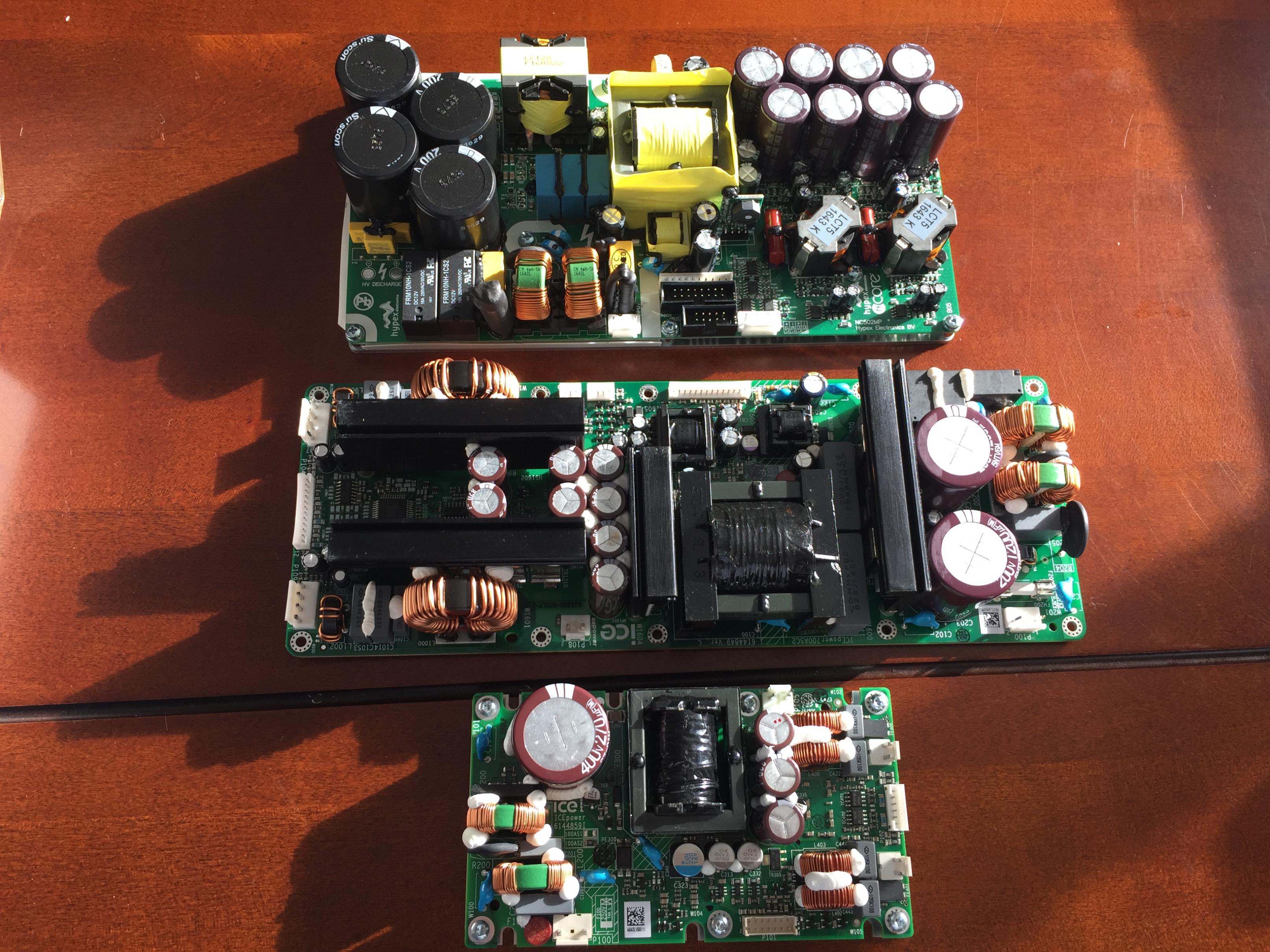

Yes I know that. But still impressed with that TI chip. I did a little shootout here.
I would love details..... particularly as to how they sound vs the nc500
Glad to see you're on the ball. Okay you win.
hehe
Well it only took me 10 seconds to decide I didn't like the 700asc. And it didn't get any better after I listened more. For me it's a subwoofer amp. But when I listened to the 100as, I was very shocked. I was actually hearing music coming from my speakers. I knew something was very different about this amp than all other Icepower's I heard. So that's when I decided to pull off the heatsink and see what the secret weapon was. It's definitely the 2nd best class D I've heard next to Ncore. And it's very close. But I haven't been able to get better sound out of any class d amp than I've gotten out of the NC-500's. But at much higher expense. My last NC-500 build is the best amp I've ever heard. My class A aficionado client who bought it also agrees. He went from a DHT tube preamp with class A amp to passive Autoformer preamp, and NC-500's and for him it's an endgame. He doesn't miss the old rig at all.
