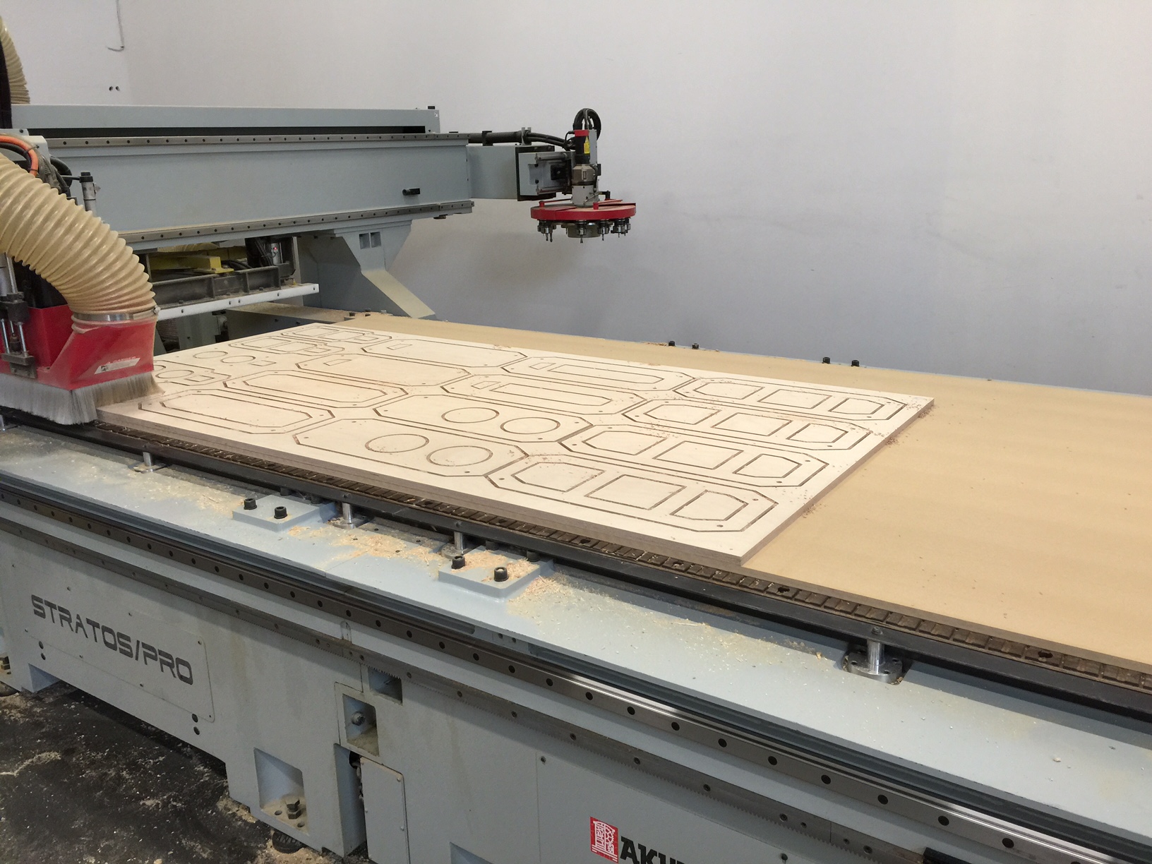

If Hypex adds Ravenna to these plates I'll start that thread. I will design several flat pack speaker kits, and 5-6 different DSP presets for the crossovers. I will contact CNC shops in every continent to mill and distribute the flat pack speaker kit's at very low cost.
Could be exactly what I'm looking for.

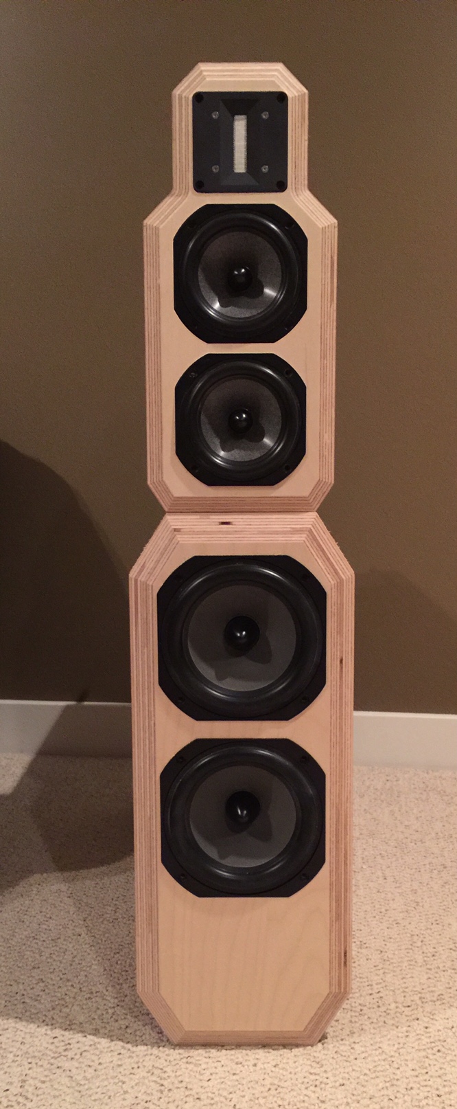

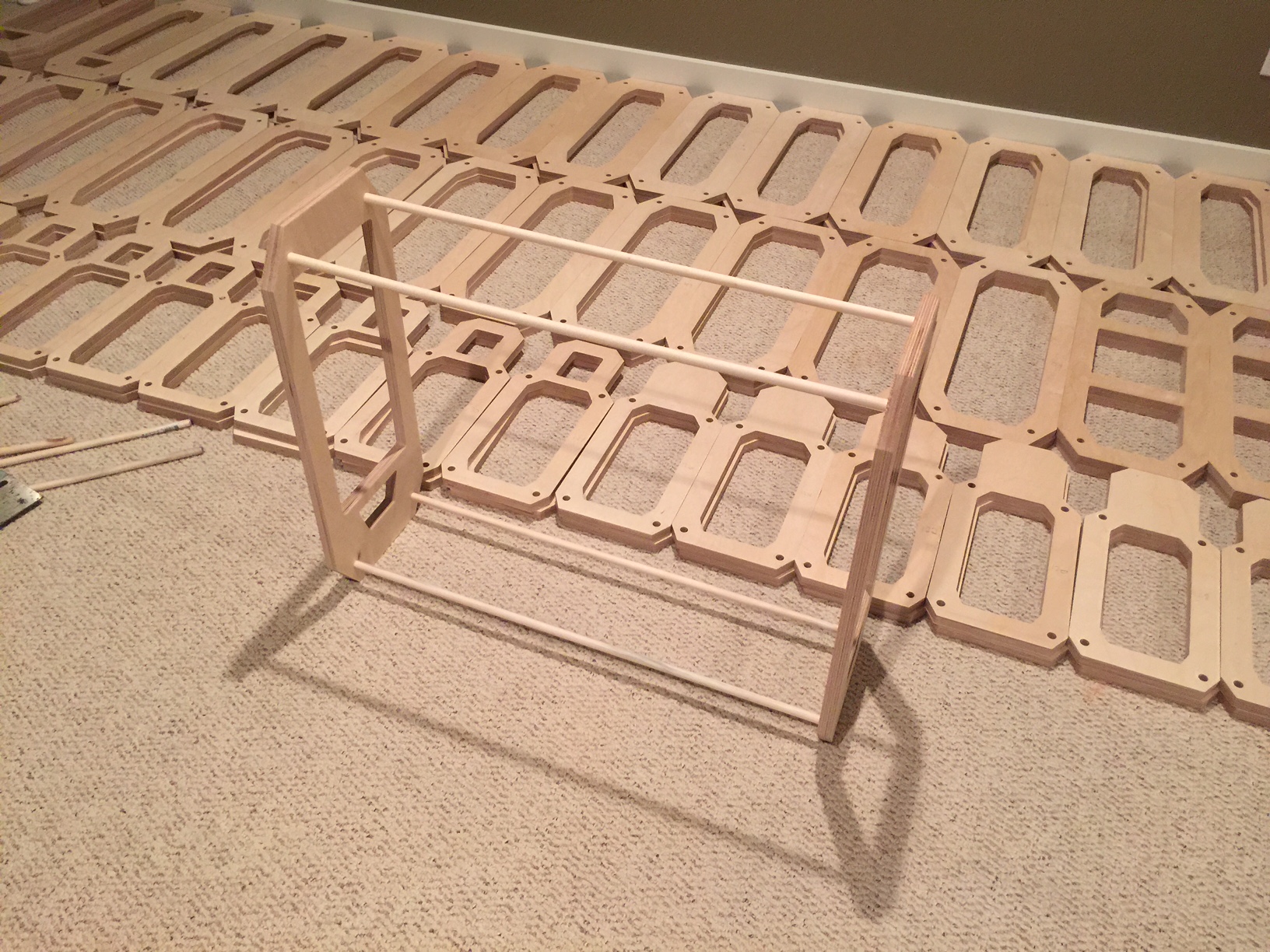

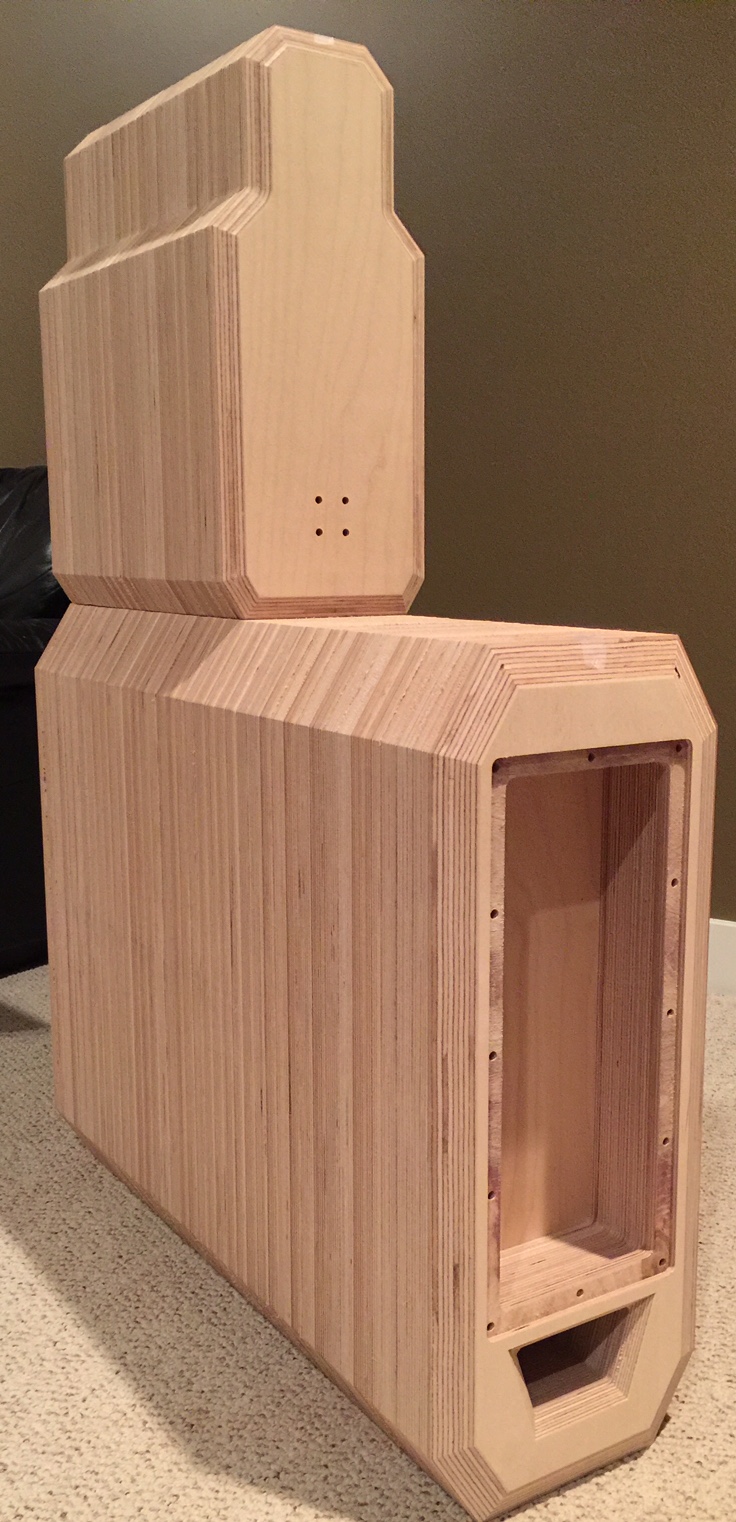

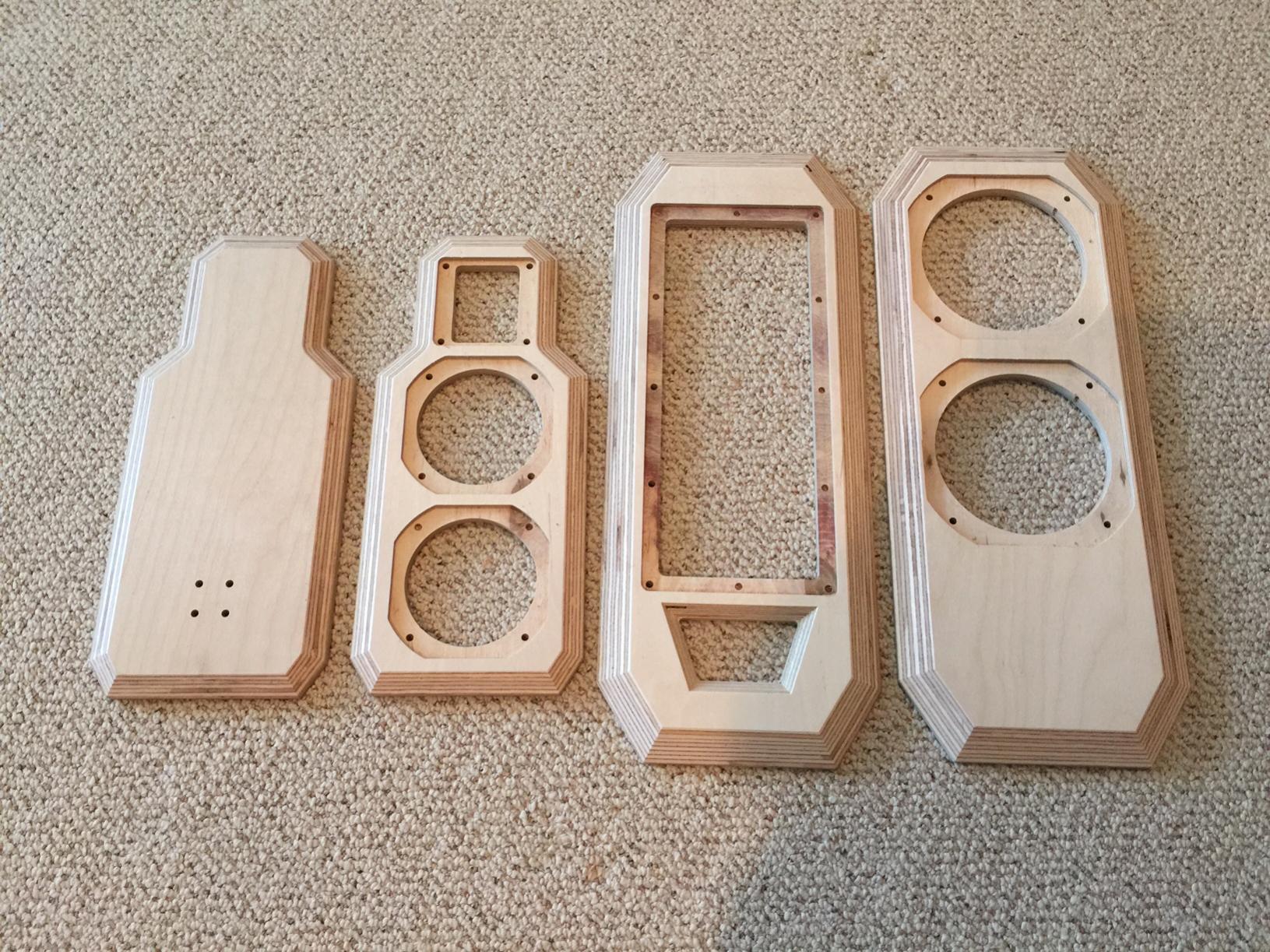

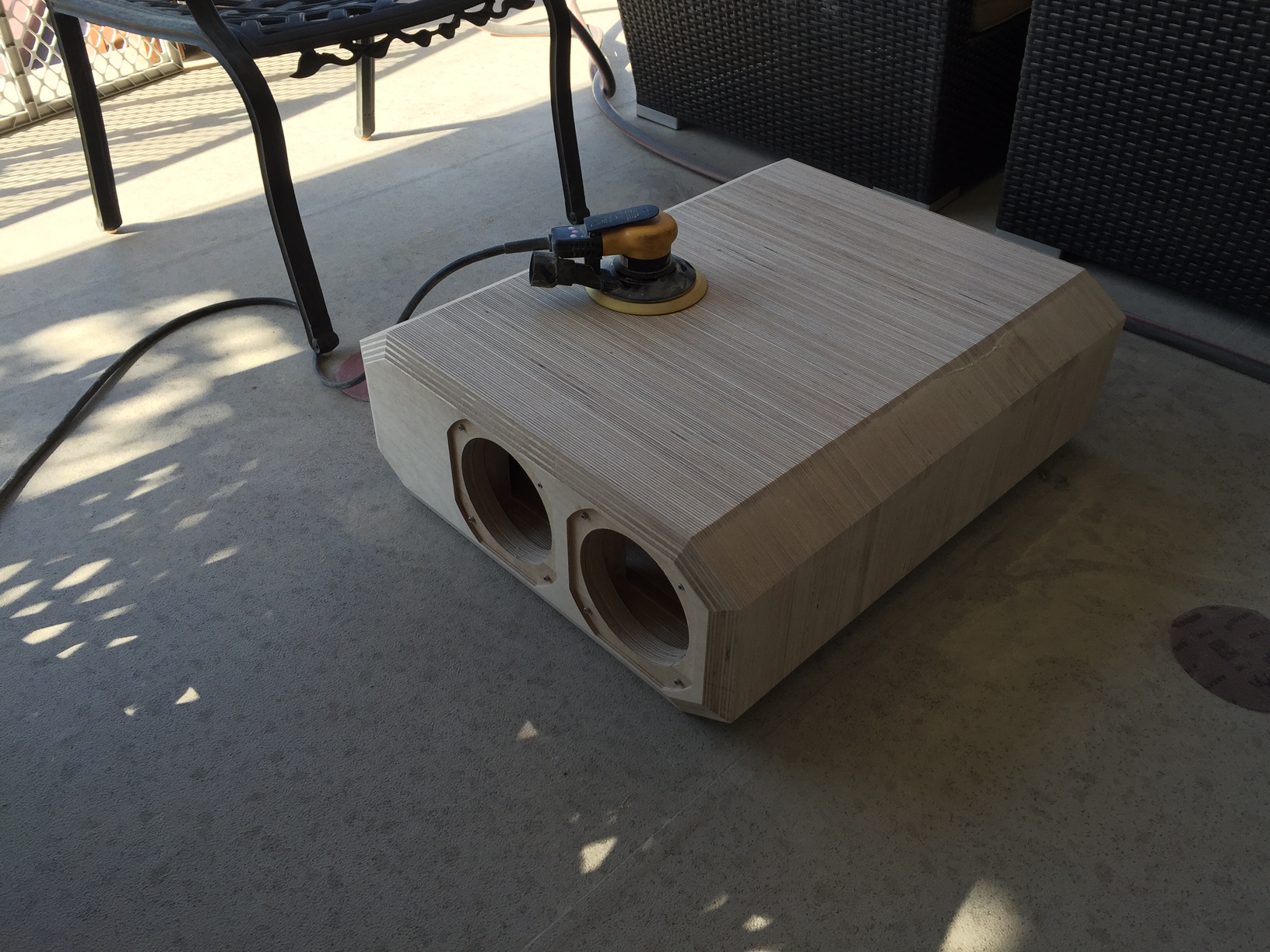

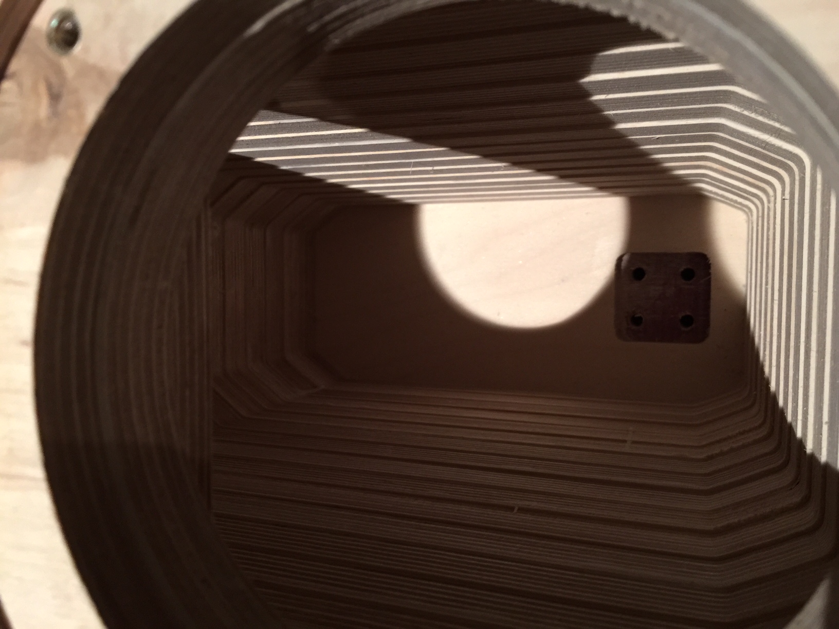

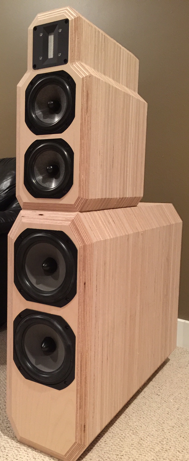

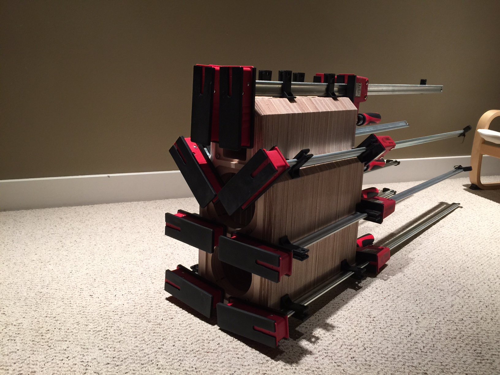

I've actually come up with a cabinet design concept that can simply be bolted together without even any glue. Completely air tight, and rock solid. All 18mm Baltic birch ply. Only tool required to build the cabinets is a hex key. Any good CNC shop could easily mill the panels.
Here's an example of a similar cabinet design. But that one used wooden dowels and glue. My new system uses steel rods and bolts with no glue. I have a cutout on the back of the woofer cabinet for the Hypex 2.400D plates.
