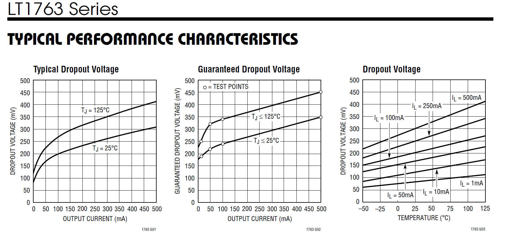

Further to this, if we put two lifePO4mini in series 5v + 3.3v to give 8.3v, which may drop a bit lower. Is 8.3v sufficient, for is 9v the min?Hi Henry,
yes the 3.3V can be connected directly to the 3.3V “output” - no need for input voltage.
the 9.9 volt can be connected to the 9 Volt. If (!) the regulator would get too warm it will switch off automatically. - but it should be fine.
I recommend the 9V plus minus 0.2 as that is easy to adjust with the dddac supply. It is not the “absolute maximum before damage” or something…
please post your experience….
best regards
doede
well, the drop out depends a bit on temperature and current (see datasheet) and 8.3 would be very hard at the limit. 8.4 to 8.5 Volt would be better
Hi Stretchneck,Further to this, if we put two lifePO4mini in series 5v + 3.3v to give 8.3v, which may drop a bit lower. Is 8.3v sufficient, for is 9v the min?
I do not know if this will work. In the 'big' LifePO4 the batteries can be connected in parallel by installing jumpers, but afaik they are charged individually. Better ask Ian Canada about paralleling individual LifPO4Mini outputs. He responds to emails promptly.
