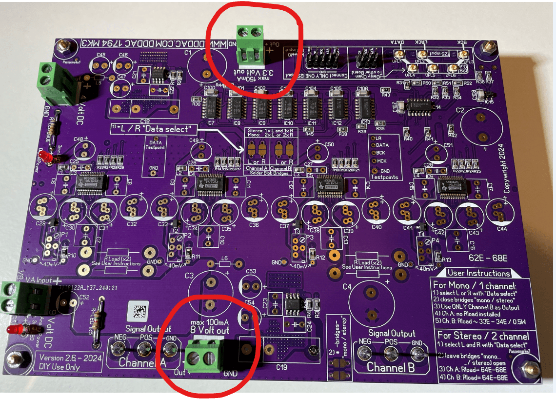

Just an interesting fact. You can use the Output connectors with the regulated voltage on the DAC board as an input for an alternative power supply (only valid reason I see is to just test and experiment a bit with alternate PSU or ultracaps for example...) The on board LT1763 is actually designed to use in this way too. If the regulator is used with battery backup for example, it acts like a diode and resistor of several 100k.
Datasheet says:
The devices are protected against both reverse input and reverse output voltages.
In battery backup applications where the output can be held up by a backup battery when the input is pulled to
ground, the LT1763 acts like it has a diode in series with its output and prevents reverse current flow.
So in short, if there is no power at the input, you can add an external power to the “output” terminal of the board (3,3V and 8V of course)
In case of the DDDAC MK3 board, it is VERY important to have powered the digital side BEFORE you add power to the analog side!!
Without digital 3,3V the analog side of the PCM1794 consumes more power and gets very hot. Not sure if it will go defect, but better not try…
Oh! Can you explain what's going on here?In case of the DDDAC MK3 board, it is VERY important to have powered the digital side BEFORE you add power to the analog side!!
Good question, I do not know why the PCM1794 is doing this, I only know that attaching only the analog side with no digital power, current draw goes up and hence the chip is getting pretty warm. On the DDDAC board itself there is a safety measure that the 8Volt regulator does NOT start, when there is no 3,3 Volt present. So no worries for the normal setup 🙂
Back to the situation where anyone would like to try another power supply, make sure both 3.3 and 8.0 volt are present at the same time. If the 8Volt is present a couple of seconds before the 3.3 V there is no issue. They just need to be there at (roughly) the same time.

ok checked.....
with 3.3 V present: normal analog current Ia = ~ 200mA (one MK3 DAC Board with 4x PCM1794) - regardless, if Va is 5 or 8 Volt.
but....
without 3.3 V present and powering from External power at the output terminals (see above...)
Va = 5V => Ia = 200mA
Va = 6V => Ia = 300mA
Va = 7V => Ia = 400mA
Va = 8V => Ia = 500mA
Not sure what this tells us, but one thing at least, if you power the analog side externally with anything above 5V, make sure 3.3 V is present as well at the digital side
Again (!) If you power the board through the normal input terminals, this cannot happen, as the Va only starts when 3.3V is present .... That is the way I designed it.
This whole story is just for those who want to experiment and know what they are doing 🙂

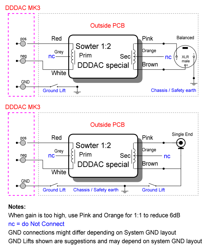

What's going on with these Ground Lift switches?
I'd say the RCA outer ring always needs to be connected to GND. Also, I guess GND should always be connected to chassis / safety earth, possibly through a ground loop breaker.
