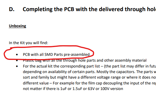

You are right! SMD is quite difficult without the right tools and experience (I know from building the prototypes 😕), hence now the professional company pre-assembled boards. 🙂
Agree, the docs should be explicit to say that all SMD parts are already soldered to the board, which makes things easier for DIY.
