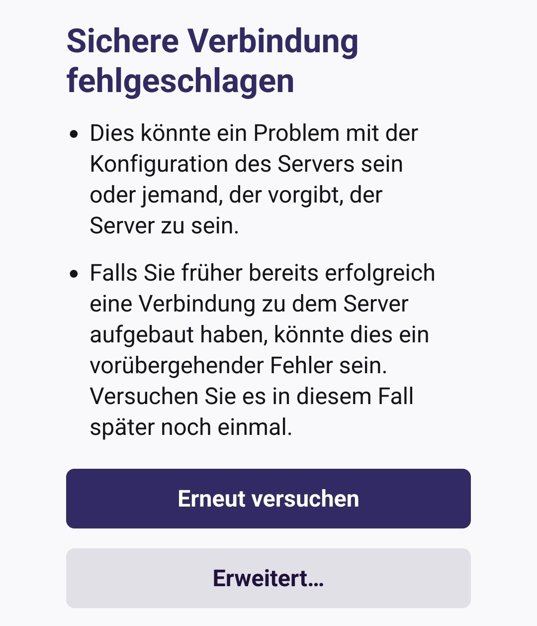

@dddac The link to your blog throws an error (attached).

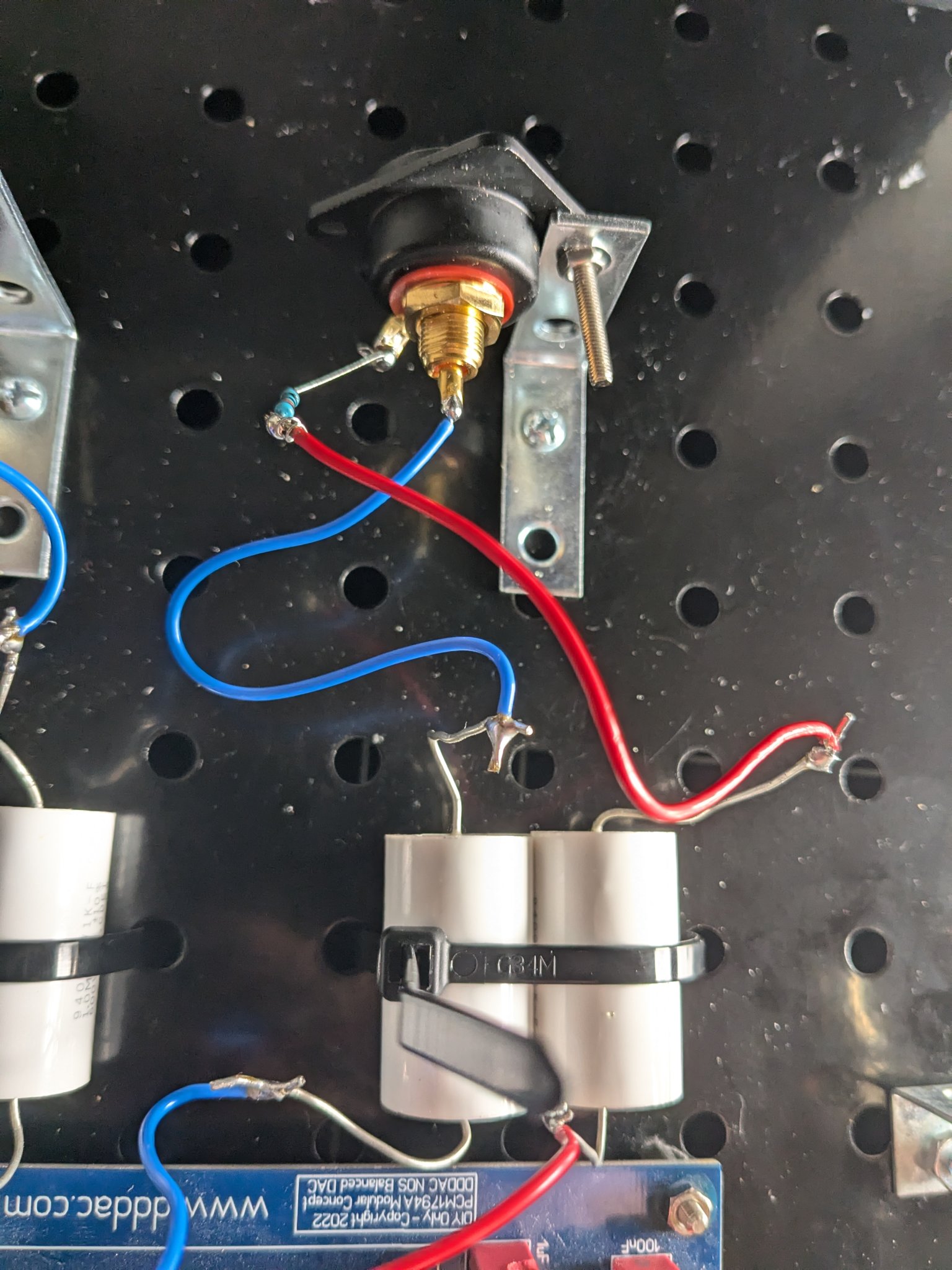

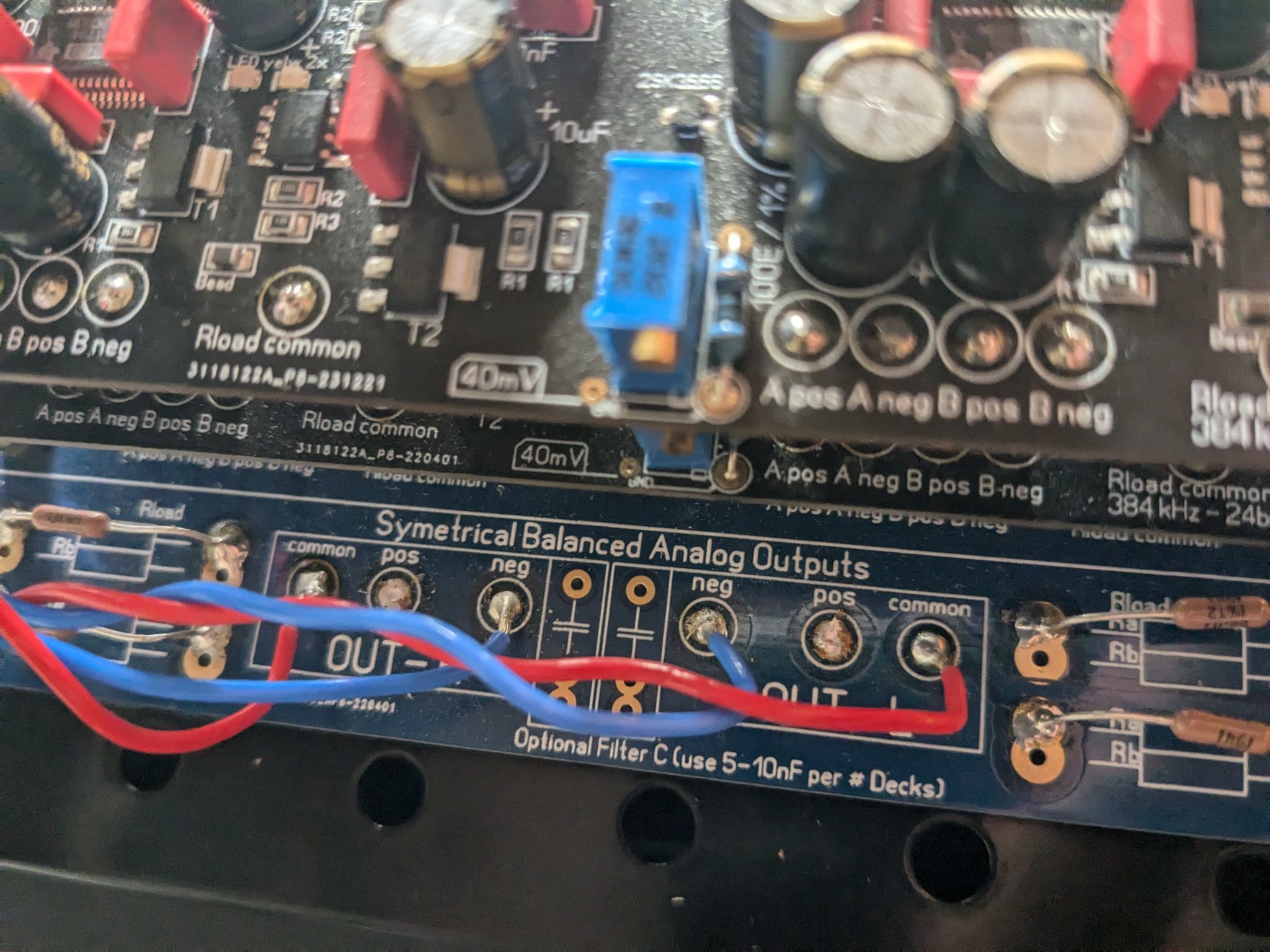

Hi there, I recently purchased some of the newest main board and two dac boards from a member pre built. They were originally wired for XLR and I'm trying to convert them to RCA but I'm a bit confused. I need a 100k bleeder resistor after the capacitor to the RCA ground, correct?
Also do I just connect one capacitor to either positive or negative on the output (same for both channels) and then one capacitor to the ground on the output on the main board?
