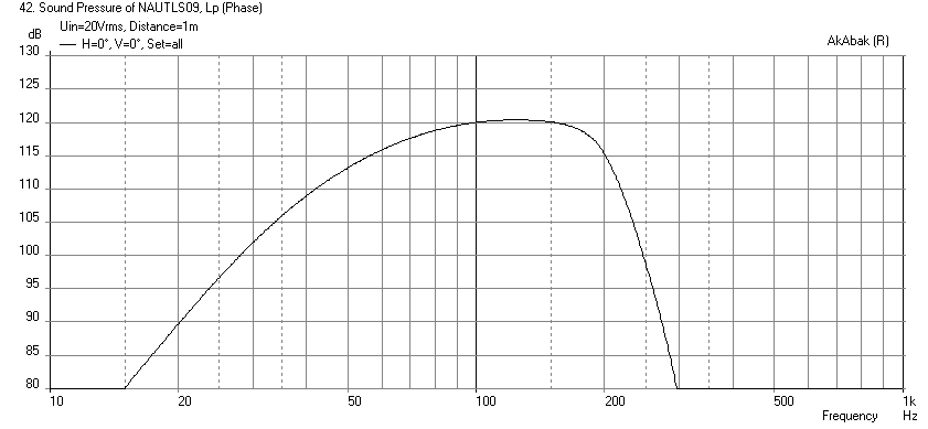

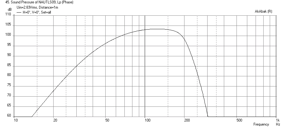

Eight Driver Nautaloss Sub with MCM 55-2970 and PE 299-609
I was curious to see what you can do if you super size this sub a little. Given that the drivers are so cheap at $6 ea x 8 is still under $50 or about what you would pay for a regular name brand 6.5 in driver like Peerless. If you put 8 drivers in a push-pull array (now at 4 ohms nominal) with a double-width Nautaloss cabinet (~13 in wide). Here is what you can get in terms of SPL and impulse response. I will have to go with what the manufacturer T/S parameters are given that they look like they were credibly measured with a plot and all.
http://www.mcmelectronics.com/content/ProductData/Spec%20Sheets/55-2970.pdf

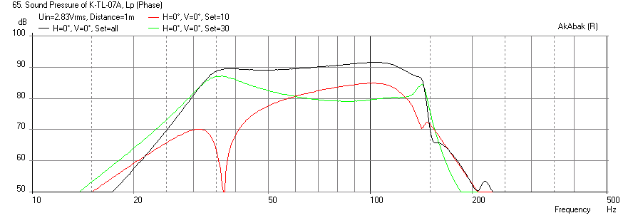

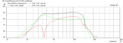

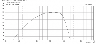

It is a pretty efficient setup when used with corner loading - 96 dB at 50 Hz and 103 dB at 120 Hz with 2.83 volts drive:
The xmax is stated as 3.5 mm, I am going to push the xmax by 1 mm (I have done this before with no harm done - and this will be the peak transient with normal operation at typically -20 dB below this) and we end up with a 20 volt rms max drive voltage for 100 watts total power (into 4 ohms nominal). Here is max SPL vs Frequency with 35 Hz high pass and 200 Hz low pass filters applied:

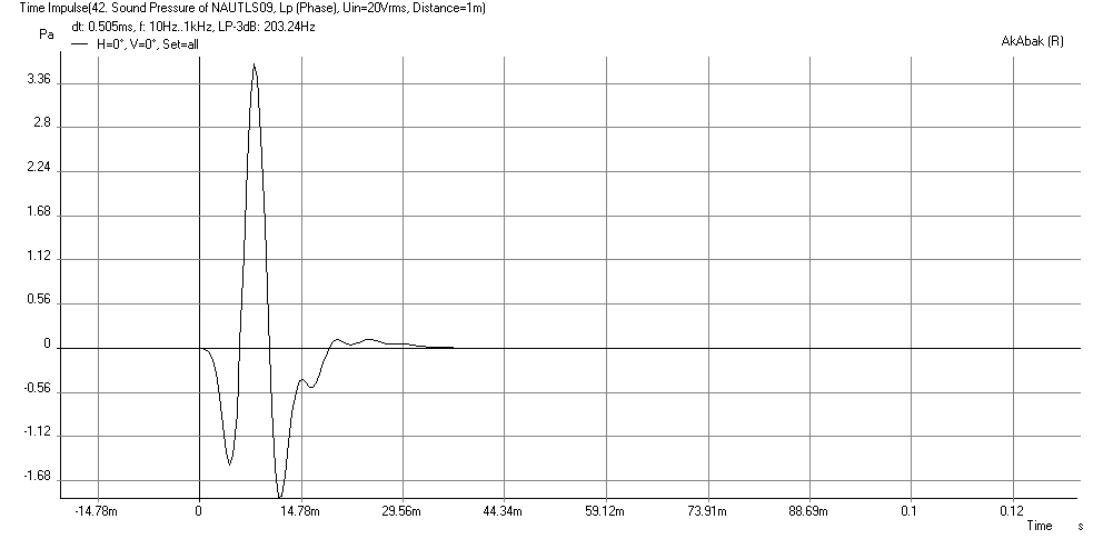

Here is the Impulse response if I switch the driver polarity (don't quite understand this one yet - as it introduces an 8 ms delay now but the spike is in the correct positive sense) and very clean:
So I think for $50 in drivers you can make a 120 dB capable sub that reaches about 65 Hz before EQ'ing with clean dynamics.
You will need a DSP processor to delay the HF mains by 8 ms to time-align this though.

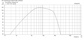

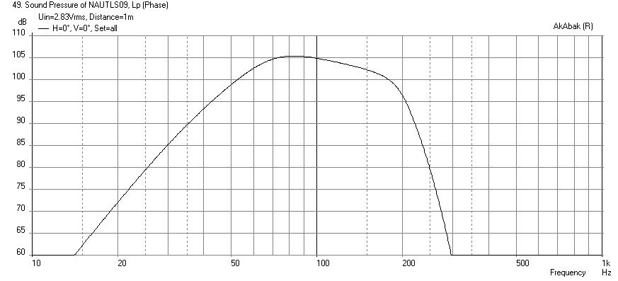

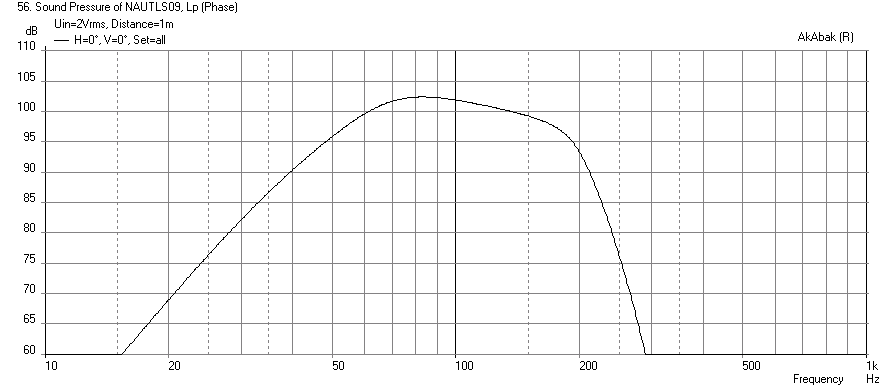

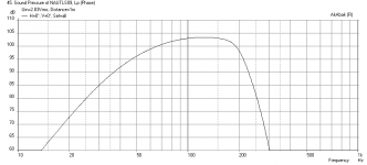

Well, I had to ask what happens with an 8 driver sub using the PE drivers? I think it has a deeper bass punch ( 99 dB at 50 Hz) due to the higher Qts:
To compare though, I have to set the driver voltage at 2 volts as the above sim is for a 2 ohm nominal load and I did not want to re-wire it for 4 ohms. The efficiencies end up being about the same at 96 dB at 50 hz. However, if you have a sub amp capable of 2 ohm drive (such as a TPA3116D2 class D set up for parallel bridge tied load (PBTL) at 100 watts and 2 ohms - this would be perfect.)
