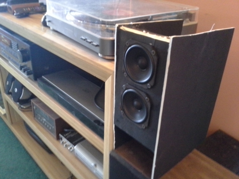

Yes I see it now.
It looks hollow at the bottom, how low does the spiral coil go on your box? Kind of surreal to see my speaker in someone else's stereo shelf. 🙂
I think the spiral did not have quite the right shape. I made it freehand without drawing it, during a slow night at work between looking at work. (aerospace, which is why I'm a bit ashamed of that speaker's appearance. Would not pass muster here.) It sounds OK though.
What is the profile of that spiral supposed to be?
Log, involute, Archimedean, Euler, Hyperbolic, Lituus, Spiral of Theodorus, Golden, Fibonacci, or does it matter much? The spiral I made most closely resembles the last.

Ok, here is a sketch of the Nautaloss II plan. It is drawn to scale (each grid = 0.5 inch), but I would not be too worried if you are off a bit on the internal spiral dimensions as the point of the spiral is to absorb the back waves. If this was a horn with an open mouth then the dimensions would be more critical. The internal width is 5.0 inches. Be sure to add bracing every 90 deg at least for the first 1.75 revolutions from the mouth. I am including a photo of the internals again for convenience. Note that my spirals aren't that exact either.

A sub brings up another question, what are you using for X-over and DSP for room equalization. How are you measuring the speakers?
At first I ran both full range and it sounded pretty good - it even measured pretty decently. Now I am using miniDSP 2x4 with advanced 2-way plugin for XO, EQ, & Delay. I use a Dayton UMM-6 microphone and the REW v5.1 (beta) software for measurement and EQ curve generation. I am bi-amping with a Yamaha RX360 (45 w/ch) amp for subs and a home built TPA3116D2 class D amp for the tops (40 w/ch). I am looking to get a couple of the prebuilt TPA3116's and put them in the same case as the miniDSP for a clean integrated look.
