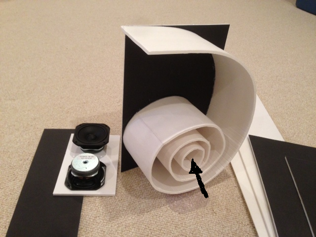

Anyway, i believe that the 1st - and easiest - test should be the reversing of the spiral; it could be also interesting to tilt drivers a bit...
I think I understand (dangerous sport!):
The driver goes at the 'Thinnest' end of the spiral - where my arrow points. Thickest end is Closed, where drivers Were placed - maybe make aperiodic (sp)) 'venting'.
Damping material gets Denser towards the thick end.

Why would one want to have an expanding closed ended TL? It seems that the reflections will not be absorbed as effectively. Easy enough to model in Akabak...
if you do put a small vent there, then it becomes a coiled MLTL. There will be deeper bass but it is now reactive in acoustic impedance and a totally different animal.

I will have to draw a sketch of the spiral on the Nautaloss II. It is not critical but start with a 13 in x 9 in rectangle that slants back to 12 in tall. Make the mouth tall enough to fit 2 drivers (about 9 in) and hand draw a spiral coil such that it slowly tapers to a point. Use string to measure the length of the coil path and set it at 36 inches. The excess length I convert to a round central sealed chamber. Double up the front baffle and use the high quality thick paper faced stuff on the baffle if you can. Glue the spirals starting inside coil and out. Add bracing as shown in photos - any span more than 3 in needs to be braced. Probably doesn't matter but I put curved edges on bracing to avoid hard sharp straight lines to reduce resonance peaks from reflections.

Built the bottom half of a Nautaloss twin. Will put on the other side, speakers and wires tomorrow. A couple of observations of my build:
1.> this particular build was messy, and not what I want. I'll make another later.
2.> The smallest central part of the spiral is the most difficult one to glue down, the foam core tends to unbend at that point. On my next build, I'll use a needle and thread to hold the spiral tight, at the center.
For the central part, I sometimes made a 4 sided tube as the initial core to start gluing the spiral. I should mention it is important to precurve the spiral by scoring it with lots of lines (1 mm apart at tight central curve) and then lay it on soft carpet and take a round object like a PVC pipe and press the pipe back and forth on the strip to precurl it. It should be so well precurved that there is little stress when gluing it. Glue 2 inches at a time when starting. Let hot melt harden before going on to next section. It does take some practice. Don't worry about it being perfect as the spiral is not visible and just serves as absorber - and not a horn throat in an open horn/TL where it would be critical to get this dimension right.

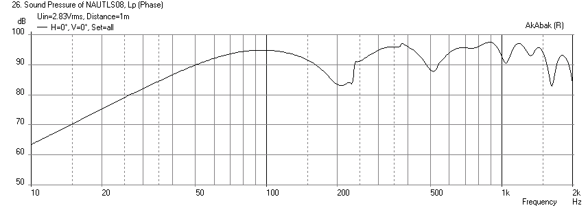

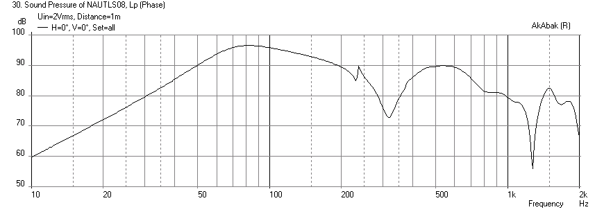

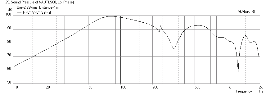

Sim of Nautaloss Sub with PE driver vs MCM 55-2970
The Parts Express part 299-609 Buyout 6.5 in polycone driver works quite well for the Nautaloss subwoofer in a corner-mounted configuration (12 in from walls aimed into corner) with a peak SPL of about 99 dB at 80 Hz (2.83 volts at 1 m) in a quad driver push-pull config. This explains how I was able to get 110 dB quite easily at a moderate setting on the amp. The sub needs equalization via DSP to produce a flat profile down to 42 Hz though. Given that this driver is out of stock and I am not sure when it will be in again, I am looking at a similarly priced 6.5 in driver from MCM.
Here is the MCM 55-2970 driver:
Here is the predicted SPL vs Freq for the PE 299-609 (4 ohms nominal load, sims include effect of room wall/floor reflections for corner loading):
Here is the predicted SPL vs Freq for the MCM 55-2970 (8 ohms nominal load) - the MCM has a smoother profile due to its lower Qts motor and works quite well:
Here is the PE driver at reduced 2 volt drive equivalent to same power as 2.83 volts into 8 ohms:
Now the SPL levels compare very well between the two and the MCM may sound smoother. You will just need an amp that can drive higher voltages if you use the MCM driver as it is 8 ohms.
So this looks like a very good substitute driver and I recommend trying it out - it may actually sound better.
