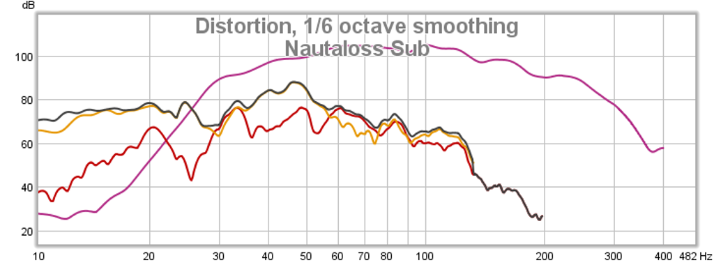

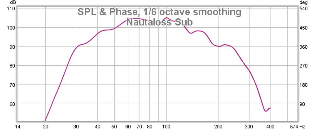

I finally got a minDSP 2x4 and setup a XO to run the sub. I set it up for -48dB/oct high pass at 35 Hz and 200 Hz low pass. I also was able to set the delay between the sub and tops - the sound is a lot more coherent now. The illusion of the 40 Hz bass coming from the tops high passed at 150 Hz is pretty cool. This is measured with mic 1 meter away with the sub corner loaded.

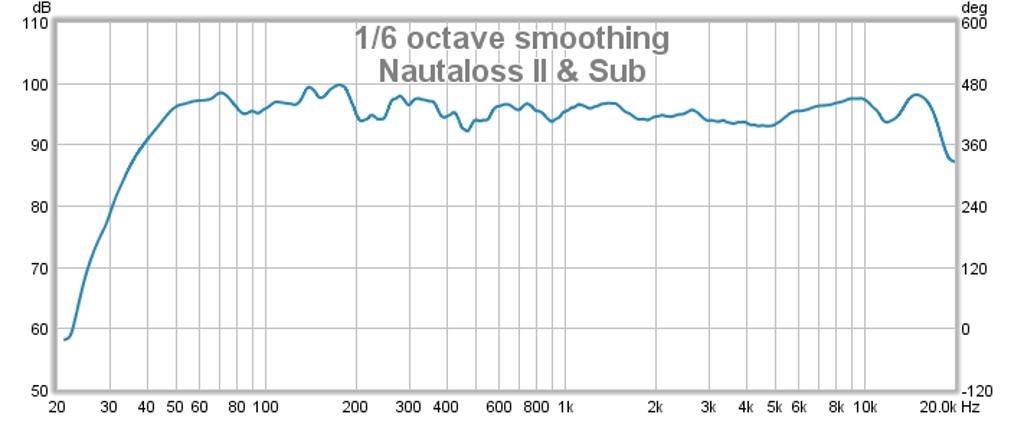

Final In-Room Response with Nautaloss II & Subs - Reference Quality!

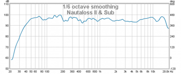

I used the miniDSP to adjust the EQ to smooth the in-room response at the listening position (ear height at seated position) near the middle of the room. I also had a couple of the 47 in tall MLTL's that I built using the same 6.5 in polycone drivers as the Nautaloss sub employed as subs. I aimed them into the left corner of the room while the Nautaloss sub is aimed at the right corner of the room. The amp volume was set at typical listening level (11 o'clock) but the test is performed with the volume from the source at -8 dB (full scale) and here is what I came up with. Recall that the amp for subs was Yamaha RX360 class A/B, amp for tops is home-built TPA3116D2.
SPL vs Freq shows that at an average SPL of 96 dB (about 9 dB louder than how I actually listen to music), the -3 dB response range is 42 Hz to 18 kHz.:

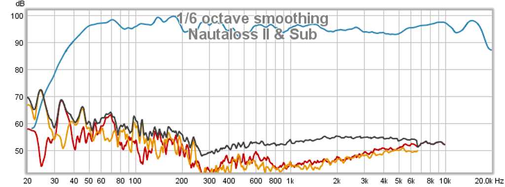

Distortion vs Freq is excellent now showing between -30 dB to -40 dB from 40 Hz on up. Note that at actual listening levels of 87 dB, the THD will be even less and will match the -50 dB figure I previously obtained:

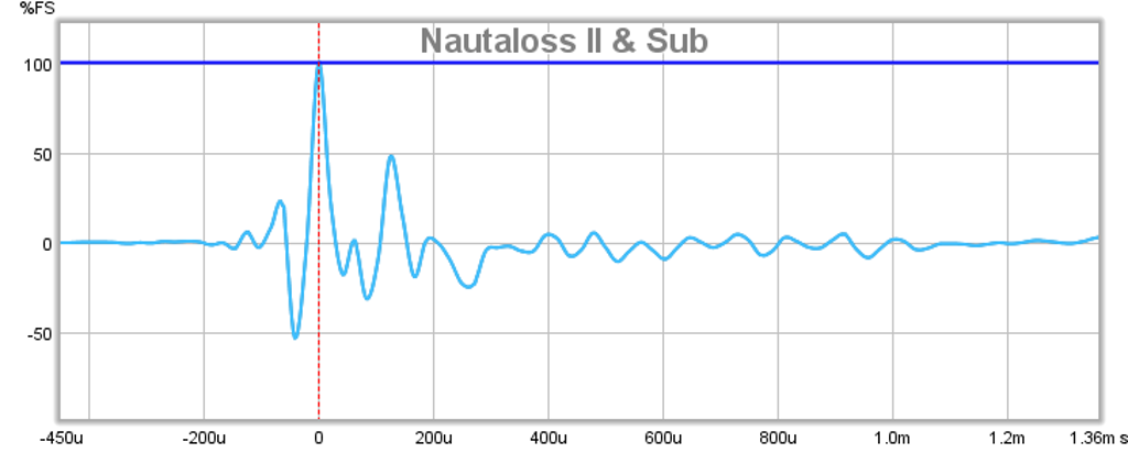

Impulse Response shows a pretty tight response with a single ring that subsides after 200 microseconds:
