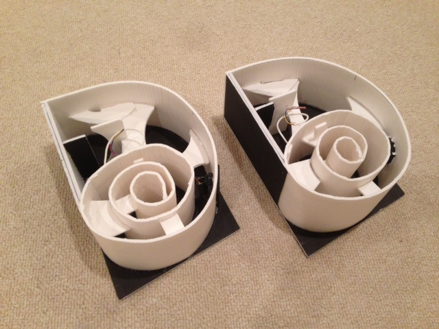

Any photos of the Nautaloss I showing the internal bracing? (unstuffed). Or is it just the three braces?
It is basically same on the II. Look at post 84. On the I I had a few more braces between the two sides from the mouth down to 90 deg into the spiral. Not needed but can't hurt. I was low on hot melt glue so skipped those.

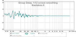

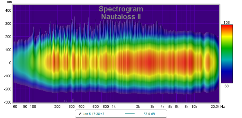

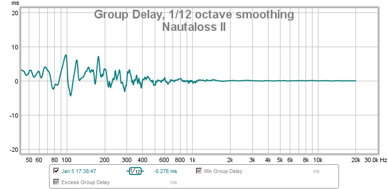

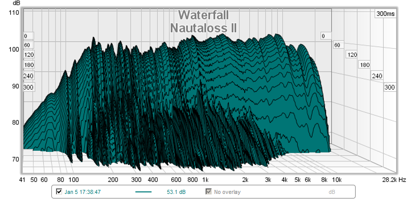

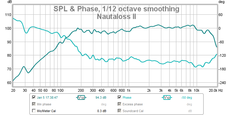

Nautaloss II - Measurements with REW (Including Waterfall)
I discovered the wonderful REW software which performs measurements that include waterfall and spectrograms. In case you have not seen REW, it is cross-platform (PC, OSX, and Linux) as it is written in Java and is available from here for free: REW - Room EQ Wizard Room Acoustics Software
I repeated my measurements with the UMM-6 mic and REW used the calibration file from the manufacturer of the microphone to provide measurements in actual dB SPL.

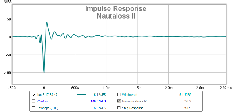

Here are the measurements again at 12 in from speaker with mic 39 in above floor, a home-built Texas Instruments TPA3116D2 amp (powered by 19 volt laptop SMPS), and PC is now a small HP Mini 110 netbook (which has a better sound card with less distortion than my previous laptop).
Frequency Response and Phase:

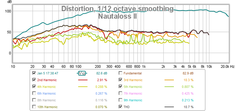

Harmonic Distortion:
Impulse Response (signal needs to be inverted next time...):
Group Delay:

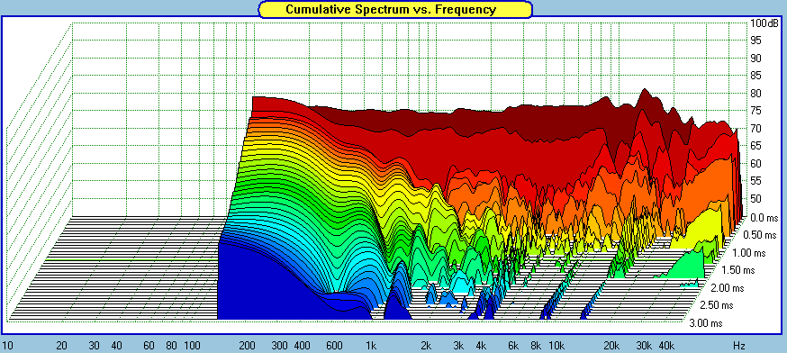

Waterfall (The initial 'mountain range' has a nice 'cliff' looks very nice - even and steep - I wonder if the secondary mid-range lower 'foothills' are due to the FC resonance?):
Spectral Decay (Spectrogram - less lobing the better?):
I am new to the last two plots so am not sure how to interpret them - but my guess is that they are good - excellent, I think. There has been no EQ'ing applied.
Please let me know what you think of the waterfall and spectrogram if you know how to read them and have examples for comparison.

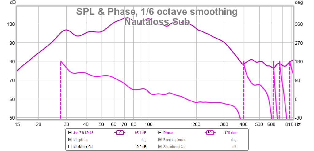

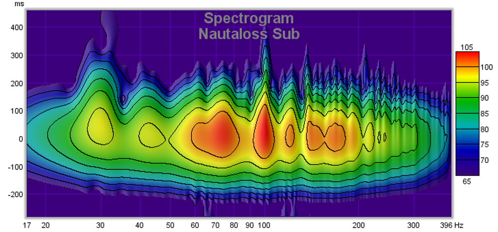

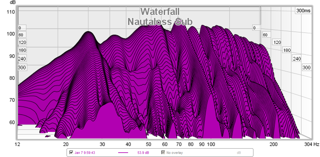

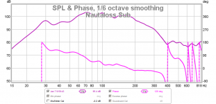

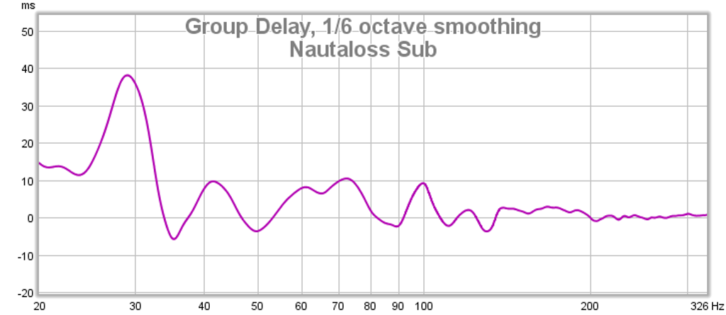

Measurements of Nautaloss Sub, Corner-Loaded
Placing the Nautaloss sub in a corner with some open cell foam seemed to make it perform so much better than a direct radiator speaker that I decided to make some new measurements with the REW software. My two reasons for using the corner loading was that I only had a single sub and needed more SPL efficiency to fill the room, and I wanted to reduce the HF's coming through since I am running full range for now.
The measurements indeed do reveal that the speaker performs substantially better in the bass extension department and a very effective low pass filtering was performed by the reflection off the corner which has open cell foam adjacent to where the drivers are. The most surprising aspect of this arrangement was that even running full range, the corner placement provided a natural acoustic crossover that almost matches exactly what I needed - roll off from 200 hz and above to integrate well with the Nautaloss tops.
The measurements were made with the UMM-6 mic at driver level (about 12 in from the floor) and at a distance of 1 m in reflected path from the driver radiator surfaces. The amp is a Yamaha RX360 45 watt/ch receiver running in mono (single channel) at about 11 o'clock volume dial with tone controls set at max bass and min treble adjustment. This is my usual listening volume setting which produces about 85 dB at the listening position.
SPL vs Frequency - here we can see that the bass extension reaches down into 30 Hz - probably room enhanced for sure, the phase doesn't wrap as it varies almost linearly over 120 deg from 200 Hz down to 50 Hz. The main +/- 3dB bandwidth is 52 Hz to 200 Hz, but there is now the -6 dB reach is at 26 Hz!

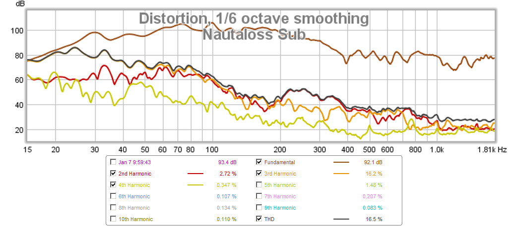

The THD varies from about -50dB at 200 Hz and goes down to -20 dB at 40 Hz, with the worst spot being -11 dB at 33 Hz. In general though, the performance above 40 Hz is satisfactory for such a budget driver that doesn't have shorting rings, or other premium features to reduce THD.

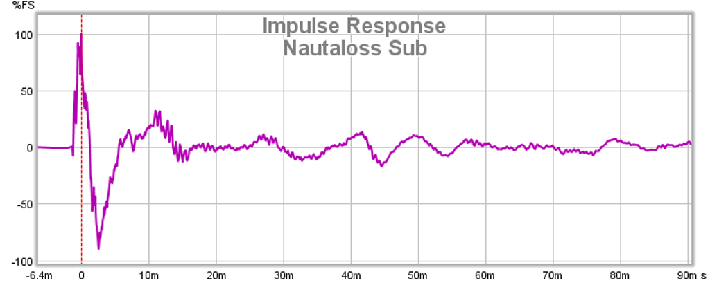

The Impulse Response looks excellent and confirms my subjective assessment that the bass is tight and articulate - notice the main sharp peak followed by a single negative peak with subsequent bounces of much reduced amplitude. I think that this is a major outcome of this speaker design.
The Waterfall plot does show that this speaker is not as clean as the Nautloss II tops. However, I wonder how much of this is simply room mode contributions? Perhaps waterfall plot experts can chime in here with their assessments/opinions?
The Spectrogram reveals the same info as the Waterfall plot but in a color contour format. Obviously there are bumps, lobes, and tendrils all over this mountain range and it is not ideal looking like the loaf of bread that the Nautaloss II was. What can be done to improve this performance? How much of this is foam core cabinet resonance?
Finally, the Group Delay shows reasonable performance (+/- 5 ms) from 200 Hz down to 35 Hz, below which it starts to climb to unacceptable levels.
There it is, the Nautaloss sub woofer fully-measured for your pleasure...
Not so perfect this time so maybe more discussions can ensue 🙂

I got some feedback in multiway forum on how to read and perform spectral decay measurements. I have to get measurements at 4 inches away to keep it at about 3 ms away from speaker to reduce room influence. Decays in 1sec and below are room effects. So my sub measurements above mostly show energy storage and decay in the room environment.
Juhazi tipped me off on this very nice write up of speaker measurement and what a 'good' speakers' measurement looks like here:
Measuring Loudspeakers, Part Two | Stereophile.com
CSD's of a driver should be in single ms range. Time to redo measurements 4 inches away and I will see if I can time gate the measurement.
