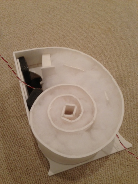

Hi there X: The left picture, prior to attaching the side, shows a spiral and a hole in the middle. Does the hole connect somewhere? Another quick fantastic project from
you-X ....regards, Michael (I posted the wrong ref picture, Sorry, Mike)
Given that this speaker appears to measure very closely to an OB, I would say that the spiral is doing its job of acting like an infinite cavity by absorbing all the back wave without any reflections. It is a fun and easy quick build. Give it a try if you are looking for a cheap but accurate speaker. This will make an excellent top for FAST system. Cheers,
Xrk971
Michael,
Thanks.
The "hole" at the center is just a tube or square structure that I used to center the spiral to give it strength and a starting point. It does not connect to the spiral passage. The spiral is a sealed TL. If it were vented a the middle it would indeed behave very differently - not flat at all in response and more bass extension.

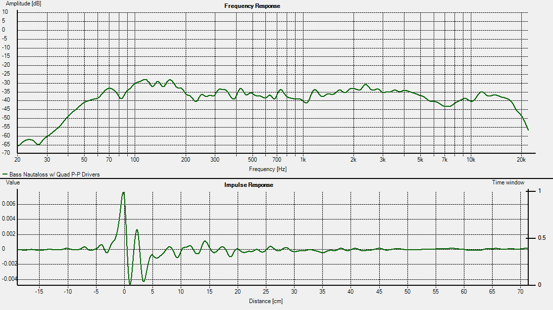

Meas. at Listening Position - no XO
I don't have a XO built yet so this is running full range on both the tops and sub. It ended up integrating kind of nice - very listenable. The room-effects really start to mess with the inherent flatness of the freq response. REW would really help here.

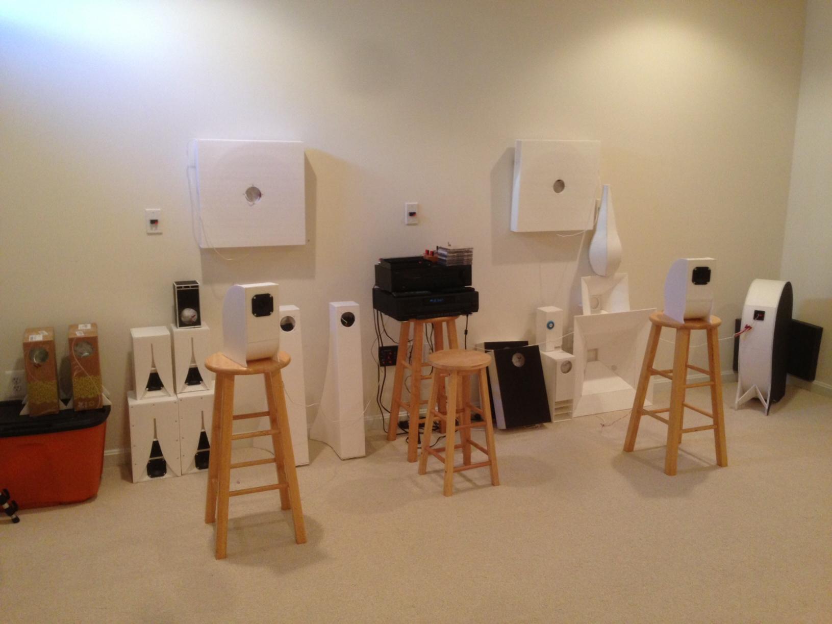

Ok, here is a more complete family photo. Still missing 4 sets as they are currently in use in other places (BIB, micro-BIB, 14 in Cornu, Wall Mount Flat MLTL).
now all that's left is to make a scaled La Scala copy or repro a Clair M4!
I like the LaScala's. What is a Clair M4 ?
