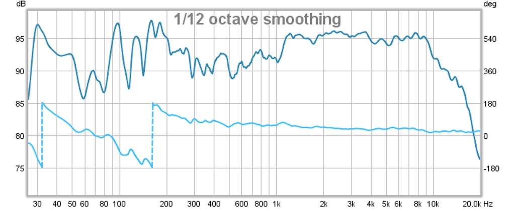

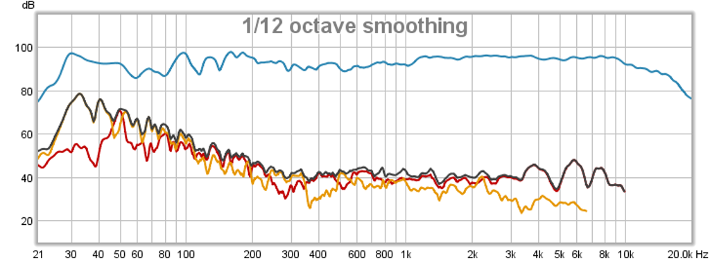

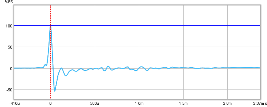

I remember why I like full range
I was playing with EQ'ing the Nautaloss to achieve a perfectly flat response in-room and it measured well but things just sounded funny on some tracks - especially acoustic pieces in intimate settings mic'd for stereo imaging. I realized that all that EQ'ing was messing with the phase in the 500 Hz to 5 kHz range. I bypassed all the EQ'ing on the Nautaloss II tops (just left the LR XO between the tops and the subs) and the sound quality and imaging dramatically improved. Here is a measurement with no EQ applied and the phase varies smoothly and linearly rather than wrapping through 180 deg with each PEQ applied. There is still one phase wrap at the XO region but it is in a range that is not associated with spatial imaging. I like it better now and it reminds me the importance of having a good speaker to start with so you don't need to apply heavy EQ'ing. The mic was in between the 2 drivers and I think this was at a point that caused the falloff above 10 kHz. Farther away it would not have been an issue. Below 200 Hz is all the room modes going on, I am surprised to get bass down to 30 Hz.
Freq Response & Phase, Distortion, and Impulse Response.
Spacing is about 4 in or 0.1 m. This is about the same spacing used by the IDS 25 speakers and their clones, and all run full range. The lobing is not an issue at listening distances of 4 ft or more away. I just had mic close for near field. Or are you saying this is not the case with just two drivers?
