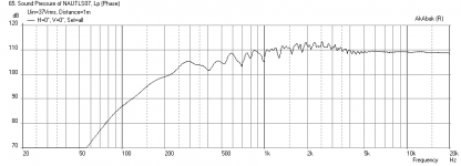

Nuataloss I with CHP-70

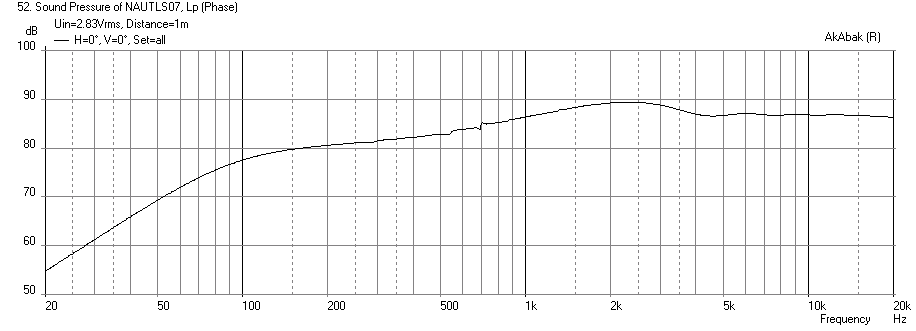

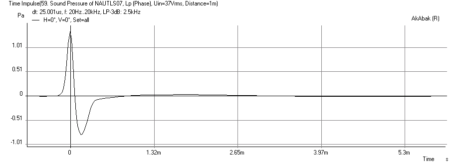

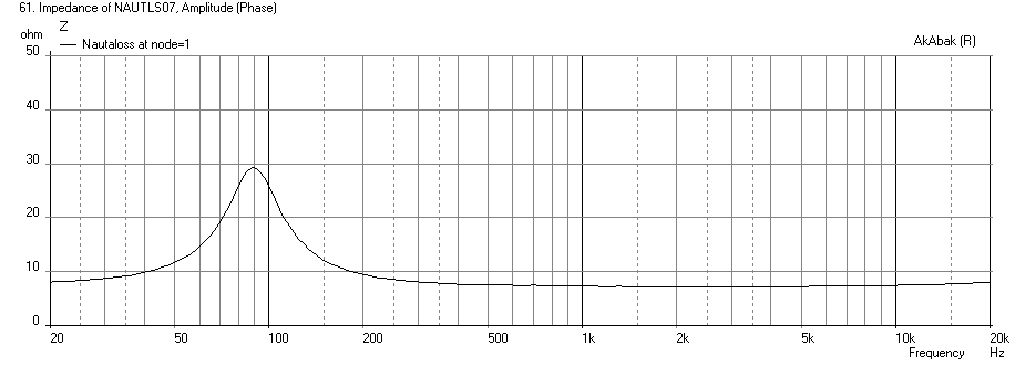

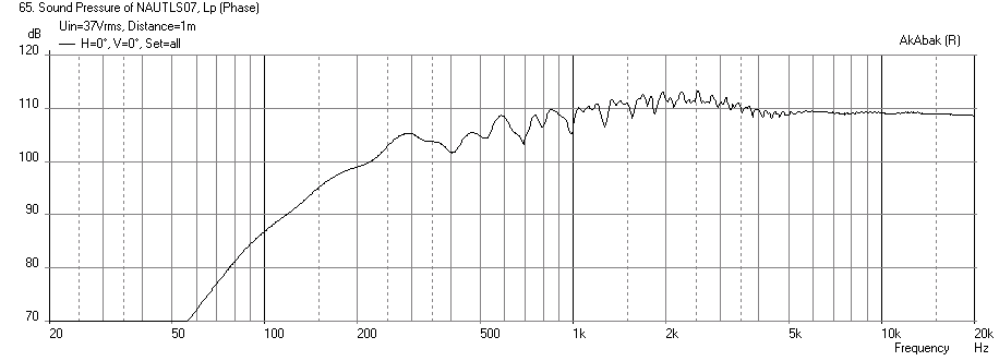

I think you mean CHP-70A (paper cones)? http://www.madisound.com/store/manuals/CHP-70%20Gen.2%20natural%20Eng.pdf

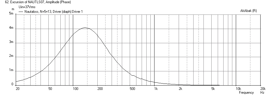

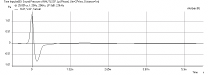

They work very well in the same dimensions as the Nautaloss I built. This is the single driver version. Here are the simulations (room reflections turned off).
Plots: SPL vs Freq at 2.83v and 1 meter (full range no filters), Cone Displacement at xmax (with -12dB/oct Butterworth high pass at 200 Hz), SPL vs Freq corresponding to xmax at 37 volts rms (with high pass filter), Impulse response with high pass filter, and Impedance. Last plot is what it might look like with room reflections turned on (62 in from back wall, 72 in from side wall, 39 in high on a stand).
You will need to EQ some baffle step correction from 1.5 kHz and below - however when I look at the the measured freq response curves, it looks like the driver has a built in baffle step compensation for off-axis listening (20 deg or so).
Looks like a great candidate for a Nautaloss and with the 4 mm xmax, you can achieve some pretty high SPL's of 109 dB at 1 m - suitable for a studio monitor. Although this power level cannot be sustained - just dynamic peaks as it corresponds to 170 watts of power.
Good luck!
Good luck!

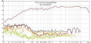

Study of the effect of miniDSP on SQ
Someone on another thread suggested that that the miniDSP alters the sound quality compared to not using one. The comment was that when used with an Enabled Alpair 10 full range driver - there was a 'veil' that appeared. The test to see if the miniDSP affects the sound quality would be to set the miniDSP to serve as just a high pass filter with the XO point set low enough not to impact the full range driver's main bandwidth.

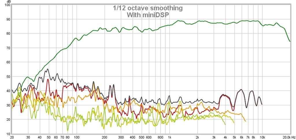

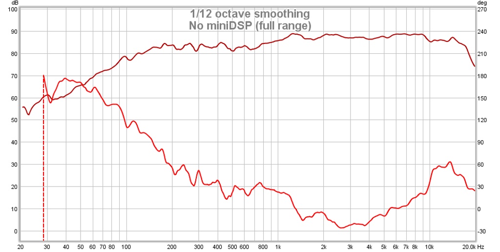

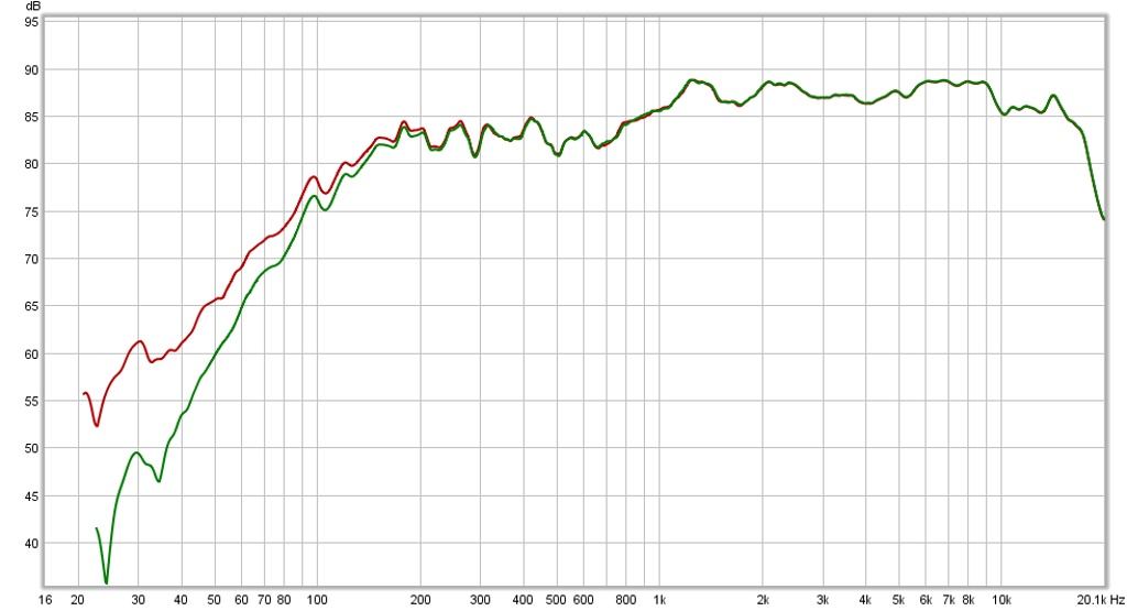

I set out to test this with the Nautaloss I by measuring the response in the nearfield with and without the miniDSP. For the case with the miniDSP, I set a LR -12dB/oct high pass filter at 50 Hz. For the case without, I went straight from the PC lineout to the TPA3116D2 amp. I adjusted the output levels to match. The results are interesting...
Here is the Frequency Response and Phase for the no miniDSP case:

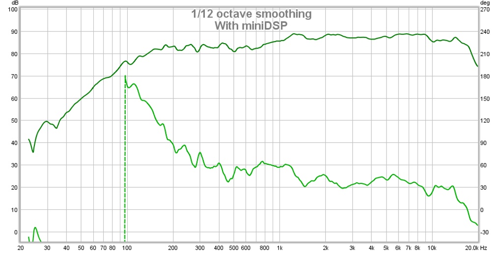

Here is the Frequency Response and Phase for the with miniDSP case - not the phase linearity and flatness is actually improved (by factor of 2x!) with the miniDSP. Of course there is phase wrap at the around the XO point which was expected as this is an IIR filter:
Even with the XO at 50 Hz, there still is residual impact to the fall-off from below 200 Hz that can be seen in the side by side comparison:
Here is the Distortion (up to 5th harmonic) for the no miniDSP case:
Here is the Distortion for the with miniDSP case - at lower frequencies the distortion appears to have increased but this is not important as the main pass band of interest is above 200 Hz:

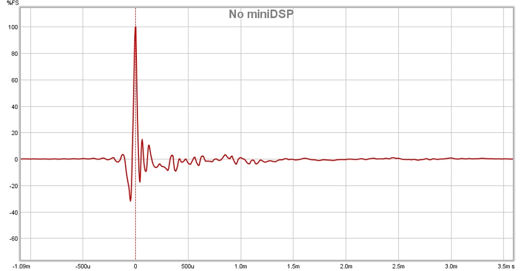

Here is the Impulse Response for the no miniDSP case - very clean with a minimal overshoot:

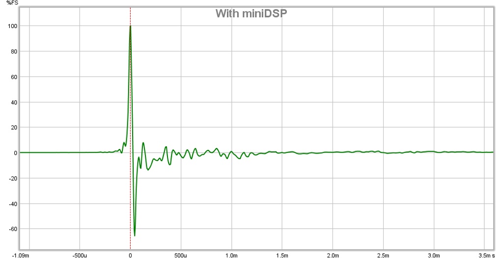

Here is the Impulse Response for the with miniDSP case - there is a substantial overshoot, but very short in time duration. I wonder how this shows up on sound quality when one listens to it? Does it sound excessively sibilant or too bright?
How do they sound with and without? I tested several different CD's with different genres, and styles. I really could not tell a difference - the difference in IR was not perceptible to my ears. Maybe it makes a difference with Enabled drivers?

You should compare electrical signals to remove any effect of mic room placement issues. This would give you a baseline, a reference to evaluate the before/after. Otherwise it's difficult to make any conclusions from this
What electrical signals are you suggesting should be compared ? You mean signal from miniDSP direct to ADC? I am using a USB mic so ADC is not separate. Isn't it the point to see if differences can be heard or measured at the speaker?
Amp out or Amp in will work. The latter will not show you how the amp reacts to the speaker load
I don't see why you say it's difficult to make any conclusions. The room effect is identical on both because the mic and speaker were untouched. The only change was how the signal to the amp was routed. Besides, room effects are below 500 Hz and the complaint from the member who suggested this test said that a HF 'veil' was present when the miniDSP is in the path. Clearly, the measurements show a perfect match on the frequency response from 200 Hz up to 20 kHz - the only difference being an improved phase linearity at expense of impulse response overshoot. From this, I can conclude from this measurement and my own ears that the miniDSP causes no noticeable degradation in the HF sound quality associated with the key frequency band associated with imaging, localization, and "airiness" as some people call it. Definitely no sign of a HF "veil" and if anything, the impulse overshoot may be heard (if you can detect it audibly) as a sharpness in percussion instruments - just the opposite of a veil.
I don't have an ADC input that can measure amplifier voltage transients and waveforms (an O-scope basically) and don't think it will give me any more info than what I am looking for here - measurable acoustic differences at the speaker output.
THank you for trying xrk. I will willingly admit that it could be either psychoacoustic or poor psu implementation. I asked a couple other fellows to listen and see if they heard a difference, not telling them anything about what was being done. POooooor abx testing, i know. Both identified when the DSP was inserted, post test. IT was tried on more than one set of speakers, exactly as i recommended to you. I am in no way claiming any thing about the DSP. This simply makes me want to attach it to proper PSU.
