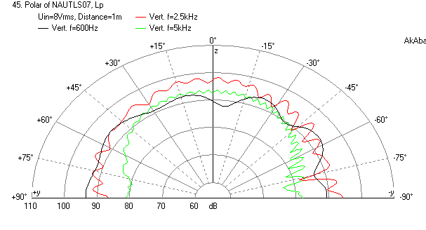

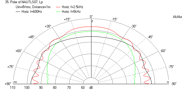

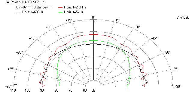

Sims of Polar Response of Nautaloss II
For Nautaloss II with dual drivers and single driver case. Speaker 45 in above floor and 40 in away from back wall. Mic is 1 m away with 8 volts rms drive. You can see the effect of the floor bounce causing ripples as well as the baffle step loss which causes a rising response ffrom 500 Hz to 2 kHz.

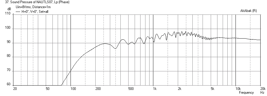

SPL vs Freq for Single Driver Case:
Polar Response for Single Driver Case (600 Hz, 2.5kHz, 5 kHz):

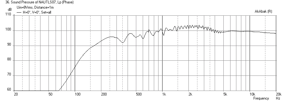

SPL vs Freq for Dual Driver Case:
Polar Response for Dual Driver Case (600 Hz, 2.5kHz, 5 kHz):
As you can see, the dual driver case does not change the horizontal polar response except for SPL level being higher. However, for the vertical polar response there is lobing at 5 kHz with the dual driver version as expected. Single driver vertical polar response:

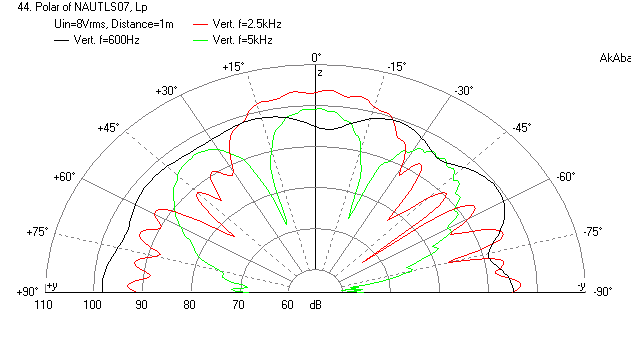

Dual driver vertical polar response:

Excellent work. The dual TC9 version is clearly a 'sit down and stay put' speaker........and there's nothing wrong with that other than it looks bad on paper. In almost every measurement scenario, a single point source will have better polars than anything else.

Good work! One thing I am curious about is that ripple in the frequency response...
It looks a lot like this:
As the single driver Nautaloss show that as well it seems like baffle edge diffraction to me?
(the graphs above are a bit of an exaggeration but you get the idea)
At least there is the "proof" that the dual version does not alter the horizontal off axis plots. As stated before the test.
The vertical results were a given, but I do hope this clears up some of the statements made in this thread 😀.
In other words: no real surprises here! Thanks a lot for doing this X, hope it serves it's purpose.

You are welcome! I also just took polar data (0, 15, 30, 45, 60, 75, 90 deg). What a pain that was for both speakers. It will be a while before I can extract and put into polar plot but visually it looks all good - consistent with predictions. So no effect of dual drivers on horizontal polar response. I also took some measurements at 2 ft intervals around listening position to see effect of sweet spot with stereo operation. Measurments made at 1 m so I now have reference data and it confirms smooth response and off axis response fall off of Vifa. Dual drivers boosted efficiency by 6dB exactly as expected. I also listened to Nautaloss I again. They sound better for presentation of image overall - more coherent. Not surprising so I think for near field where you don't need louder levels, single driver is still best.
Regarding ripple, you are probably right about the enclosure maybe doing that. Your rounded edges will probably be better. There is ripple in the data for sure and maybe I will try a rounded front baffle made of XPS foam hand carved radiused?

Comb filter effect is not an issue with line arrays, but is at it's worst with 2 drivers. One driver is a simple point source, which would be optimum if we could get the required spl's out of them.
