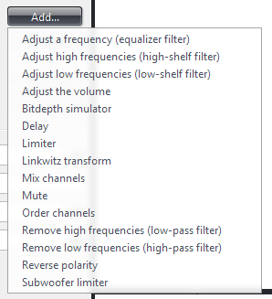

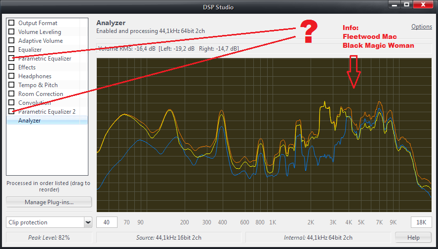

After that checked my JRiver and now wonder why there is two identical "Parametric EQ" packages which with same settings setup sounds different in high frequency area, the one have highs in your face and the other have soft highs. Later when trying to measure phase on a DEQ2496 I will try to investigate phase on those two too. First picture the two similar meny's, picture two is filters available, and is same for both.

wesayso you write they very expensive so just checked what actual that was, uuuhh only worth if used in scenario to get a income out of the invest, not for normal consumer. Looks like both companies make income delivering code pieces to both hardware and software products. This makes me think of example take EQ's they are everywhere in player packages, interface software for codecs, DAWs , OS and etc, but of course in lighter version than the very expensive RED/ORANGE.
Are you sure you need a second parametric EQ add on. Can you not arrange channels within the first? I will investigate this soon. Might order a couple of the ESS dacs to play with on this front.
Are you sure you need a second parametric EQ add on. Can you not arrange channels within the first? I will investigate this soon..........
With this i mean that maybe the one is IIR and the other FIR, as i expressed listening in highs the one is in your face and the other soft, and this is a comparing where the settings for the filter is at same frequency/amplitude/Q. You know I wonder why they put one named "Parametric Equalizer" and one named "Parametric Equalizer 2" when all settings and features for both can be the same. But irritating that the help bottom doesn't explain why 😕, hitting help bottom you just get routed to website with general explanation adding EQ and filters.
