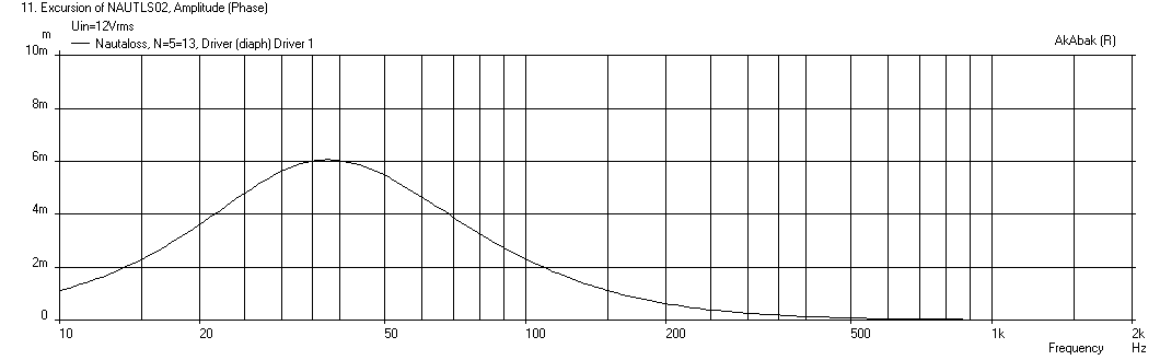

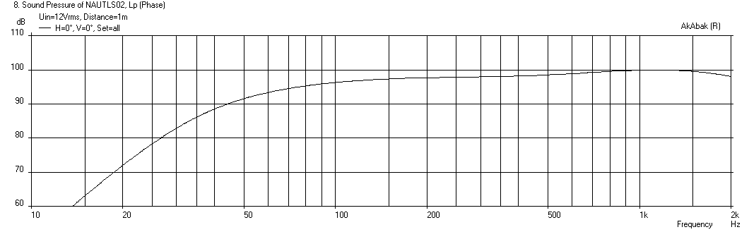

Grandcalmar,

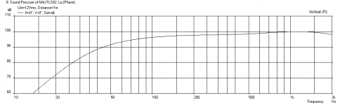

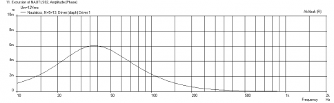

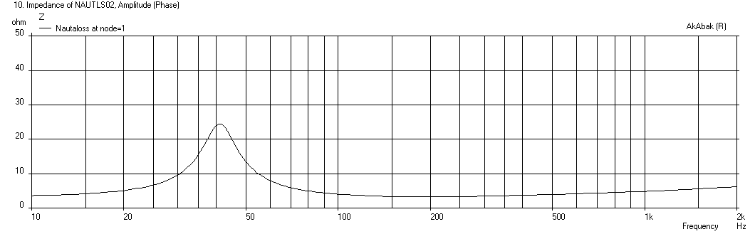

The driver actually can produce some decent bass in a Nautaloss. You are limited by what SPL you can achieve due to the moderate sensitivity and 6 mm of xmax. if you are OK with a max SPL of 90 dB at 45 Hz (peak SPL is 97 dB, and -3 dB point is 67 Hz) then this can work. It makes very smooth clean bass, and some attenuation EQ from 50 Hz on up to keep it around 92 dB can work.
Here are is the SPL at 12 volts rms corresponding to xmax, cone displacement, impedance, and impulse. If interested I will get you dimensions for Nautaloss spiral.

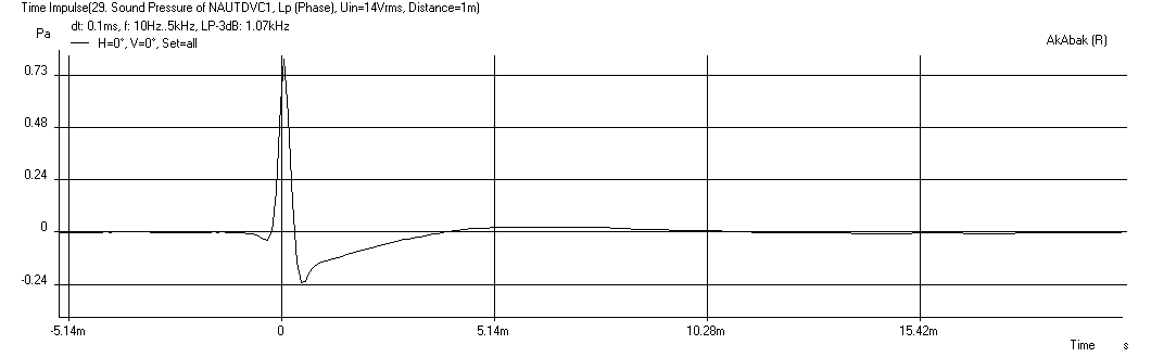

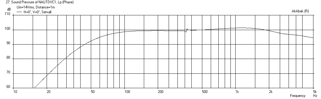

Grandcalmar,
I revised the design a bit to reduce the size and volume which actually gives a little more max SPL. Here is the profile of the sealed TL, your task is to take this linear profile and roll it up to a spiral however you can. This gives you some room for creativity with how you want to make the final outer envelope.
Starting from the driver face.
10 in tall x 4 in long
7 in tall x 6 in long
5 in tall x 24 in long going to a point (sealed tail end for 34 in long TL)
The internal width is 8.5 in
This design can take max of 14 volts rms. Here is SPL at 14 volts, and I think it improved the impulse response somewhat.

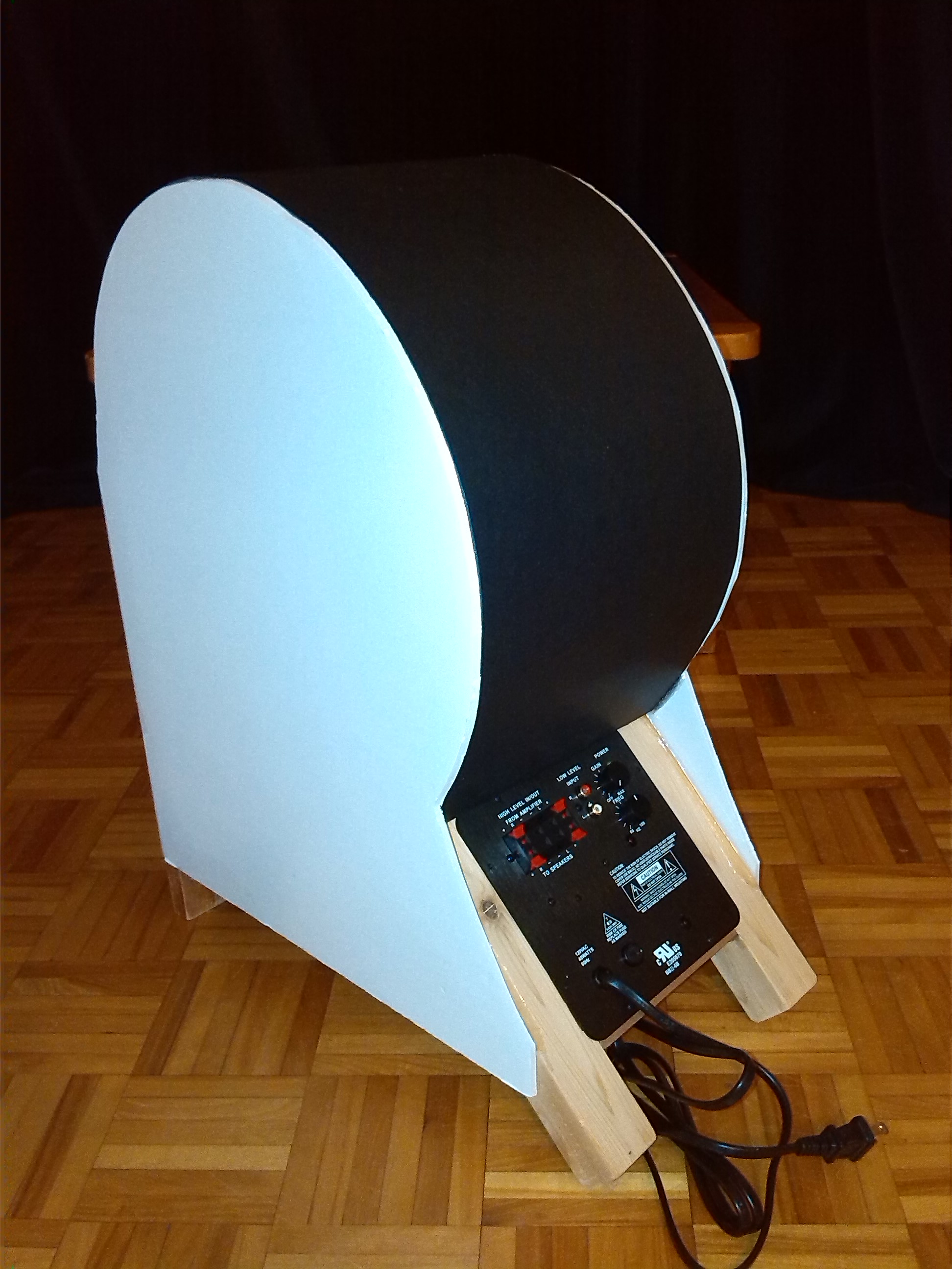

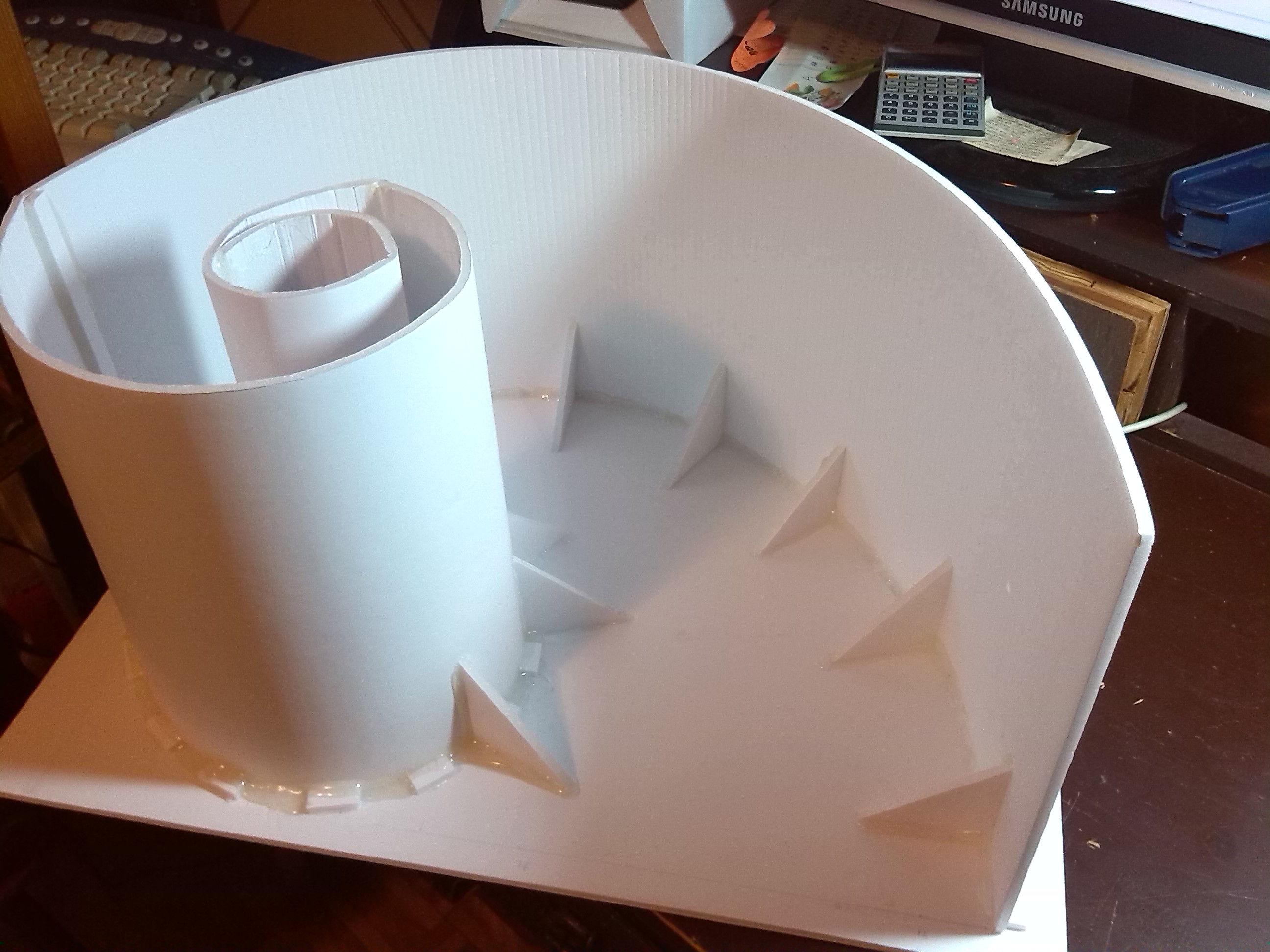

X,

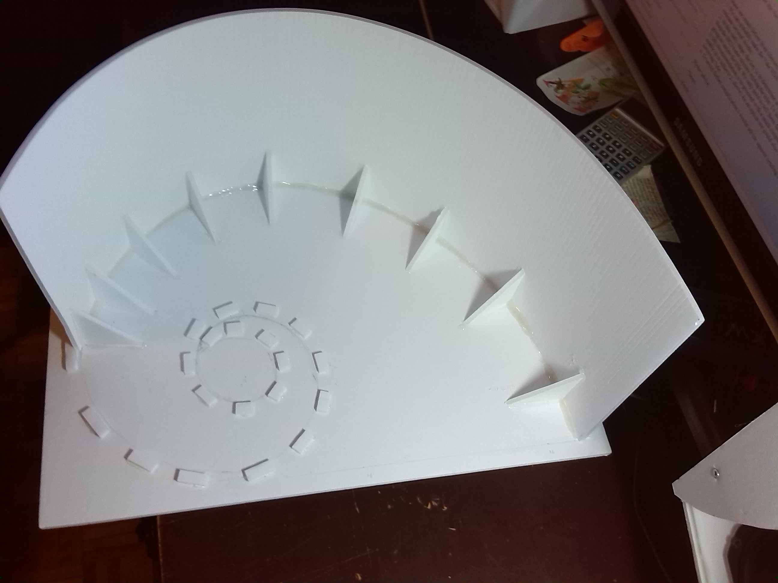

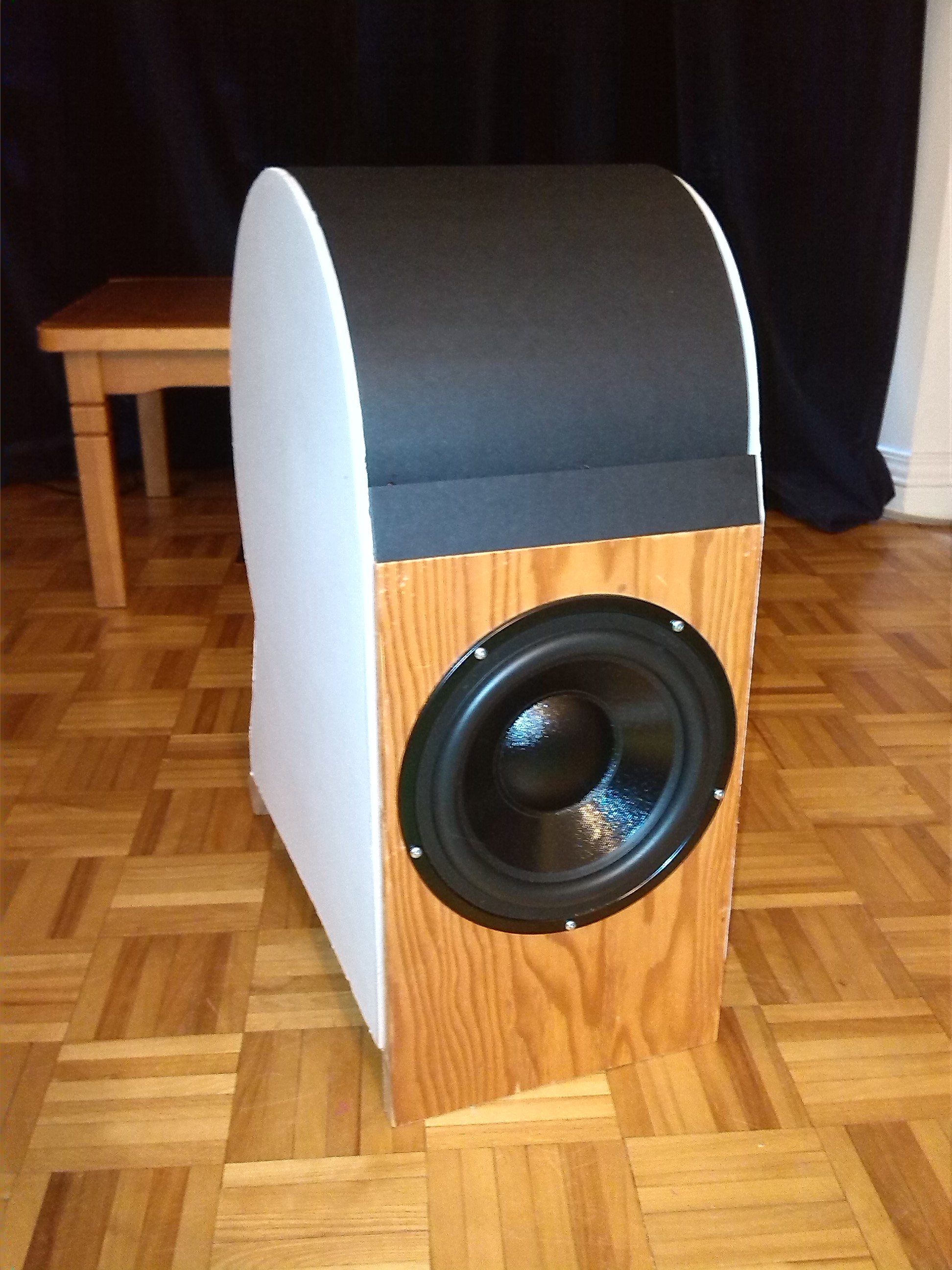

I finished the sub based off your design leads. I must say it was a lot more difficult not having your step by step play book for this one - but a good learning exercise.

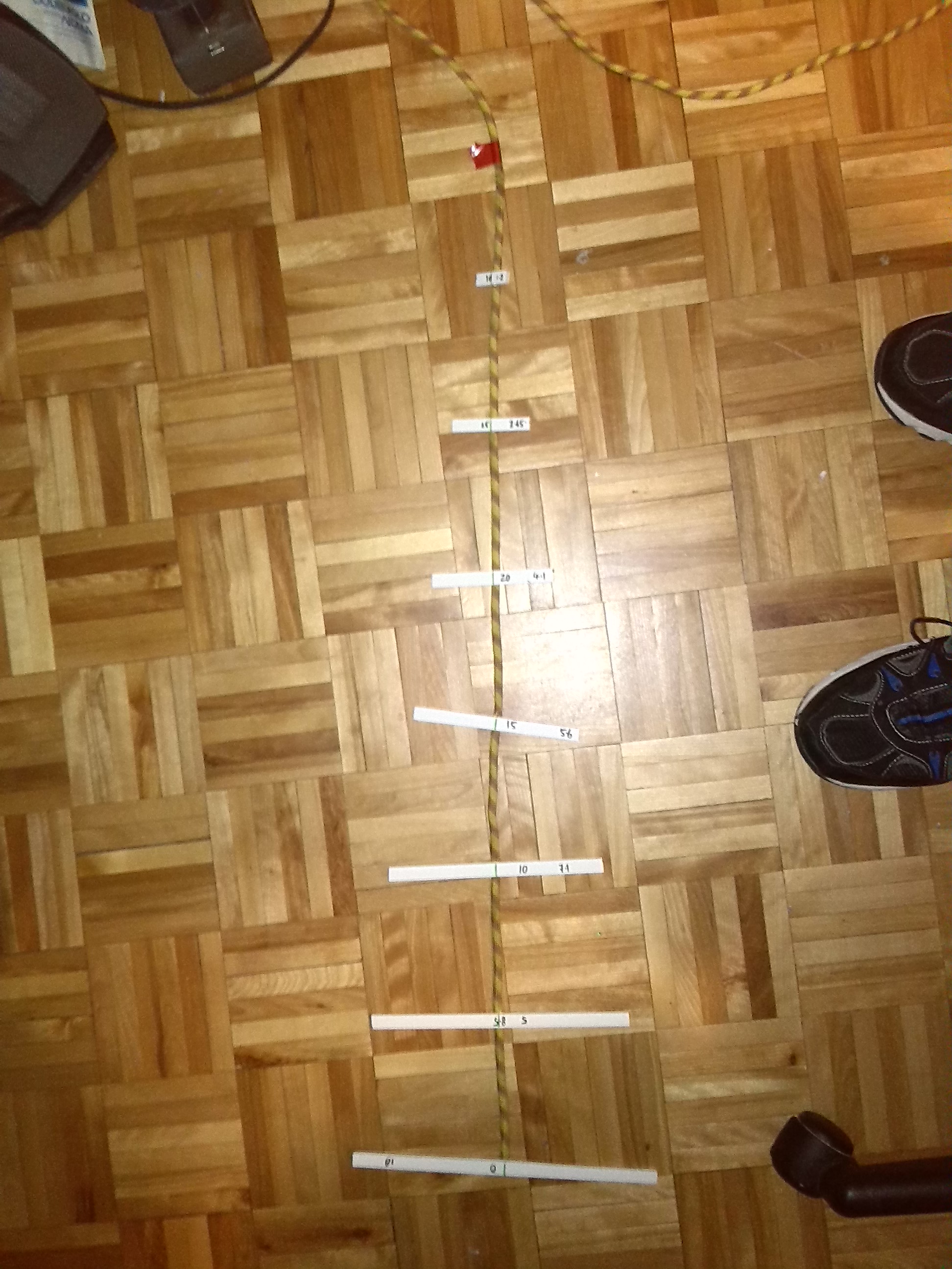

I struggled with working out how to wrap the spiral until I came up with using a piece of rope and FC offcuts cut to the width of the channel. I used a lot of bracing and this was a rather time consuming step. Next time I would make use of the marked out first side to plan out and pre-cut the bracing pieces. This would save time as well as aid keeping the spiral sections perpendicular to the sides.
I packed the central hole (where the spiral terminates) with rockwool thinking this would help sound dissipation. I also contemplated perforating the sides on this central portion as is done with the tubes inside mufflers - do you think this would have any benefit?
I planned on using 3 thickness FC for the baffle, but low and behold I found a piece of 3/4 inch ply of exactly the right width in the basement - couldn't believe my luck!
I've only managed to fire it up once, but oh la la it rocks! No strange sounds and somewhat surprisingly there appears to be less enclosure resonance than the FC cornus so I think the innards are held together well. I'm looking forward to giving it a work out with the dual B3N Karlsonators.
Cheers!

Grandcalmar,
I stand behind what I said earlier - you are a FC master craftsman! Beautiful work! Those spirals are so precisely laid out and clean. Glad it sounds great - good idea about laying out bracing before hand. That was indeed a time consuming step. I like how you integrated the plate amp! Very cool, very nice. Congratulations!
:cheers:
