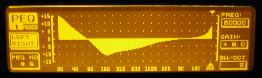

Well the light use I'm personally looking for will end up looking like this:
But that's another story. I think XRK971 can benefit from far less EQ than that 😀.

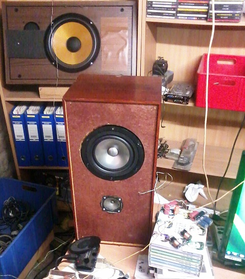

At picture a test setup full ranger sealed preferred setup alone and EQed from DEQ2496. Intend a better FAST with this 4" FR paired with 15" for more SPL. But reason for picture is the impedance linearization (both resonance and inductor compensated) filter seen on top CD's which changes mostly dampening, and if interested xrk971 request more info.

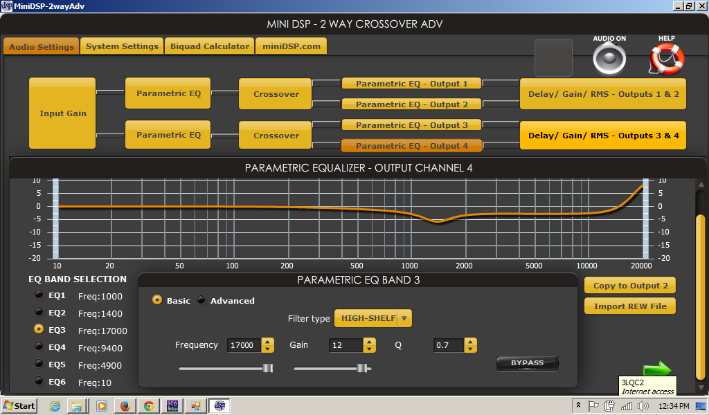

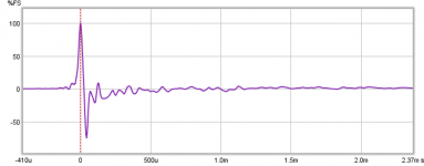

Judicious Use of EQ on Nautaloss I
OK, all this talk of having a light touch on the EQ got me to wondering what it could look like if I tried to cut peaks rather than fill valleys, and do it over a broad area. I implemented exactly 3 EQ filters:
1. High Shelf 1kHz, -3 dB, Q=0.4 (to help with the baffle step loss)
2. High Shelf 17kHz, +12 dB, Q=0.7 (to bring some air to the treble even though my ears can't hear above 17 kHz)
3. Peak, 1.4kHz, -4dB, Q=2.0 (reduce a peak that I am not sure what it is caused by? - this is the only narrow)
Here is what it looks like as implemented in the minDSP dialog:

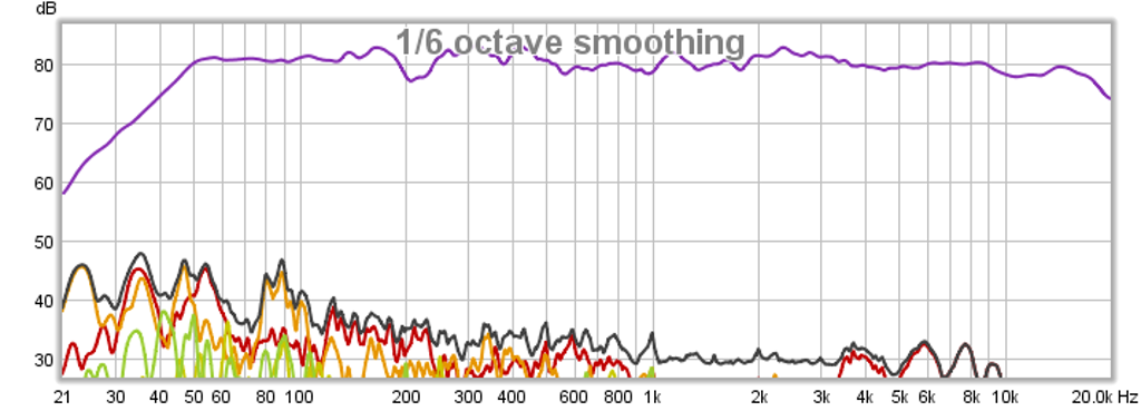

Here is how it measures at the listening position (about 2 m away)- this is quite a nice flat response that I think will reveal the true nature of a recording as the recording engineer intended. There is a dip at 200 Hz that is a room mode that I cannot get rid of without applying a lot of boost EQ so I left it alone. The harmonic distortion is amazingly low in the sub -50 dB and -35 dB in the bass region:

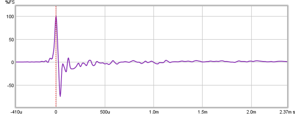

Here is the corresponding impulse response - very clean with the characteristic trailing overshoot introduced by the miniDSP that I demonstrated earlier:

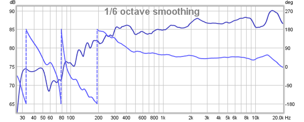

The big question is how does the above EQ affect the phase? To answer this, I placed the mic in the nearfield at about 10 in away and I get the following:
The phase is actually quite flat and does not wrap over the range of the Vifa from 200 Hz to 20 kHz. I think the light touch on the EQ worked and doing broad strokes and cutting tops rather than filling valleys worked well. The large +12dB high shelf at 17 kHz starts to make the phase distort but by the time you get to 20 kHz it is still reasonable, after that you can't hear it anyway...
Finally, how does it sound? I think it sounds really nice now. The imaging and sound stage are all there as well as the textures and dynamics. Here is a sound clip of something I listened to from YouTube as I don't have the recording yet - but this is a truly great track by SRV. Let me know what you think of the sound.
