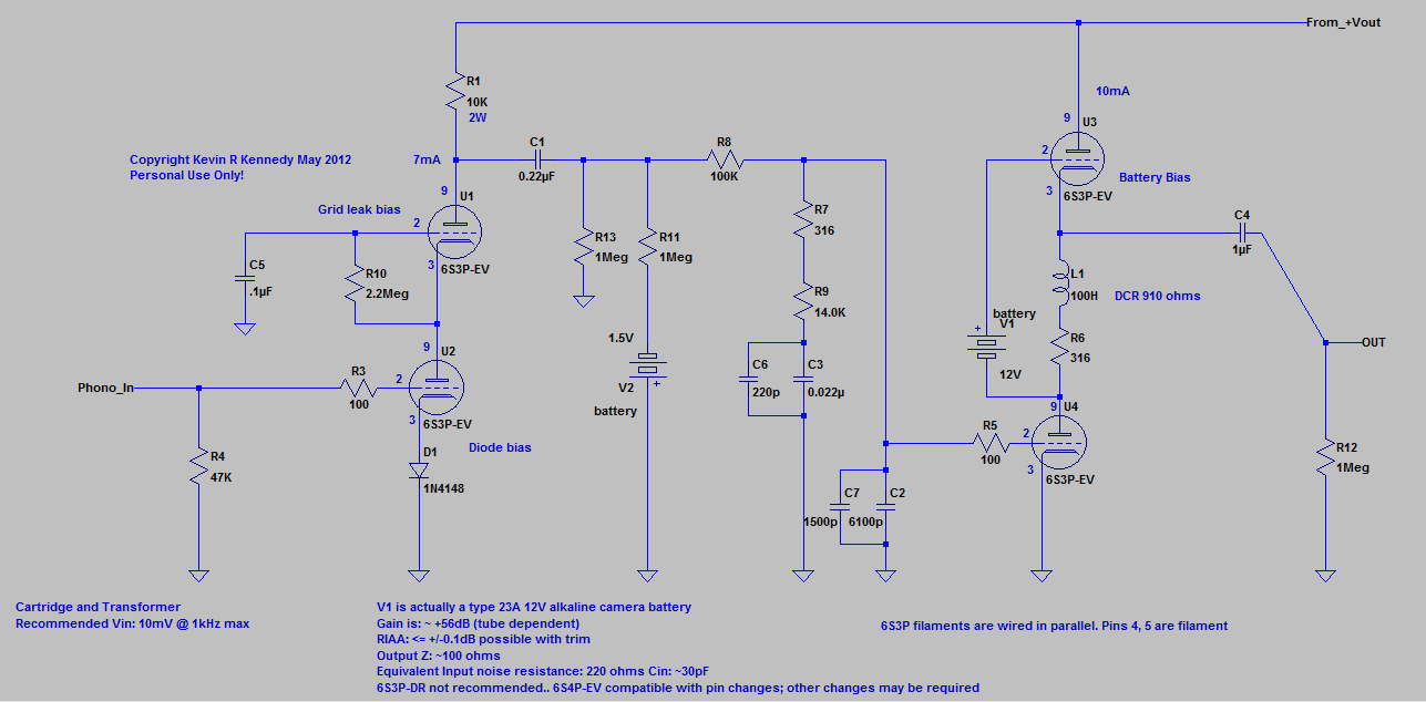

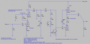

I've received a couple of requests that I post the final schematic as built rather than asking people to take the original and modify it with the various options listed in later posts - so here it is.
Note that I have removed the recommendation for the 6S3P-DR from the latest schematic as the samples I had access to were not nearly as uniform from sample to sample as the 32 6S3P-EV I purchased in several batches.
The chokes (L1 in below schematic) are Magnequest 100H type with a DCR of ~910 - 1000 ohms aka EXO-001, note that the winding resistance is important within the context of this design since the operating point of the upper triode is determined by the voltage impressed between its cold end and the grid. Target current is approximately 10 - 11mA.
Edit 2013-05-12: This is the final version of the audio circuitry.

Looking for a poor mans solution for L1. Which is more important the DCR or the Inductance?
I have a Edcore 5W, 5:1 when wired primary with secondary in series equals 967 ohms not sure of the inductance but I'm sure it is less than 100 H.
I'd give the Edcor a shot, the DCR determines the operating point of the stage, and the inductance determines at what point the gain at the LF end of the spectrum starts to drop off.

Note that the Lundahl LL1668 / 25mA choke with the windings wired in series with a 221 ohm resistor will provide both the required inductance (100H) and proper dc resistance for biasing the choke augmented mu follower second stage.
