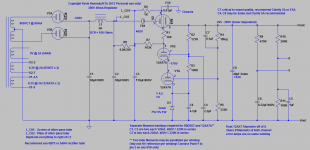

In light of further experience I made a minor revision to the value of R6 (see Final PSU) in order to slightly reduce the plate current in the 12AX7 error amplifiers without increasing the loop gain. The value changed from 4.7K to 6.8K and should reduce the plate current to just slightly over 1mA, a slightly better operating point on the plate curves given the relatively low plate voltage across each device. This also reduces screen voltage slightly with a very small resulting reduction in transconductance.
Output noise has dropped very slightly, other changes probably too subtle to pontificate about.
In case it is not obvious the supplies are very much 'in the picture' sonically speaking due to the lack of RC decoupling in this design (a deliberate design choice) but it does mean that significantly altering the performance of the supply and that supply deficits are going to be audible. The PSRR of the cascode input stage is negligible obviously.. 😛
Edit: Schematic removed to avoid confusion.

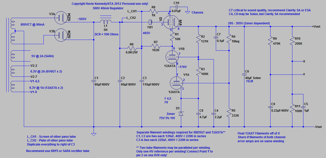

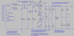

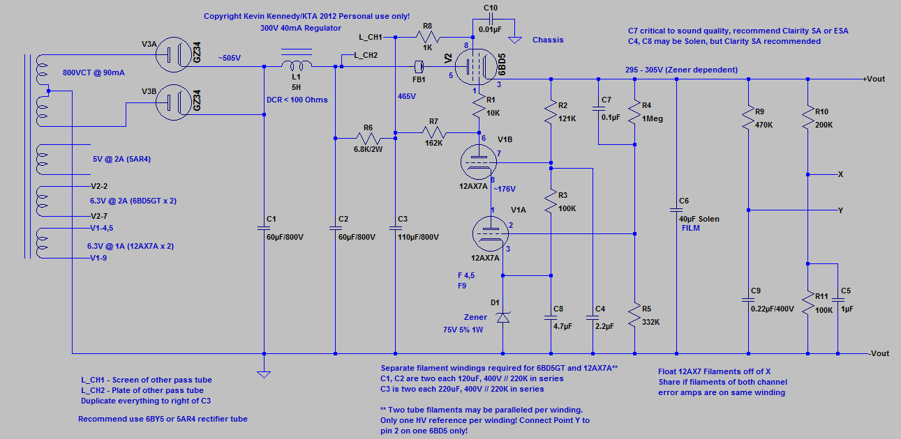

High Voltage PSU Updates 6BD5GT/6V6 (Improved Schematic)
Last night I replaced the 5AR4 with a 6087 which dropped the plate voltage by roughly 20V, the bad behavior stopped immediately and did not recur for the balance of the evening. Since the 20V drop in HV (more than 10% reduction in headroom across the pass element) also slightly reduced the transconductance I surmised that the combination of my circuit design and high line was a recipe for instability.
I have added a 1kV ceramic cap from the screen grid to chassis ground and a ferrite bead within 1cm of the plate lug.
The ferrite bead can be any with 100 ohms or more loss at 100MHz. These just slip over the plate lead and must be close to the socket.
Whether or not this actually works as a complete fix remains to be seen, so far it seems to, but many more hours of use under differing line voltage and ambient temperature will be required to be sure.
I reinstalled the 5AR4 and so far for about an hour it has behaved. I'll report back as to whether the problem is fixed or not later.
Edit: 2013-05-12: Most current version of the HV PSU
PSU Sorted
Happy to report that the screen cap and plate ferrite have resolved the power supply issues reported in the last few posts.
The dual supply despite the added complexity does seem to bring something worthwhile to the equation, the much reduced inter-channel cross-talk has resulted in significant gains in both image width and depth - the most in fact that I have ever heard in my system. Noise levels are extremely low, and as noted this pre-amp is the least microphonic I have ever designed, clearly the 6S3P-EV is well suited for this application.
Those wanting to get really extreme could build it fully dual mono with separate rectifiers and filtering - I am not certain of the point of diminishing returns, but I've probably surpassed it even with this design.
The other potential improvement would be to heat the 12AX7A filament with regulated DC which might very slightly improve the performance by eliminating the error amplifier tube filament thermal response (DC output wander) to varying line voltage. The observed wander is only a few mV typically with a good 12AX7A so this is definitely at the point of diminishing returns. I did not use the DC filament supply to the pre-amp to power these tubes because the required DC offsets (bias) are quite different - the 6S3P is not supposed to operate with the filaments positive relative to the cathode although I do this currently and have not observed any ill effects.

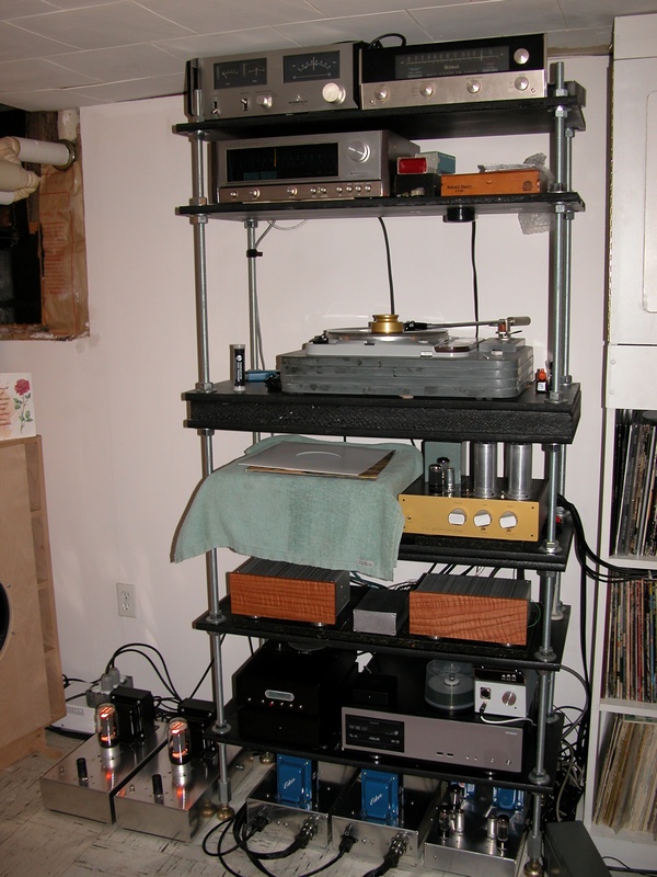

The current set up consists of an Ortofon SPU Meister Silver GM on a Schick arm on a TD124/II. The output of the SPU is fed to a pair of Lundahl LL1941 configured for 1:16 step up which drives the Muscovite.
It is extremely quiet, at anything below an insane volume setting I'm not aware of any noise at all until the needle lands on the lead in groove and then it is pretty obvious just how high the volume is set.
The resolving power of this design is a considerable improvement over my last design. I'm frankly surprised at how much information is contained in those tiny little grooves. I have to admit the cartridge plays a rather major role here too, I have several other lesser cartridges and their shortcomings are rather obvious in direct comparison and over time. There are more differences in performance capability than I had imagined would be the case as I climbed the cartridge price ladder.
I've attached a picture of the finished units and power supply in their permanent homes.. The phono pre-amps have blank wood panels and the SUT is sitting between them.
I have to admit the digital gear and tuner almost never get turned on, I'm listening almost exclusively to vinyl unless the music is background to some project activity on my work bench. 😀
