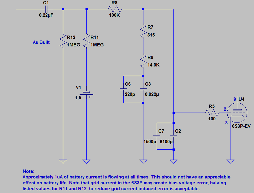

Referring back to the schematic where I showed how to implement battery bias on the lower triode of the choke loaded mu follower I have implemented this in my pair of pre-amps.
First I'll state that measurable differences are pretty close to nil with the exception of a very slight change in operating point.
A couple of points I will mention are is that the RIAA network is now polarized to the tune of ~ -770mVdc which is the negative grid bias.
The dynamic impedance/non-linearity of the 1N4148 has been removed from the signal path in the second stage. The gain is a few tenths of a dB higher.
I had a little trouble finding a spot for the battery holder. The required changes are to replace R11 a 562K with a 1M resistor, and add R12 also a 1M resistor.. Note this is slightly different than in the previous post referencing this mod. See attachment below.
What I can say is that it does seem to make a subtle, but positive difference. Resolution seems very slightly enhanced, the bottom end has gained a little additional definition, and the highs are subtly smoother. Very incremental changes, and perhaps not worth the bother of an additional set of batteries, but I think they will be staying.
Current drain is 0.75uA so essentially battery life should be close to shelf life as in the case of the 12V bias battery on the upper section.
Potentially a worthwhile improvement for the obsessive.. 😀

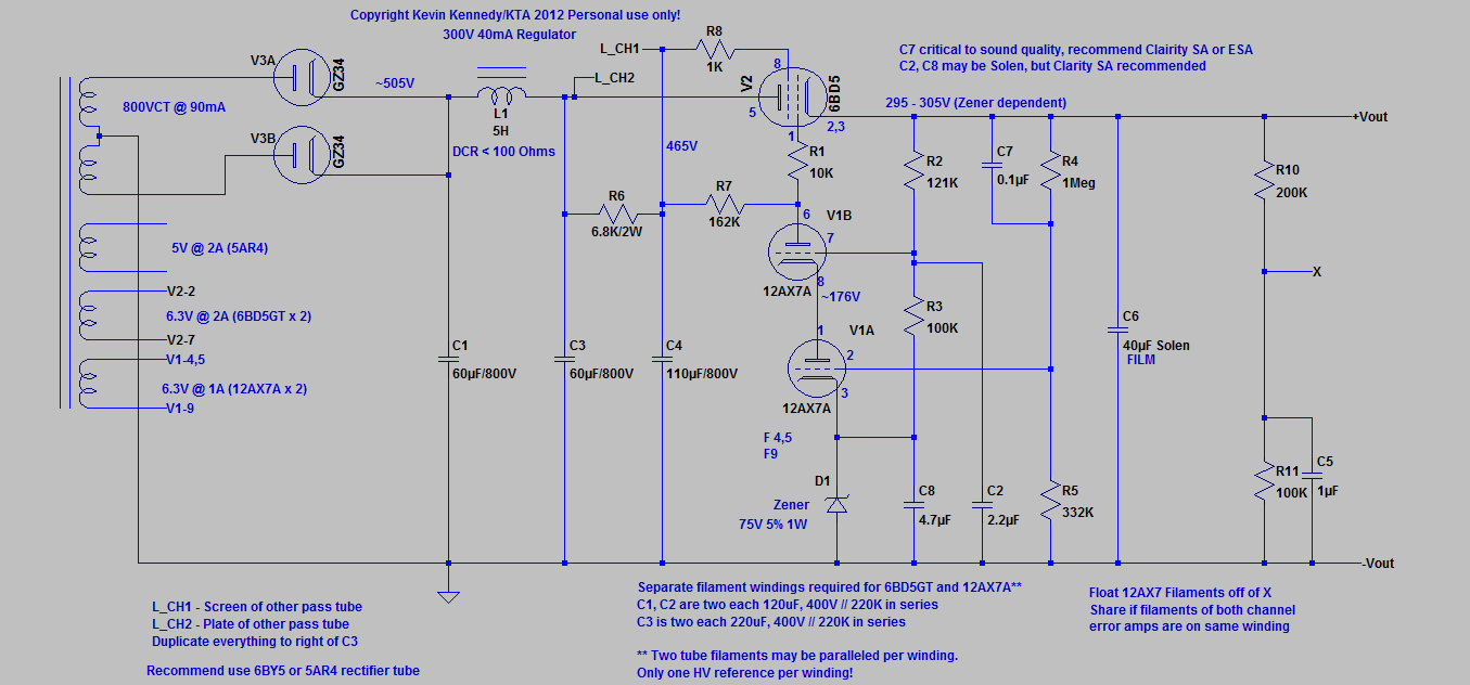

The power transformers arrived on Thursday night and Saturday afternoon I started to punch the chassis and mount all of the parts - I managed a little wiring before knocking off to go out to dinner. Today after I got back from ice skating I started wiring in earnest, and was able to complete and debug the power supply over the course of about 8 hrs today/tonight.
The 6BD5GT that I choose to use instead of 6V6/6L6 is a little more fussy than I am used to, and my initial reward for all of this work was relaxation oscillations and some VHF garbage. This was resolved in a few hours along with a bad buzz originating in the reference for the right channel supply. (Don't reference filaments directly to a zener used as a reference - apparently this can result in sufficient leakage current to make the reference noisy)
The design has been running for about 1 hour without problems so I would not consider this fully vetted. Build at own risk and expect some issues to be resolved if you follow this route.
Note that I built two supplies, one for each channel sharing a common raw, but rather well filtered supply. The output voltage is approximately 302V, and output noise and ripple is approximately 700uVrms - the pre-amp is now extremely quiet.
Performance overall seems slightly improved if anything, as I mentioned it is quieter overall, and the tonal balance seems if anything even more neutral than before.
The filament supply is not yet documented, but is conventional LT1084 implementation. (It is fully floating.)
EDIT: Power supply misbehavior root cause was pinned down tonight, I also determined that the filament supply is OK, and spent several frustrating hours before I discovered one of the two 6BD5GT pass tubes was gassy. (This caused popping and all sorts of other bad behavior and was visible on the raw plate supply. The strange violet glow at the base of the tube was the clue as was the occasional muted pop when the B+ came up. Replacing it solved all odd behavior.. I did change R6 to 4.7K which further quieted the screen supply, and is recommended for this reason. Schematic updated 7.25.12
EDIT2: Changed R6 to 6.8K and updated schematic to reflect. Shifted operating points of error amplifiers and dropped screen voltage slightly. 7.29.12 (see revised regulator design later in thread for current implementation 5.12.13)

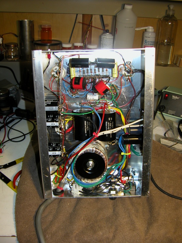

Here is a picture of the inside of the power supply chassis just before I drilled the holes and mounted the bottom cover plate.

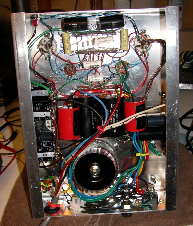

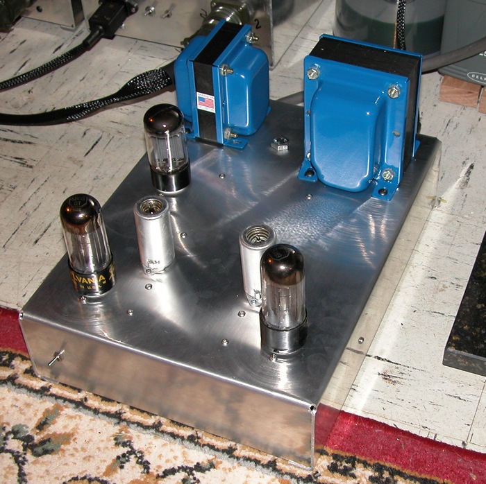

Some minor changes to the power supply since the last photograph. Removed and moved a pair of Clarity SA 4.7uF caps to the phono stages, replaced the 0.1uF feedback caps with Clarity SA and beefed up the grounding to the references and feedback reference points..
No problems so far, one minor thump due to a nearby lightening strike.. (Yeah I just generally ignore the weather outside, figure worst case I'll need some new power transformers.. 😛 ) Most of the analog gear runs on balanced power from a 600Va medical grade isolation transformer. The GM70 power amps don't like my 1kVa medical isolation transformer very much so they run direct.
