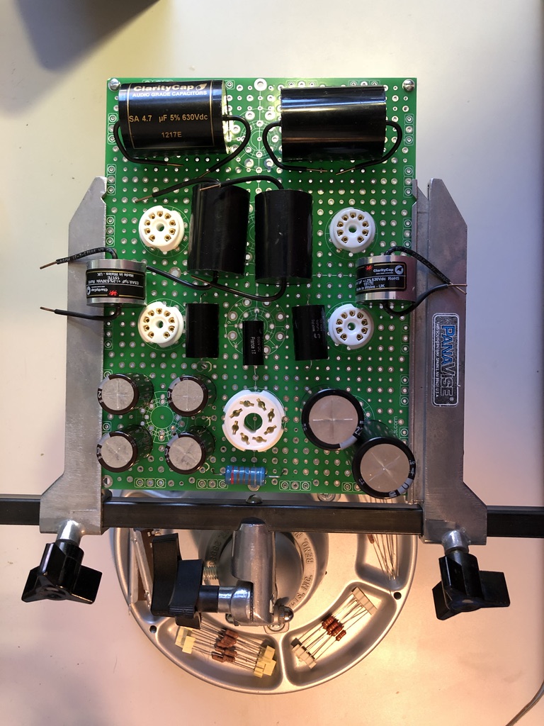

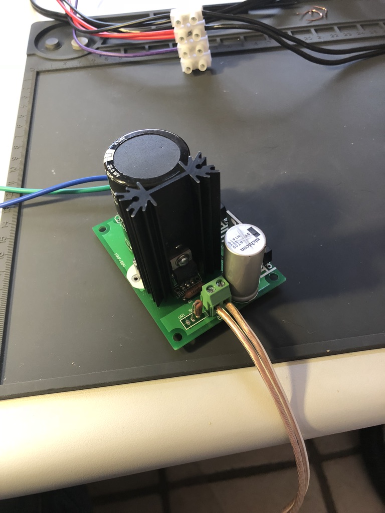

Well, I finally got a start on my Muscovite. Here's a first/rough layout of the power supply on a 6' x 8" protoboard. I not sure if I'll use it or not but would mount the tubes on one side and components on other if I do. Then mount it so the tubes pop thru the top of the chassis. The little board is for preamp filament supply (1 per channel). I tested it at 1.3A (equivalent to 4 filaments for 6S3P-EV) with an electronic load and it looks fine on scope. Heatsink gets to about 60C in free air. I've got similar boards made up for filaments for 12AX7 error amps.

I've had to rethink the layout and the filament supplies. I hoped to use the 6V/1A winding on the big Edcor for the 12AX7 filaments but it was barely marginal. About 40 mVRMS ripple on the regulator with a 600 mA load, and it was very close to drop-out at 120 VAC (measured) line voltage. A 25VA/9+9 VAC secondary from Antek (AN-0209) works great. The little boards I was hoping to use for filament regulators won't work as they simply take up to much real estate in the chassis so back to the drawing board on those.

added in proof: I'll probably just tie the 2A and 1A 6V secondaries together for the 6BQ5 filaments. I phased the transformer secondaries and used Mark Johnson's Quasimodo gizmo to find the best values for snubbers on the regulated filament supplies. Will post values once I confirm the measurements.

I'd be careful about tying those secondaries together, if they differ even slightly in length they will fight each other.

Thanks for the advice Kevin. How does length (and associated electrical properties) fit in? You mean if the voltages on each secondary differ?
