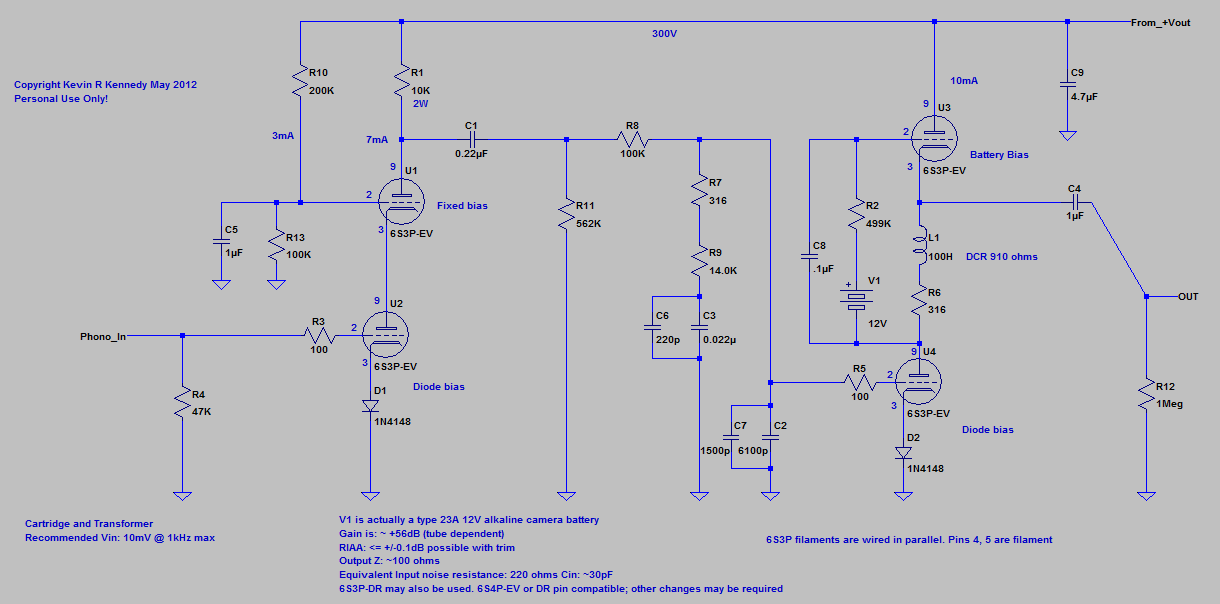

All parts for final power supply have been ordered, it is essentially the supply shown in this thread, but I have decided to build one for each channel, but sharing raw filtered DC and filtered screen supply. I will probably also use 6BD5GT as pass tubes and DC filament power on the cascode error amplifiers in the supply.

Here are some minor variations on the theme previously expressed. Essentially the changes are two fold (and not implemented in my design), the first eliminates the dependence on grid current for biasing the upper half of the cascode, and the second (previously shown) removes the battery in the choke based mu-follower from the signal path.
As always there are trade-offs, the quality of the power supply becomes even more critical with the fixed bias version of the cascode in exchange for hopefully more consistent behavior over the life of the tubes, and in the case of the mu-follower the quality of the coupling capacitor may impact sound quality. Both add additional complexity, although relatively minimal cost. Just an alternative to experiment with if so inclined.
Some comments on parts
All resistors in this design in both the supply and pre-amp circuitry are metal film.
Pre-Amp:
I've older Holco H4 in most locations in the audio path, but the cascode plate load resistor is a 2W Roederstein 10K 1%, and series resistor in the EQ is a Caddock MK-132. Nothing terribly exotic or expensive here.
The EQ caps are selected, closely matched REL RT polystyrene and foil type with a base tolerance of 5% - quite cheap actually.
The most expensive parts are the coupling caps which are TRT Dynamicaps, but the Russian FT-3 should work well for the 0.22uF. (Leave plenty of room)
The 6S3P seems quite a bit more forgiving wrt to VHF oscillations than the 5842 or D3A or any number of other high transconductance tubes, no signs of any oscillation using my 100MHz Tek scope. Probably not a good idea to omit the grid stopper on the input however, both for stability and potential RFI.
Power Supply:
I'm stacking Panasonic 450V caps in the current supply to achieve 50uF @ 900V. Each of these caps has a resistor across it to assure that voltage divides equally across each cap.
The output cap is film.. There is no reason why all the HV supply caps could not be film if cost is not a concern.
Power transformer: Edcor XPWR-228-120
Choke: Edcor CXC100-5H-200mA
Filament: Antek AN-0509
Note that in theory at least an EI transformer for the filament supply should provide more isolation to EMI on the power line - in practice in a half dozen or so designs where I have used these toroids there has been no problem.

Acceptable pass tubes for use in this supply design include the 5881, 6L6, 6BQ5, and 6BD5GT - note the different pin outs where applicable.
Note with regard to the high voltage supply there is no reason if desired not to go with independent regulators for each channel - that is exactly what I am doing for mine. Only one power transformer, and choke are required - the input filter caps C1, C3, and C4 do not change. Just double quantities for all other parts.
Don't forget sockets for the PSU as I forgot to include them in this cut of the BOM.
Added the detail for the filament regulator to the BOM. Note that in addition to the LT1084 5A regulator you will need a silpad, suitable insulated hardware and if not using the PSU chassis as a heat sink, some sort of suitable heatsink..
Dissipation in the regulator could be 12W or more depending on line voltage and transformer selected. Use a heatsink with thermal resistance to ambient of less than 2C/W.
Note that the filament supply wants to sit fairly close to ground so as not to overstress the 6S3P filament insulation so this really precludes using this filament supply to power the 12AX7A in the high voltage regulator because of the near 200V differential between filament and cathode.
Note also that with regards to "C4" in the high voltage regulator this could be changed to 110uF total using a pair of 220uF/350 - 450V caps in series shunted with 220K 1W resistors to assure that the voltage divides equally between them. This would be good for a few dB additional ripple reduction.
