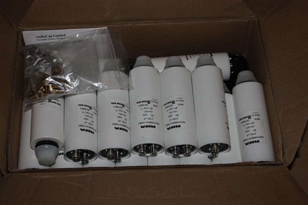

you need some these sweet things
only 6800uf and not so big
but high current caps
they can take it
hey, with this kind of caps, factory boxes are not very big, and a lot cheaper

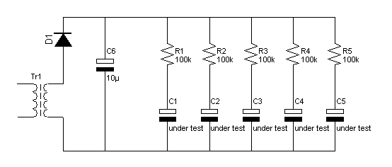

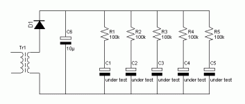

Years ago I had to check capacitors from a bunch of NEW OLD STOCK capacitor.
Here is a circuit that will work
Choose a transformer with a voltage of 70% of capacitor rated voltage and power the circuit for a few days.
Then measure voltage acros every resistor and calculate leakeage current.
Pick the one with the lower reading.
