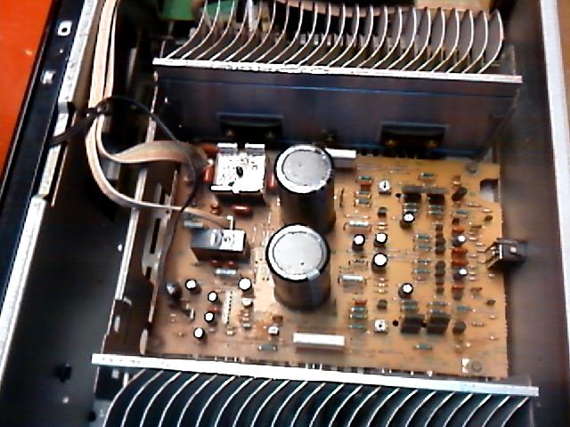

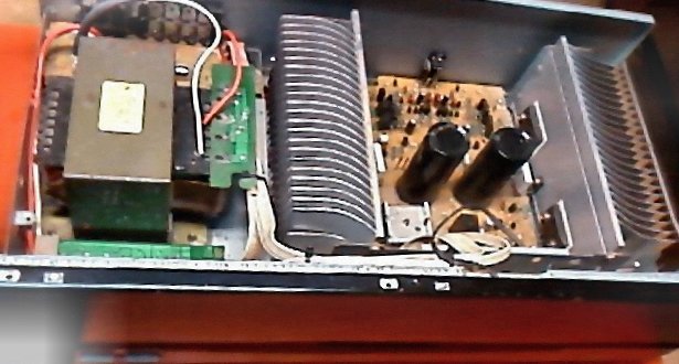

Here's photos of the inside of the Kenwood.
Maximum possible size of the amplifier board is: 6-1/16th x 7-1/4 inches
However, a slightly smaller size would be easier to install.
My earlier estimate of amperage may have been overly optimistic by the entire difference of what it could do versus what it should do, and that's really different.
What it "should" do is plausibly 475va.

The lack of smoothing capacitance must be helping to save from disaster.
They could have a bit of deliberate resistance built into the wiring from Secondary to Amp PCBs.
Yes, I was suggesting 1500W of BJT for the output stage (3pair of MJ21193/4) whereas it looks like 400W of output devices have been used to save money.
The protection locus must be very robust to make the devices survive ham fisted operators.

Its outputs are 2SA1494, 2SA3858
Well, we might could assume that replacing caps won't fix Kenwood's design; so, I would like to consider addressing the actual problem by removing their amplifier board.
Do you think that the transformer, enclosure and heat sinks are usable for the AX kit?

Sounds rather like my Teac, it had 70V supplies and yet only one pair of Toshiba 2SC2565/2SA1095. The main board in the middle of the heatsinks is only 125mm wide and 240mm long, containing only the main supply capacitors, drivers, and outputs (and the protection circuit). The voltage gain circuitry was on a seperate pcb and connected by wire. Not surprisingly there were compensation capacitors all over the place.
The heatsinks are about 240mm wide, 70mm tall with a 5mm thick backplate, and 50mm fins. It is a proper extrusion though. Not black anodised.
I think the original A919DC was specced at 100W per channel into 8 ohms, which made me wonder why on earth they used 70V supplies!

The heat sinks are 3/4 inch away from the top. The rear panel is 4-5/8" tall, so the manual's height dimension seems to have included plastic feet.
Then they will fit , facing down with the 7 devices bolted upside down along the bottom. The input edge of the board will be at the top. you will be left with 1/4 " at the top.
