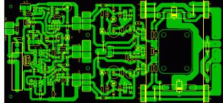

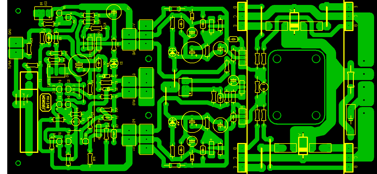

The nikko split the OPS and driver/voltage stage in two. Mine will do that as well. I already have a pair of AX's , just have to make the OPS boards ... all done. Modular is nice. 🙂
(below) module attaches to OPS at a right angle. Just like the PB120.
OS
OS
Then they will fit , facing down with the 7 devices bolted upside down along the bottom. The input edge of the board will be at the top. you will be left with 1/4 " at the top.
My reason for concern , I just may give you 2 PCB's 🙂 (you be the guinea pig)
PS - you still could just recap the original 😛
OS
