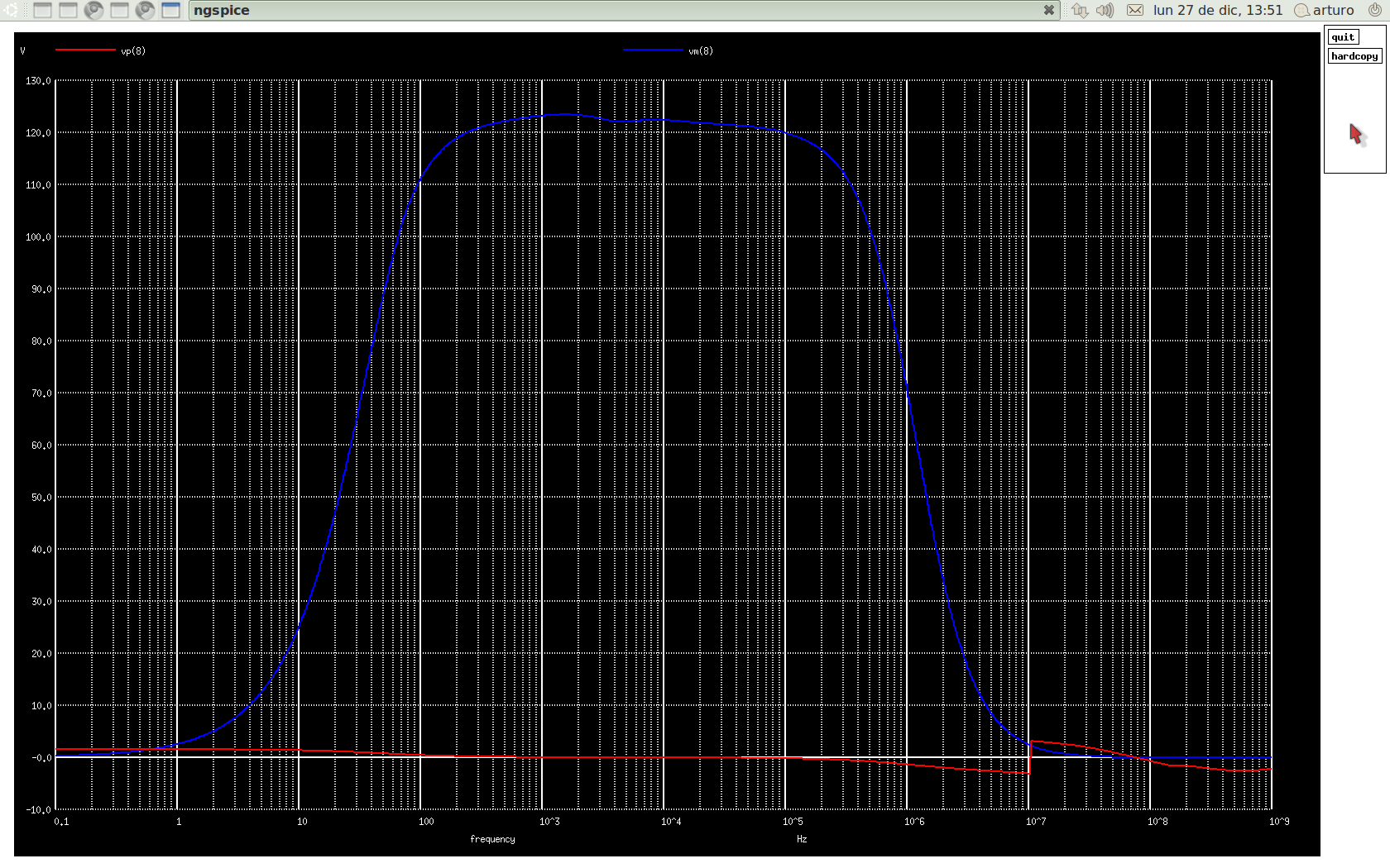

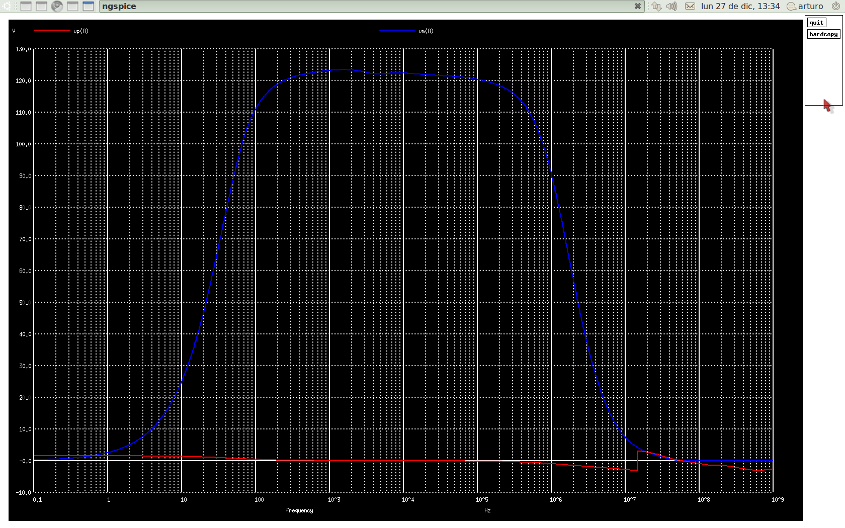

OLG bandwith
Hi AndrewT In short, it doesn't strangle OLG, Plots showed are with input LPF, and output loaded.
1) OLG without dampers
2) OLG with dumpers
You will see a little displacement of the 2nd zero.
Cheers
Arturo
PS all simms showed are from my amp, I haven't simmed OS amp yet.

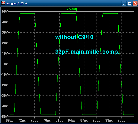

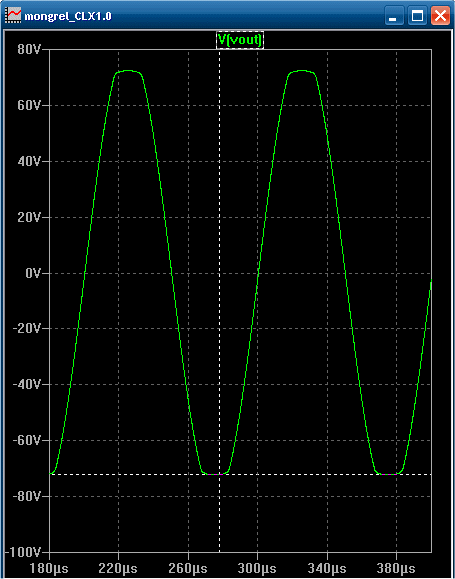

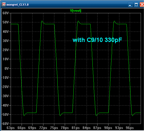

Hi, artu. I never intended to build exactly Your amp ... but there are features (the VAS) that I like. At this site/ link: --- A HiFi Power Amp --- , there is a very similar one. I noticed with a VERY SMALL LTP degeneration your original compensation works as described. My goals were to better the Leach while using similar compensation. My transient tests confirm that with lower loop gain (47R Re) the "backside" compensation (the 270-390p - C9/10) creates much overshoot (pix 1 -with c9/10)which corresponds to the phase margin plots in my last post. Removing c9/10, gives me this (Pix 2 - without C9/10). "Littlefish" seems to have gotten nearly the same results , mine are a little better as I use better devices .... MJE340/50 are so "yesterday" 😀. Clipping at my max 350 watts + (144v p-p) is a breeze for this amp , better than any "blameless" , nice rounded edges .. almost "soft" clipping (PIX 3)... NICE. 😎
Worst case , I won't be out of luck. I intend on keeping the pads for the extra comp. there , I might want to experiment with lower impedance NFB networks , etc.
OS

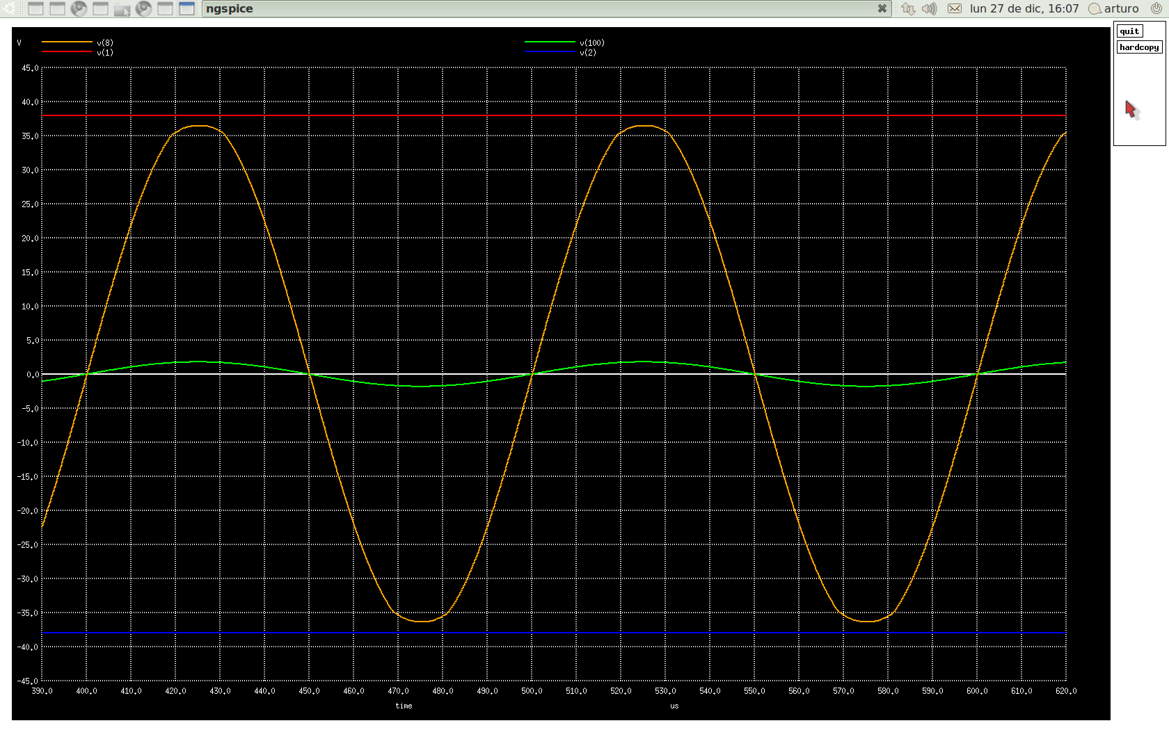

clipping issue
The clipping behaviour of mine. Question did you stripped the degeneration resistors of the VAS? if not so the circuit is working in a different way I've intended in design.
1) start clipping (before input saturation)
2) clipping (input saturated)
3) hard clipping
Note that when medium to hard clipping there are very little overshoots at the edges due to the stored charge at output BJT cannot be ideally handled by my buffer, but it is a quite decent response.
Anyway to discard a possible instability is always good stimulate the amp with a very very high square wave (not clipping it, but just before).
Cheers
Arturo

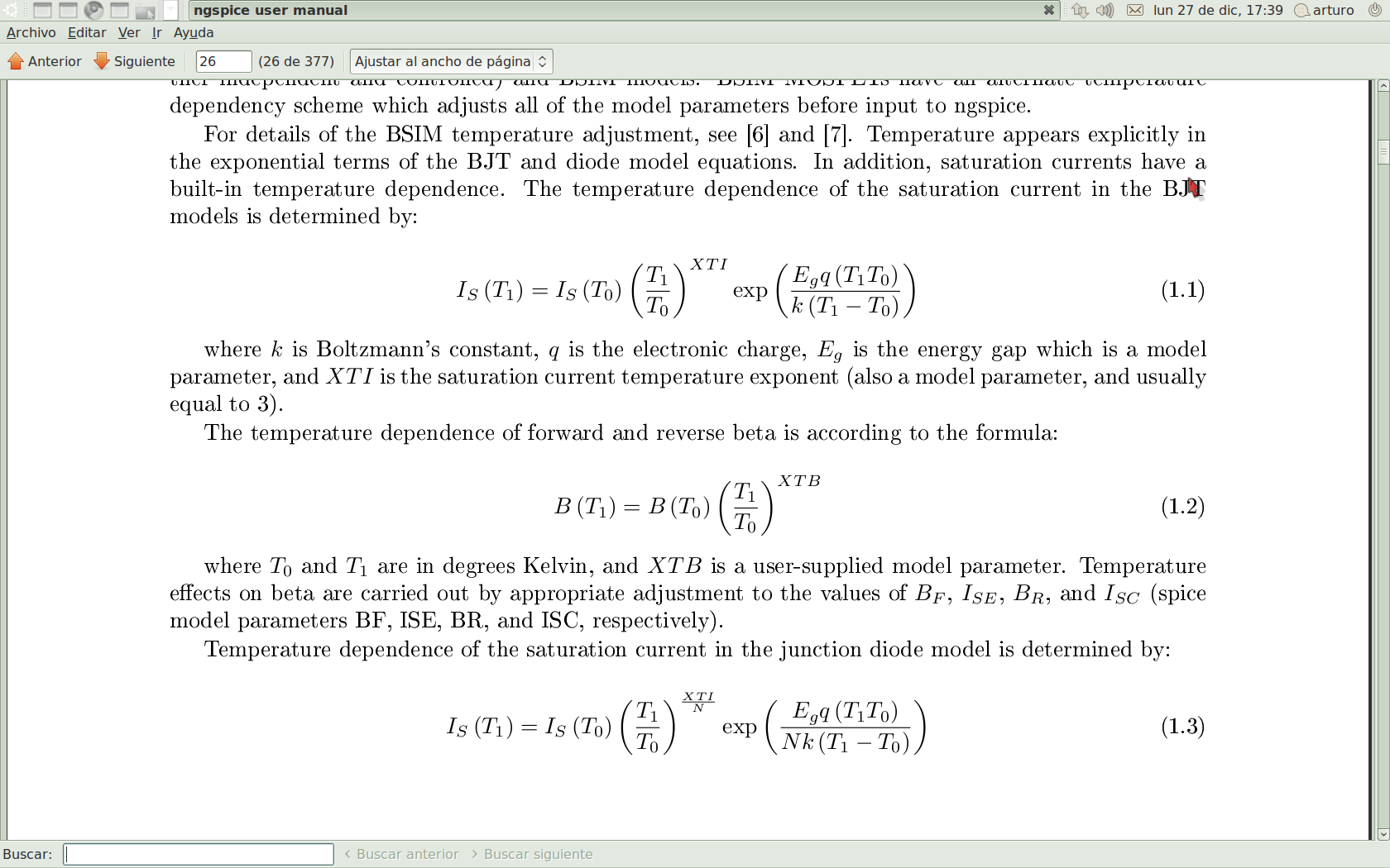

About SPICE and TEMPERATURE
Keantoken, no, SPICE does models TEMPERATURE as I pointed with the TEMP global parameter, even you can sweep temperatures with DTEMP, but requires in deep SPICING
example:
.options itl1=500 itl4=100 acct list node opts abstol=1e-10 reltol=0.001 gmin=1e-18 method=gear tnom=27 temp=65
here tnom is the NOMINAL temp at where parameters where measured (extracted) from the DUT.
and TEMP is the actual temperature of silicon resistors ....
Cheers
Arturo
