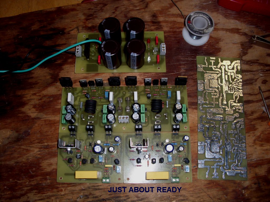

The Puppies are almost there (PS50 + PB60X2)

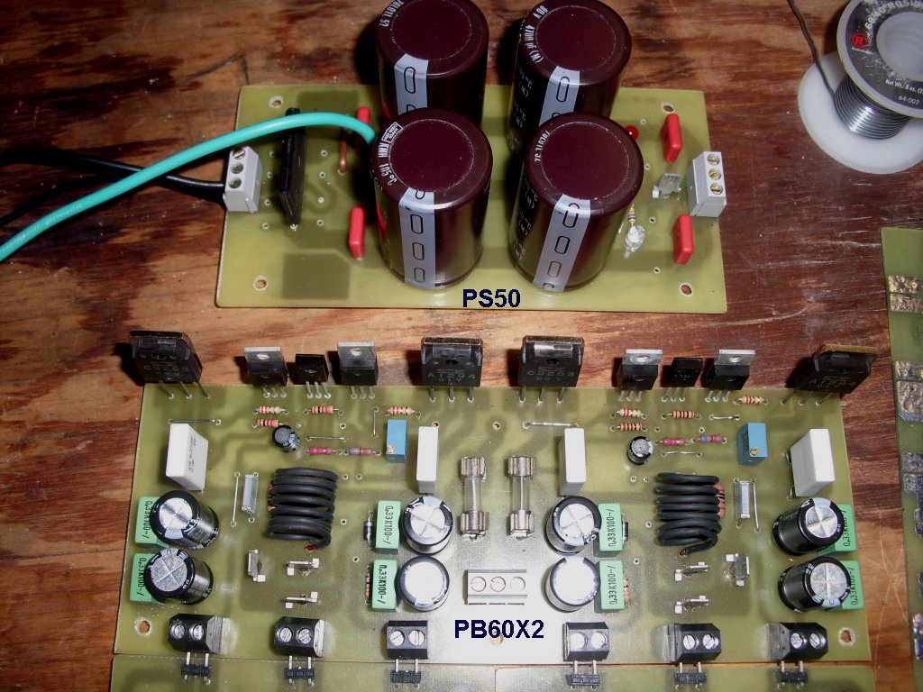

On another building "spree" , 2 of those (below) and I have a new 4.1 system (PB250H is the .1 😀) . On 1/1, the website will be back up with handy links (No more directory searching) and there will be so many amp projects .... All will be built and tested/ abused with pictures , Something for everyone.
Shown below (attachment 1/2) is the economical "mongrel" (under $60 power supply - trafo + 1 PB60X2 + 2 BX1.3's) , A full stereo 60w/ch BX and the small PS50 unregulated power supply is shown. I have just built my 23-24th amp in the last 6 weeks , so it is getting easy and better as I go along. Since I learned it on the forum , I might as well share it back. 🙂
I also must admit , watching MJL do his thing was both the example and inspiration for the 10-15 boards a night that I do sometimes (perfectly - no pits/undercut).

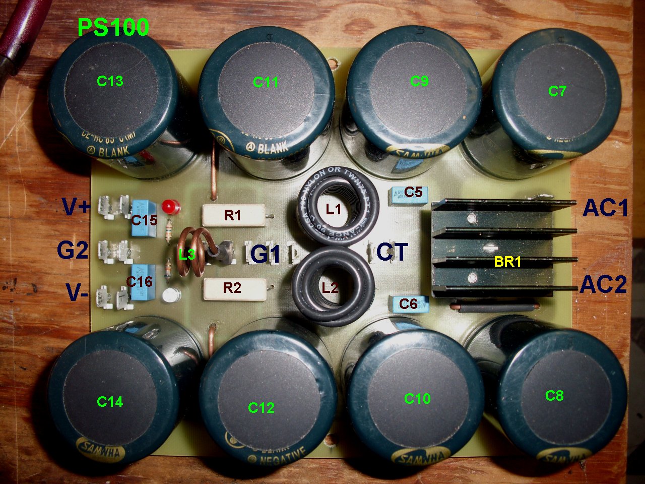

Nothing except reduce the G1 charging pulses to G2 by a factor of at least 4 , this was Andrew T's idea and it works (checked it with O scope). I should use a larger (longer ) piece of wire. This effect is seen at "nuclear volumes". If some one either does not like it or doesn't understand it , jumper the dang thing.. All I know I have 0 hum ,0 noise, and as much power as I would ever need. Here come the copz !! 😀

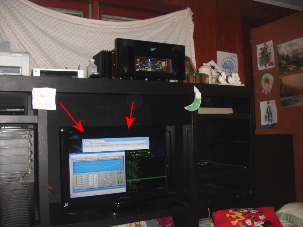

Thanks , john. I hope you understand I am NOT the GEB (golden ear brigade), and am even the sworn enemy of the "audiophool ripoff " . Better stuff can be had without silver wire and all that hoohaa. But some design decisions do pay off BIGTIME. I am playin' with my new years "present" (below 1 - that's my audio source)the kids never saw one of them (2 -listen to heart and trippin' on the graphics). 😀

Okay, but doesn't this also cause ground to "shudder" in relation to the rails? What was the problem? Also in your PS100 schematic, the resistors for the LEDs are unequal.
- keantoken
LED resistors , Ha ha .. so the blue ones don't blind you. 😀 Keen ,you speculate on the grounding ... it is superior. You can see the charging pulses on G1 , you move the probe to G2 you see much smaller ones. That's why I did it. I left the board "open ended" to just take a jumper in case andrew's advice was lame.
I was trying to actually reduce the scope visible pulses even as I was hum free to start with. You don't see these effects on "iddy biddy amps" but at 10A short term demands, you do. I like it LOUD.

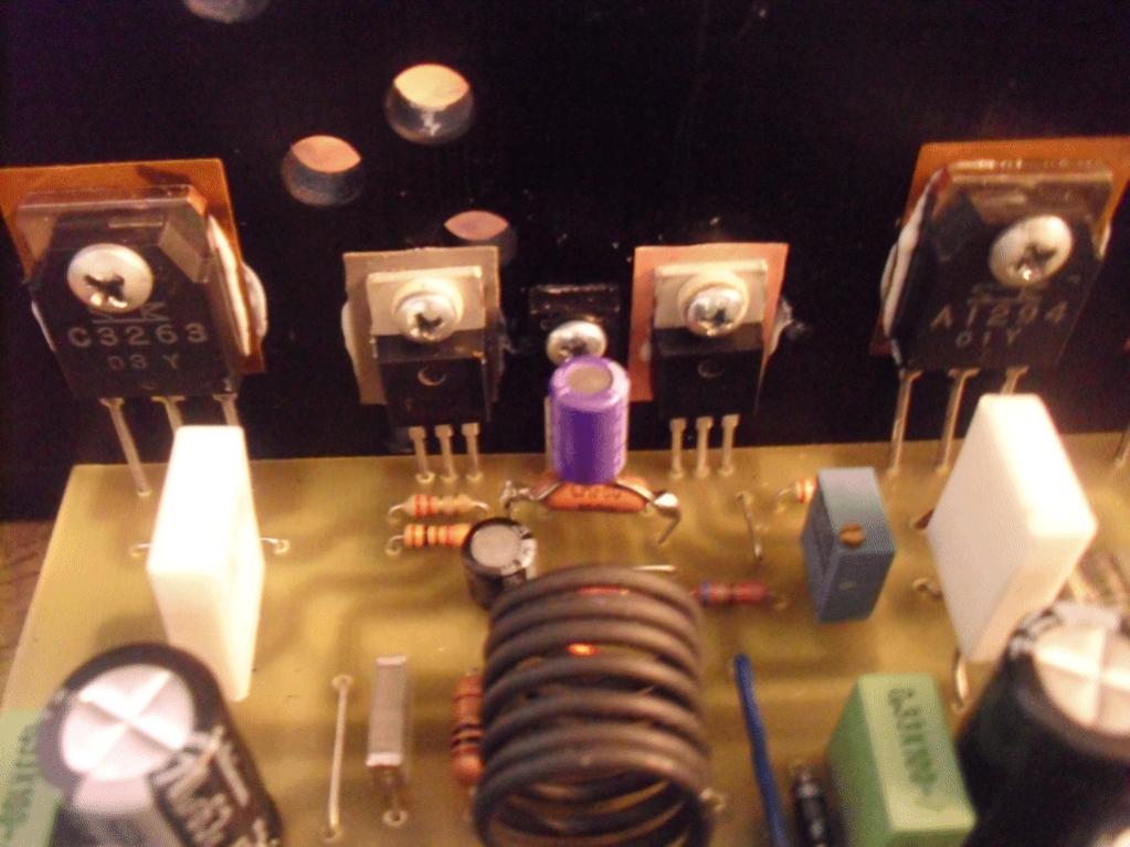

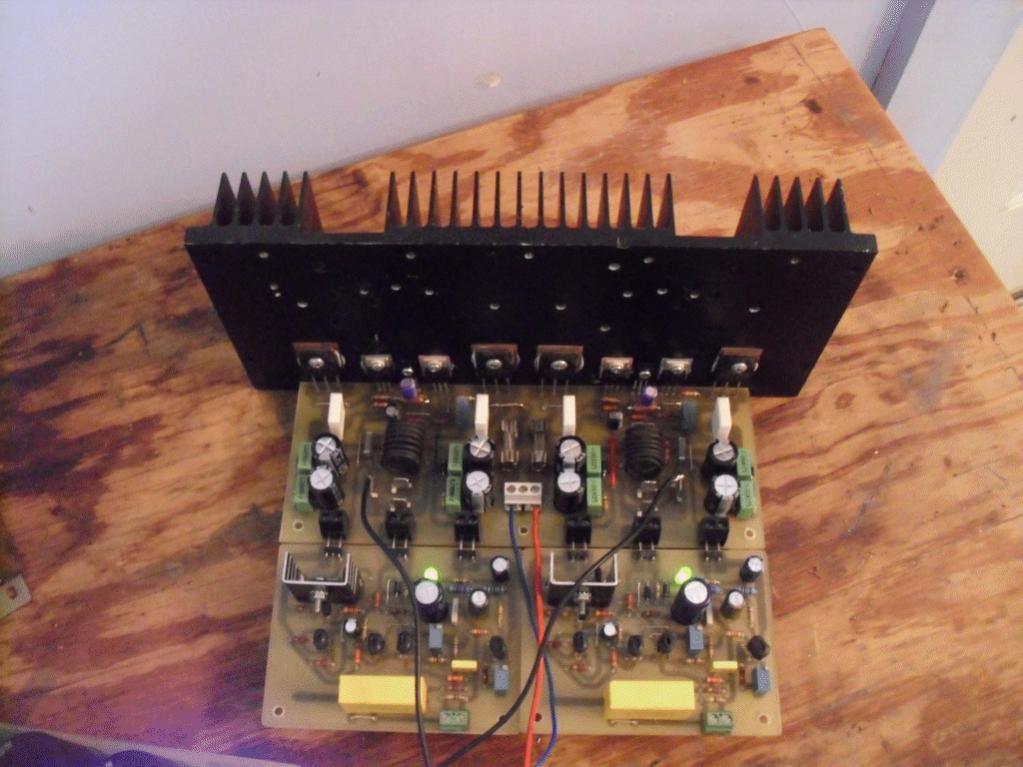

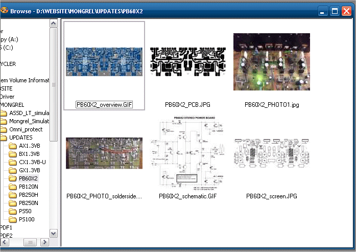

Our newest offering , the first one of 2011 .. is the "poor mans" output stage. Nothing fancy here , just a simple EF2 / Vbe multiplier and the "bare minimum" CRC to support any of the voltage modules. Ran the PB60X2 w/BX1.3 on the kitchen table (picture 1), clipping it and everything into a pair of 8" 2-way loudspeakers. A/B'ed it with a 80w/ch sherwood receiver ... NO contest. 30 visitors were in awe of the "poor man's DIY amp".
First time I tried the excellent Sanken 2SC3263 / 2SA1294 pair (picture 2) , they handled magnificently !! The "PB60X2 .zip" is a complete package (picture 3) with artwork/pictures/BOM , in the "mongrel Amplifier projects" folder (middle button) .
The PB250H, (my baby) is next to be released , it got the party test as well.
