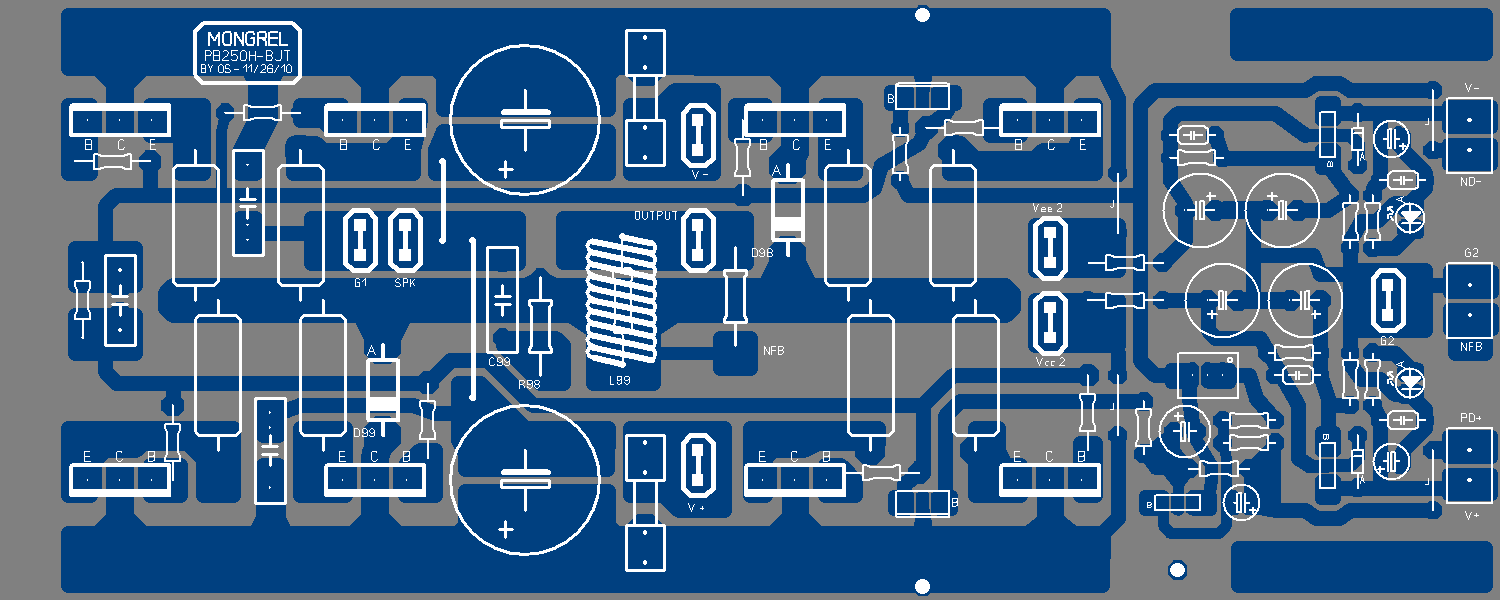

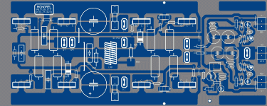

If you want the 250H (mine) .. it is below (2 and in .zip).. different layout...
That one has 10mm copper strips soldered on top of the massive rail traces(18mm). 125mm(5") heatsink required !!
I will complete the 250H package monday (BOM ,stuffing guide)
  • 250h_pcb.zip
    250h_pcb.zip

Can you provide a PDF file of this layout?
Unfortunately , I am OUT of $$ and FR-4 as of now (poor man). 🙁
Layout above in .zip is a perfect 600dpi 250mm X 100mm .JPG. I have found that a PDF is inferior to the original .BMP or .JPG. You could install the "bloated" adobe package and convert from the above original - it is directly outputted from sprint layout.
