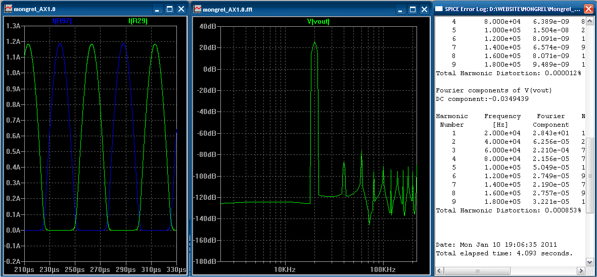

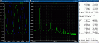

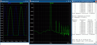

1. I believe (just an impression) that I would show a LITTLE bit more at low volume settings where the EF transistors work more in the transition zone. And for what reminds to me, in this case CFP would show some nicer behavior (at the cost of stability risk).
2. BTWI do not like EF3 or CFP3 stages for such power, seems unnecessary nowadays .
bye
effebi
Two good discussions regarding "choices". 🙂
# 1 . At very low volumes (pix 1-2) we are technically in class A , none of the outputs ever go below 5ma (never shut off). So this means the AX/PB250's "first watt" is pure class A up to about 10 watts/8R. No TMC signal is being fed back to Cdom , so this is the true performance of this amp "raw" . VERY impressive at 1k !!!
At 100W (pix 3-4) , my conservative implementation of TMC keeps the Xover distortion under wraps , increasing from .1ppm to a whole .4ppm(1K) , at 20 Khz it goes from 3 to 8 ppm , still quite acceptable.
#2 This is a choice of application , X-over THD get far worse at 4R and below , even with a greater "dose" of TMC. This can be negated to a point by using a triple EF OP and lowering the damping factor. The damping factor (or lack of) is what "sours the TMC milk" being fed back to the VAS. It is also of great concern that the slight gain of a CFP stage would destabilize TMC by creating to many poles in the OPS ( FF CFP loop surrounded by the TMC loop). I might not implement TMC on my EF triple as it will just be a sub amp anyway.
PS . the un- TMC'ed BX has about the same SPECS at low levels , but is slightly "bettered" by the AX at high output. :sing::sing:
OS
