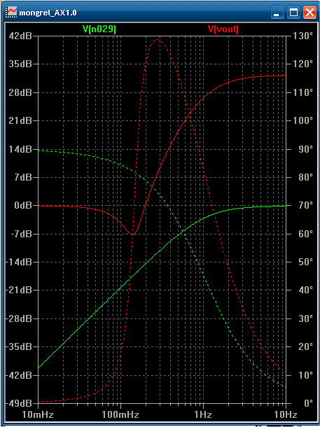

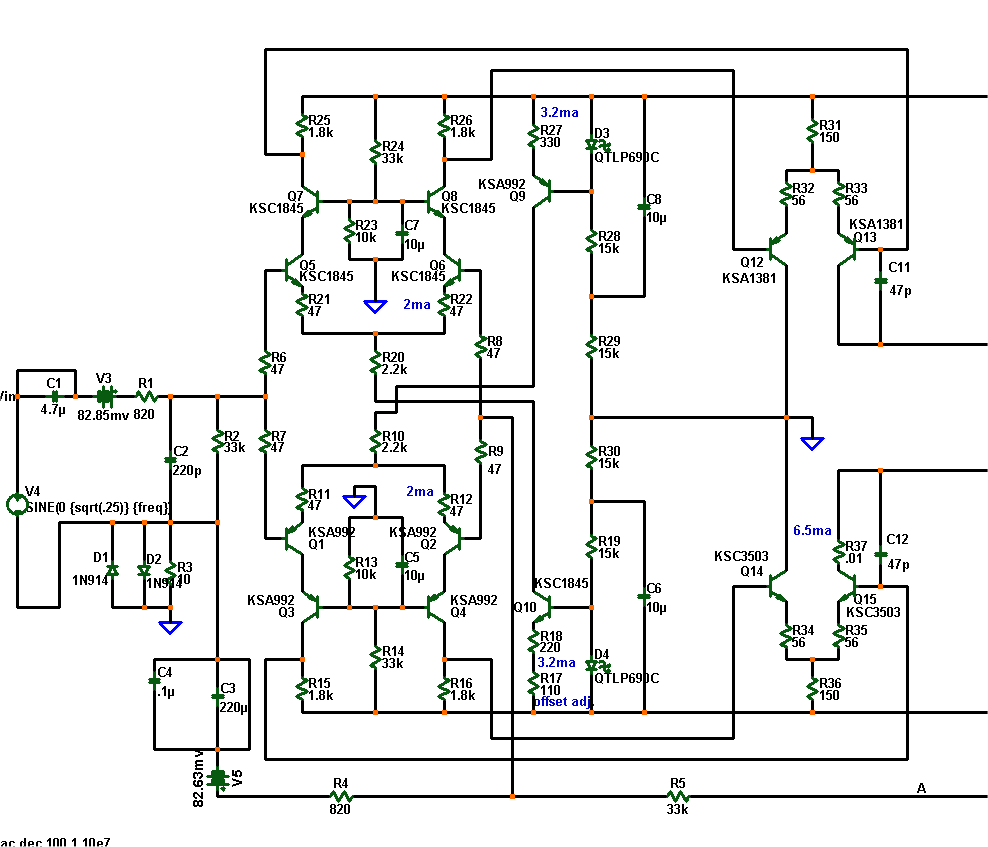

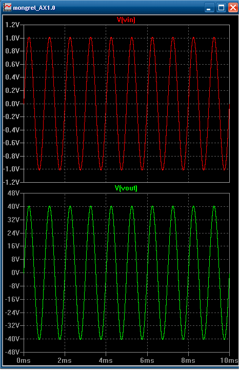

I've been looking at the AX/BX schematics just trying to make sure I understand everything (!) and realized I have no clue about the capacitance C3//C4. Looks to me like the purpose is to "AC couple" the feedback. I'm new at this, but I've read through Slone and Cordell, and I don't recall seeing this in either book.
So what's the deal ? Is it to keep feedback from screwing with the (precisely tuned to zero) DC offset ?
While we're demystifying things.....
The AC voltage gain of the amplifier is 1+R5/R4.
C3/C4 keep the DC gain equal to 1 to keep the amplifier from amplifying any DC offset.

(below plot 1) is the 40X gain of the AX/BX. {Plot 2} is the DC rolloff (green) of the blocking caps (C3/4) resulting in 0 DB gain at .2HZ at the output (RED).
I have "flopped" my woofers with my synthesizers at 2 HZ with -3db output. So these amps have a range of 2hz - 100Khz (-3db). 🙂

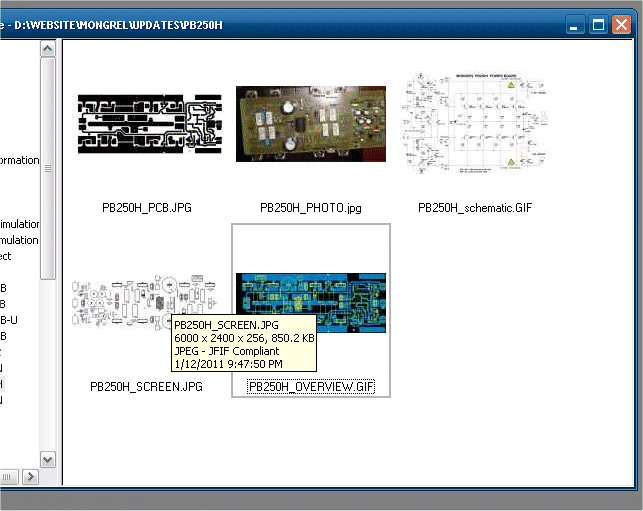

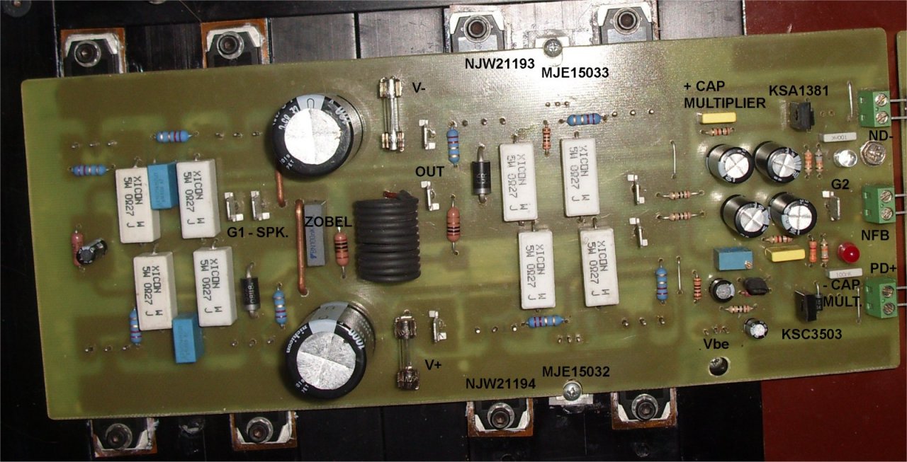

PB250H "my baby".... documentation done.
I have been putting it off , just sharing bits and pieces. The "best" of the modular power output boards is done (below 1). It is in the mongrel root as "PB250H.ZIP". I had to take my wires off to photograph it for the package (below 2).
This is the PB I do my final high power tests on. I have had the AX , BX , and GX , each running for a month or more , this nice piece of fr-4. After the voltage stages get a test run on the new PB-60X2 , they get the final "audition" here.
By murdoc- Do you have any recommendations for C1-C9 for the AX1.3VB and the Cs in the PowerBoard?
The BOM's are verbose. The best guidelines are to derate (100V caps) , low ESR. I use Nichicon , panasonic (excellent - from mouser) exclusively. Xicon and Dale power resistors. The only "made in china" part is the blue led.
The "AX" is the first one I will sell as a completed , fully integrated amp (Voltage stage -120W power stage- PS ... all in one) I will order 100 pro boards once I ABSOLUTELY perfect it 110% (I'm REAL close to that).
I have no regret's (I am satified - completely) on the PB250H layout. With the excellent NJW21193/4's and 20mm rail traces (soldered a 10mm copper bar all the way down them - like Nico Ras's "big booty amp" 😀) this PB is truly a "wire with gain". With these OP devices , 400w/4R is well within the SOA (DC SOA @ 65V is almost 10A w/ 4 devices) safety margin of this amp.

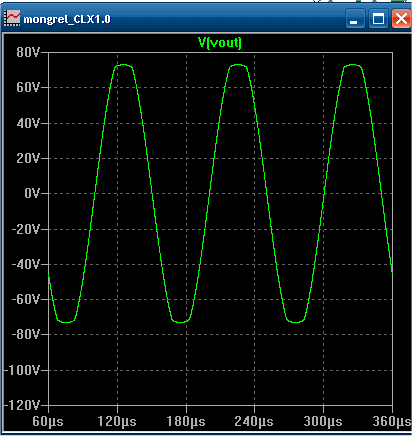

Hi , artu. I hope you don't think my "version" of your killer amp is the joke of the day. My simulator tells a different story. Mine stays at .001% to .002% THD, ALL the way from 100hz to 40khz. This is short of the "AX" , but the distortion spectra and clipping characteristic's are what I'm after. Below (pix 1 - 10k FFT)
and (pix 2 - clipping). I'm satisfied with the 100V+/uS slew as well with my 47R/47pF degeneration and compensation.
This amp is really a blend of tilbrook's aes6000 and the leach amp. I foresee it as a good subwoofer amp because of the well behaved clipping. It may also sound very good because it's spectra looks more like a single ended amp (the BX) , so I may like it to drive my new speakers (tweeters and midrange's) as well.

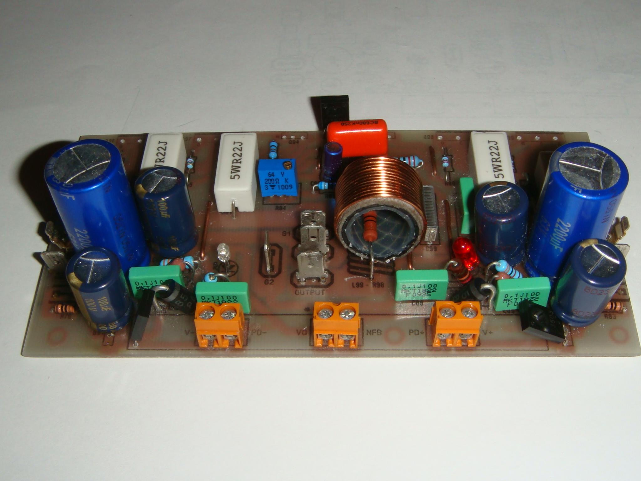

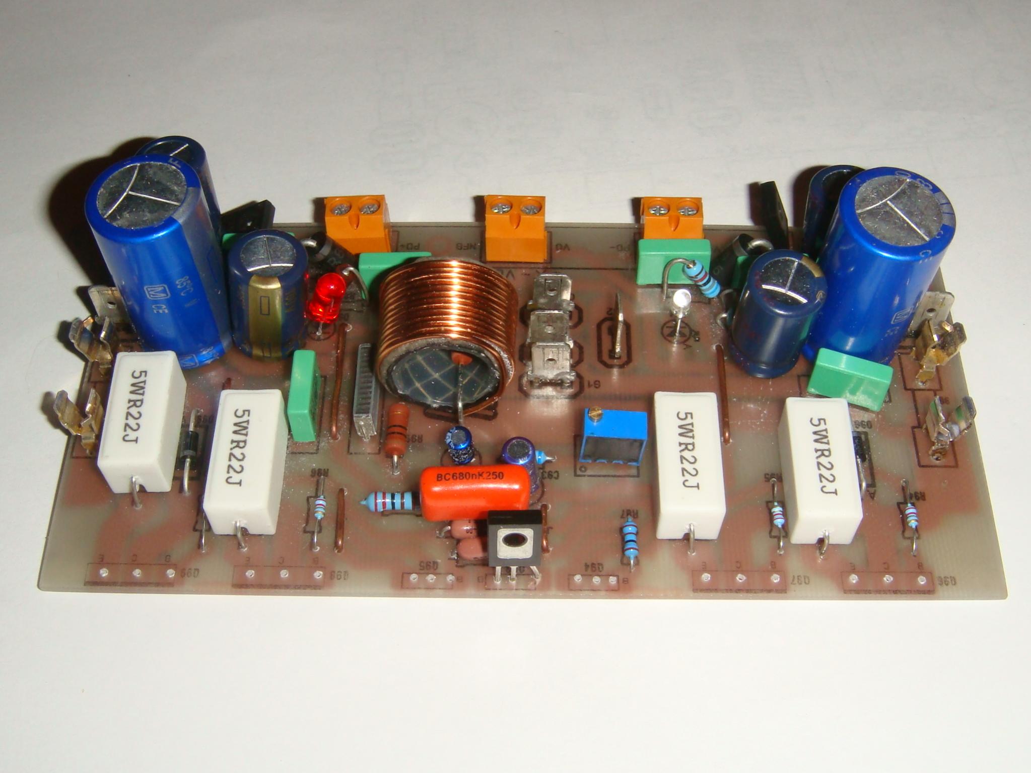

Having trouble with PB120N
The 2200uf caps are too big to fit in the provided space on the board. I've had to relocate the surrounding caps on longer leads and bend them out of the way to get everything to fit as well as redrill some holes for the caps.
It should work ok but looks a bit untidy.
The 2200uf cap is only 18mm diameter, which is the smallest available.
Also the silk screen for C85/86 and C87/88 are reversed.

First you have the big diodes where the small diodes should be(d98/99 =big). You can use 63 V caps for this PB. Also 47uF can be used for the small electrolytics and 1kuf can be the big ones. At 2 X 47u the cap multipliers will still emulate 4700u with a transistor beta of 100+. Thanks , I will review the 120 "package". 😱
