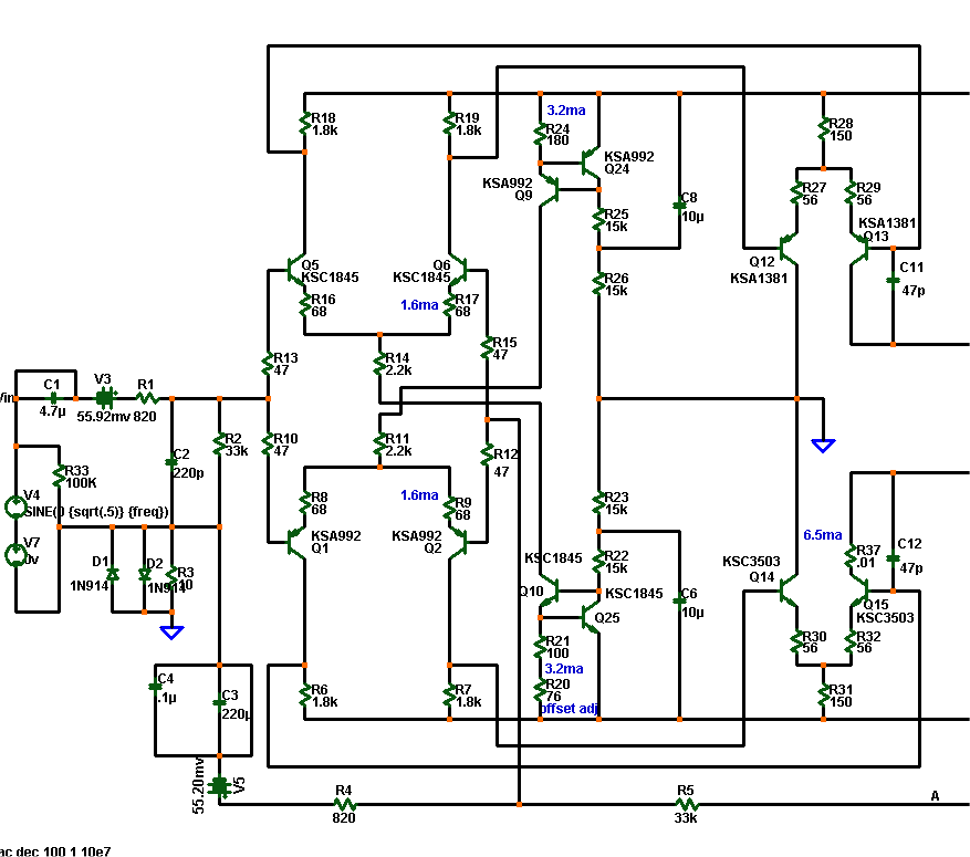

I trade the "silver cable blessin' " for more amps. 😀 I just completed the CLX , EX , and LX (below 1-6). I guess I do this both - "because I can , and because I want to"... 😀 (not to make better amps). Still , they should perform well. My first adventure in fully complimentary topology , the CLX/LX is a draw between the Leach VAS (LX) and the artu/tilbrook (CLX) VAS , performance wise. The leach does have much tighter current regulation in the VAS (pix 7).
The EX is another symasym , I just want to see how it will perform in it's purest form (Sigma - by dr. bora). As can be seen , I am using Rod Elliot's KIS technique , "Keep It Simple". All these are no PPM amps , but have monotonically "correct" FFT's. (pix 8)

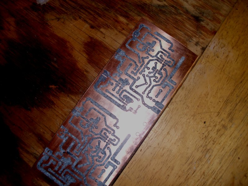

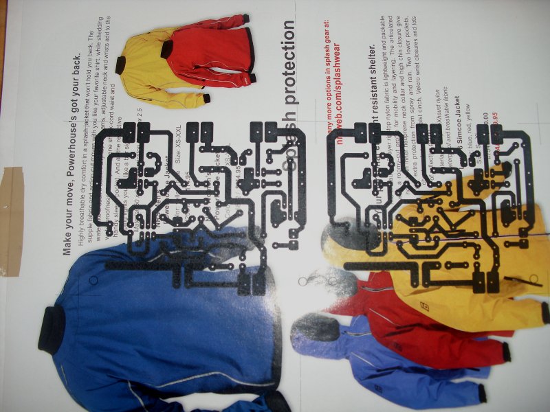

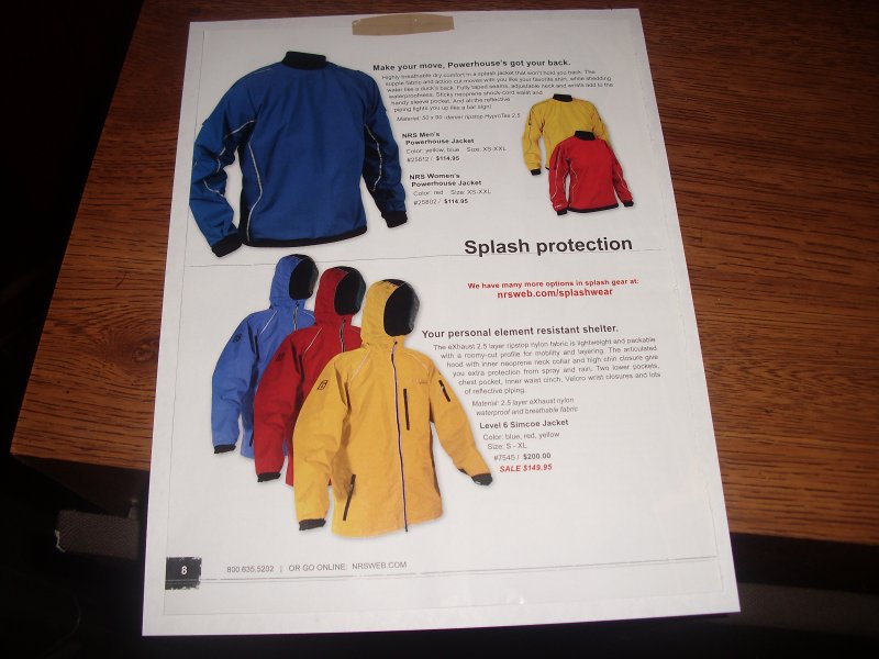

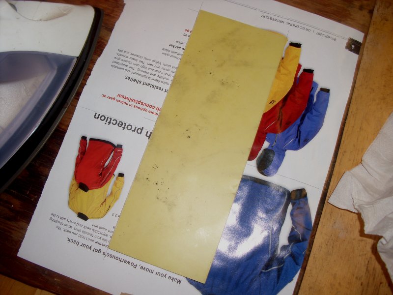

That was the point of my post... For the same $40-70 , I can get to the 99% perfection of the kit. I can also build a whole lot more , a 1/4 sheet FR-4 (24 X36") is $80 . I could get a lot of amps from that.
Just the laser printer , glossy mags , Iron , gallon of HCL , a quart of H2O2. 😀

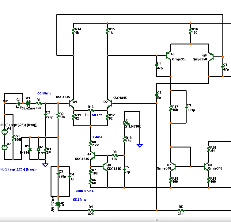

A "realization" just came to me listening to the BX (carlo's clone). I plugged them into a cold amp , they sounded grand. After an hour , as the amp warmed up , I noticed the sound was not "as it was". I noticed the bias creeped up to almost 100ma/device , the BX has a different VAS current than the AX. I lowered it back to 12mV/50ma ... the sound was again "right". I never heard this on the AX , even with under or over bias conditions. TMC must be both negating both the GM doubling and the underbiased Xover artifacts in the AX , I hear no difference from 10mA to over 100ma.
Are you peddling TMC as the new Vanishing Cream ?
Anyhow, is this simply a case that the better sounding option has more OLG available to 'correct' the consequences of the bias error - the TMC is just extending your OLG to higher frequencies and any approach that did the same thing (such as more native OLG without two pole compensation) would be just as effective ?
Why is the bias creeping up to 100mA - something isn't working ?

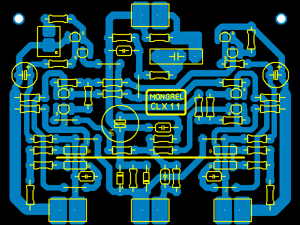

Atta boy! Now you are learning 😉
(pressed down too hard , but it will do)
OS
Looks great OS! Nice to see silkscreen on there. Making them look more pro will definitely improve the sonics!

Cold amp , and carlo's BX clone does not have the rock solid CCS that the AX does (different standing current). Also , I just "plugged it in".. didn't check it.

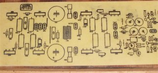

I did this for 2 "backwoods" reasons ... First "because I wanted to", second.. so I would not screw up if I stuffed the boards while drunk or stoned. How they sound ??? They all sound good with enough grogg.

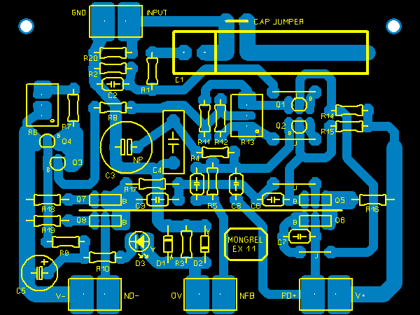

There already is one (actually many) .. Toner Transfer Walkthrough

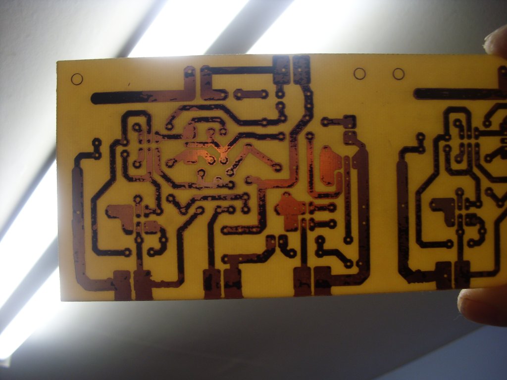

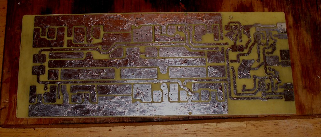

I just did this with the magazine. Comes out better every time. (pix 1-6)
I even screwed this one up and it came out near perfect.
OS

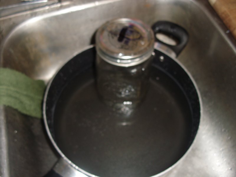

In pix 5 do i see an aluminium pot ?
Do no use etchant in an aluminium pot try to find a
Do no use etchant in an aluminium pot .
Thanks for materials primer , but the pot was just to heat the acid/peroxide mixture to 40C. The Glass jar is what contains the mixture.
The hotter you get it , the quicker the etch (don't go overboard). My "mix" is 1/3 H2O2 and 2/3 HCL. That equates to about 75% H2O , 23% HCL , and 2% H2O2 since neither ingredients are pure. Ace hardware muriatic is (67/33-HCL) and Walgreens peroxide is (97/3-H2O2).
BTW , I use a polyethylene tub and agitate by hand (like pannin' for gold).
OS
