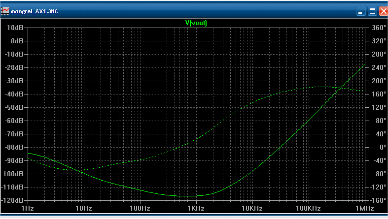

Did you investigate the clipping behavior of the AX1.3? i just simulated it (as a background task at office) and see some nasty clip for 1.9V input. Seems that Q10 is saturated.
Hope this helps.
Impressive THD anyway!
regards
Laurent

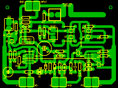

In post #1193 I suggested to layout a PCB that comprises both the MONGREL AX frontend and the PB250 backend.
I did the layout myself. 😀
Here it is:
The dimension of the PCB is 235 x 125 mm.
I wonder if Pete likes / approves it.
Best regards - Rudi_Ratlos

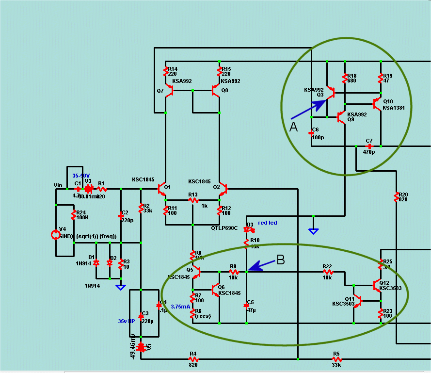

Working on just that ! Cordell's VAS "active shunt" solves that problem (below 1). Also, the AX1.4 will be TMC / TPC /CMC ** universal. I did saturate Q10 on my 45v setup , It did not get warm or let magic smoke out , BUT ... replacing the Q9- 220R collector resistor with Cordell's transistor (A/Q3 - pix 1) is foolproof. If more than 13ma is passed by R19 , Q3 will shunt the base of Q9.
Also , the AX made a "tick" (small thump) ... this was because the VAS CCS stabilized before the input stage one did. Solved this by tying the 2 current sources together (B- pix 1). (Below 2 ) is the universal layout for the compensations , note "LC" and the 2 "TPC" pad groups.
I was told to make this circuit 110% , so be it.
"Impressive THD" , Yes at 40V p-p ..... at 80V still good. By using a 3Q wilson mirror at the input stage , I could achieve .4PPM @ 1k - 100V p-p. I am debating whether to do this for 2 reason's, #1 - the increased impedance of the wilson and #2 - how much more perfect does this have to be ? 🙂
Another decision is to whether to leave the cascode , a pair of 2sc1845's are plenty quiet by themselves. 😀

Nice work, Rudi ... you might want to incorporate both "improvements" before you build.

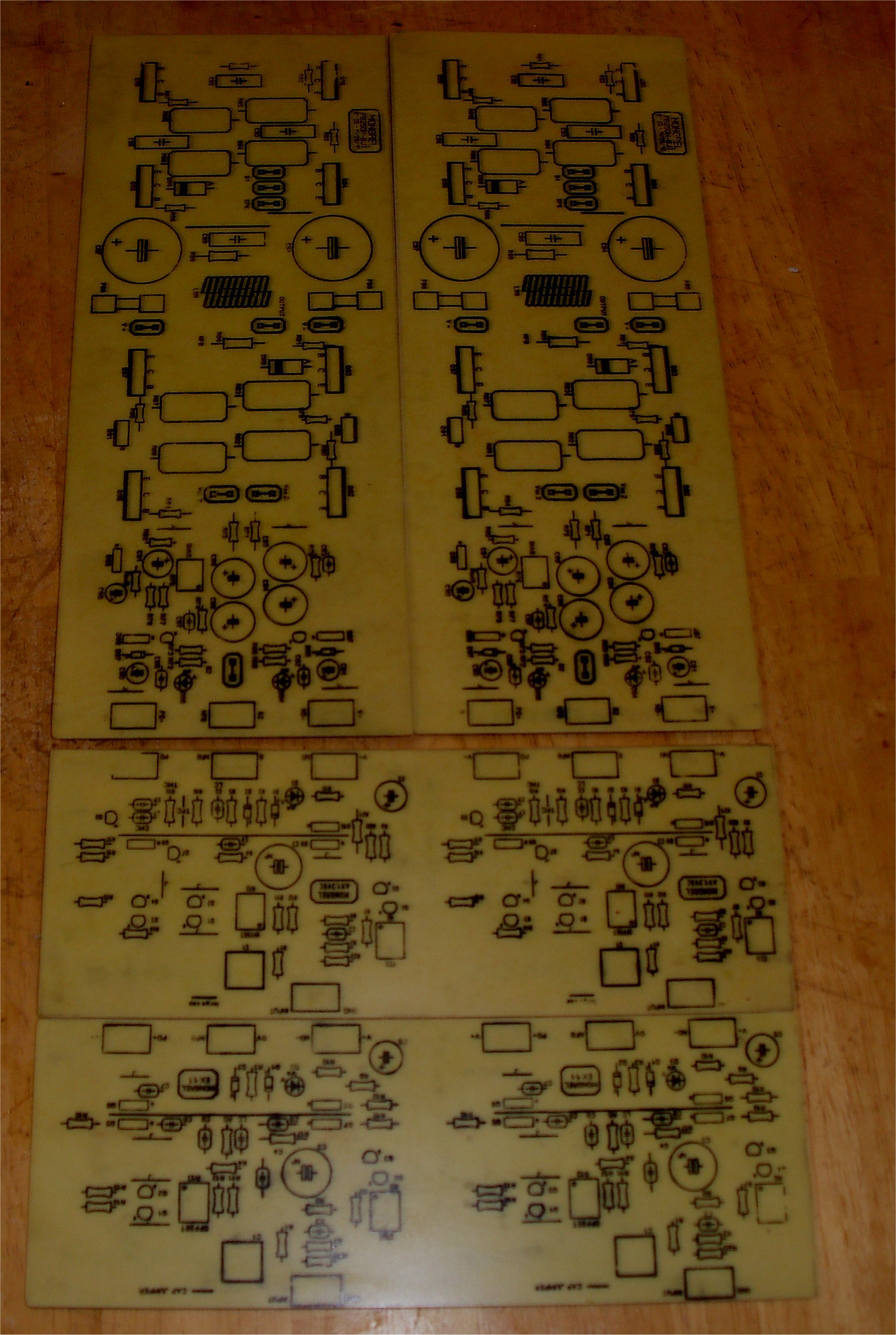

Will there be a update to the AX PCB Layout soon? (regarding the 1.9v clipping...)
Im currently waiting for more Presensitized PC Boards from my supplier before im starting on making those AX boards. Just received 2SC2240 and 2SA970 transistors a couple days ago. Only missing those boards, and 1k trimmers(only have 2k and 200r) and C92 on PB250 board and then im ready.
Done with the PB250 boards by the way, their only missing the AX board and C92 and they are ready to go! 🙂

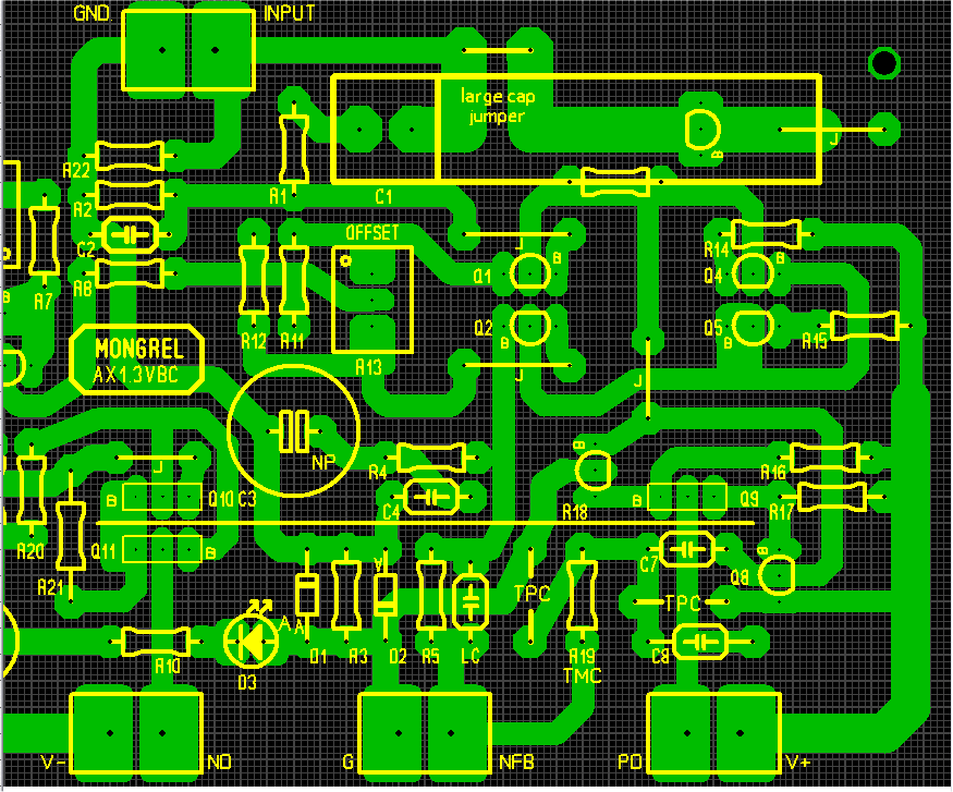

AX 1.3VBC
I still need the parts , but it should work. the only differences are the way the CCS's get their reference ground , the lack of a cascode , and the Cordell safety device (Q9). (Below) is the artwork (zipfile) and a pix of the results. I have tested these changes on the real one by "point to point" (cob jobs 😀).
Also , CMC , TMC , and TPC compensation is available , read the new Cordell book or the negative feedback thread. This amp is close to his example , but tested in the real world. I will just add this as a variant to the AX package as it uses ECB standard 120 Vce input stage devices (keep it simple).

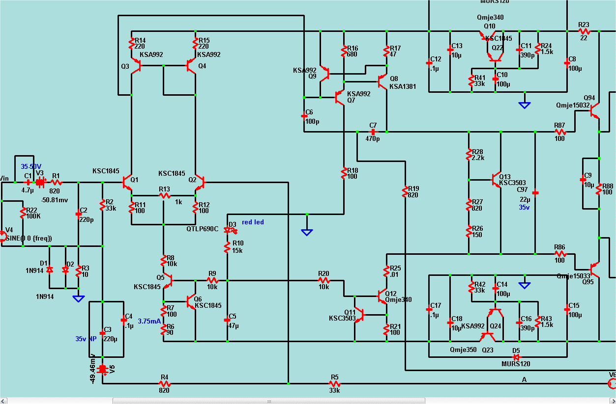

PSRR - the next level !!
THD is important , but PSRR is just as much a distortion mechanism. It also has a second effect to give better separation .. hence , a better sound stage. Since I have been using cap multipliers , this has been quite apparent in my listening experiences. (Below 1) is the best performance/simplicity ratio (circuit wise) I have been able to produce. Some would "go the mile" and use a fully regulated supply , but by looking at attachments (Below 2 - OPS /3 - input stage) , you can see we have stellar PSRR. Even at the output , this is more than adequate. 🙂 I have only added a darlington to the multiplier (MJE340/350 - ksc1845/ksa992) , this improves the multiplier by 100X , the only downfall is a greater BE drop (2V+). OH WELL !! The price you pay for performance. 😀
