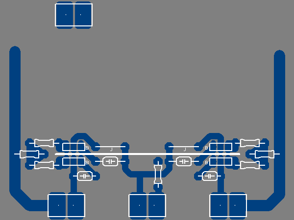

Cheers for the board layout, its hard to believe that there will be such dramatic improvements over my current GX. Can't wait to here it.
I have nearly finished my BX boards to try as well, just waiting on a some transistors to arrive.

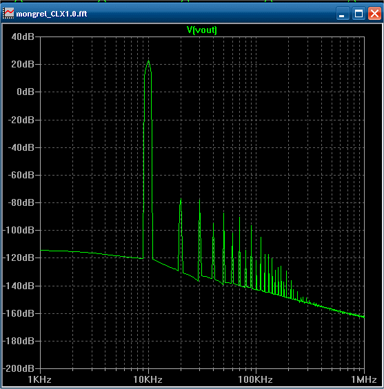

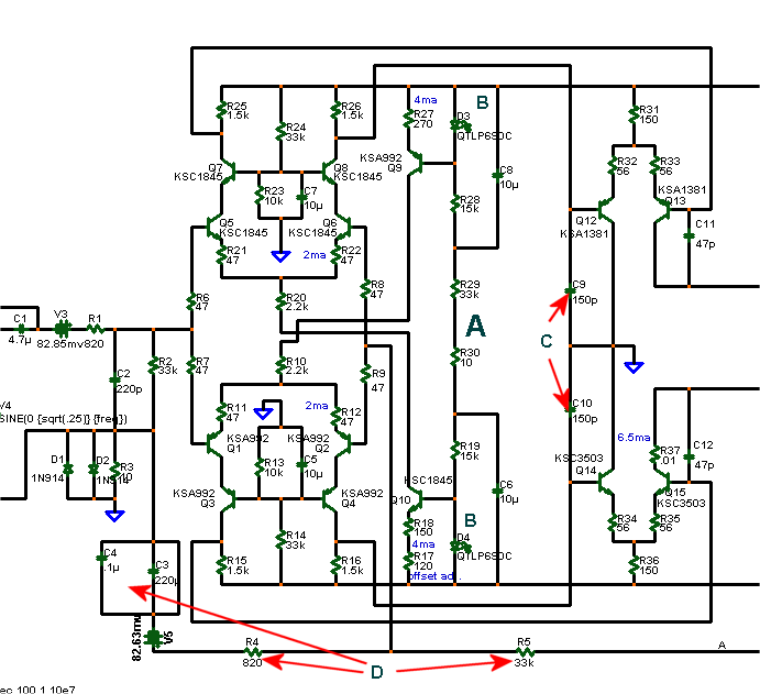

On to amps , I must concede that Artu's VAS (I am not sure it is his ?? ) and the design "RULES" . AX might have lower PPM , but the CLX (below 1) has the best FFT (below 2) and holds it to 100k (125+ V/us slew as well). On the
Schema below " A" ... should I reference to earth or the rails ? "B" should I use (keep) the :xmastree: merry LED's as current sources or upgrade to my usual 2 transistor deal. "C" "backend" compensation caps , with them a slight lack of phase margin at UG , without them all is well. 😕😕
"D" - I use standard full AC coupled DC blocking/input , a DC servo will have little effect. I even subbed out the IPS PNP's with a known mismatched model, offset stayed under 10mV. 🙂
Artu's design has a super low impedance NFB network and fully DC coupled , ABSOLUTELY needs a DC servo circuit . A 14 transistor voltage board will not be a "brain breaker"(below 3) , still DIY friendly - super symmetrical . C2C , this may be the "ONE" for you. (8PPM@ 100-5k / 12PPM@10-20k , and 50ppm max@even 50-100k !!) 😱

Shouldn't C9 and C10 be referenced to the negative rail? As it is they are adding interference between the rails and ground.
- keantoken

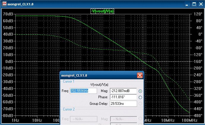

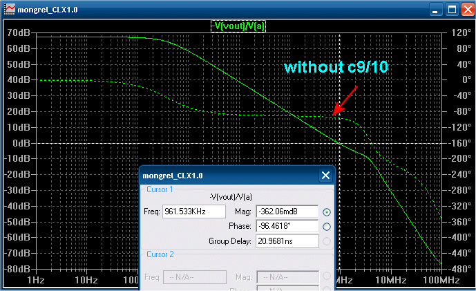

Those (C9/10) don't decouple. I wan't artu's opinion on their purpose. What I did find is that they DO roll off HF response (I think artu stated this). They also decrease phase margin( below 1/2). I am covering all bases on the associated board , one can just omit c9/10 or add lead compensation to "fix" it. 😀
I must also see if they (C9/10) increase PSRR of the voltage stage. Regardless , 10X better than either the leach or symasym voltage stages and super stable w/either compensation scheme.

I thought they may be a way of decoupling Cob/Miller effects, but they are on the wrong side of the VAS for that. If not for open-loop phase-shaping purposes, perhaps it is for decoupling of parasitics somehow? Wait, maybe it's to make a limit for OLG, so that the gain-bandwidth is at a controllably low frequency. I have had to do this a few times after adding parasitic inductances to my simulations.

the C9,C10 capacitors
Ahh C9, C10 ... very important, Os you are close ... indeed they do rolloff HF,but the mechanics is little bit more complex, I will try to explain succinct.
The VAS is differential to some extent (at audio BW, and additionally enhances THD), but at high (critical) freq. changes it's behaviour. Each leg has its own 'natural' freq (far above audio) s1 (C9,C10) and s2 (VAS driver with Cdom) where s1 < s2, and are emitter coupled (both 'competing' with very low impedance). To show it with a simple analogy, it is like Formula 1 suspension system, to coaxial springs each on with it's own natural frequency one interferes (dumps) the HF oscillations of the other. Another benefit is despite that the common collector has much low Miller parametric FB capacitor (than a common emitter), it helps to the stability of this leg. With this arrangement you can use less degeneration at input (> OLG, better THD trough BW) and also reduce the 'brute force' BW limiting Cdom. To exploit this feature optimally you should strip out the degeneration of the VAS (tying both emitters directly). Another source of stability (and less noise) in my design is the super low FB loop, at the cost of offset as you correctly pointed. An additional warning is that even a AC decoupled loop scheme, the sims does not take account thermal imbalance which indeed could produce a significant offset.
Cheers
Arturo
BTW this VAS is mine, maybe others discovered before me, but I haven't seen in the literature.
So if I understand correctly, C9/10 reduce the impedance of Q12/14 as seen by the Q13/15 emitters. This has 2 effects:
1: Resonant and corner frequencies are different, eliminating resonance and negative impedance problems.
2: The impedance at Q12/14 emitters has a shorter current path at AC, reducing stray resonances and interference. You could say Q12/14 act as C-multipliers for C9/10.
- keantoken

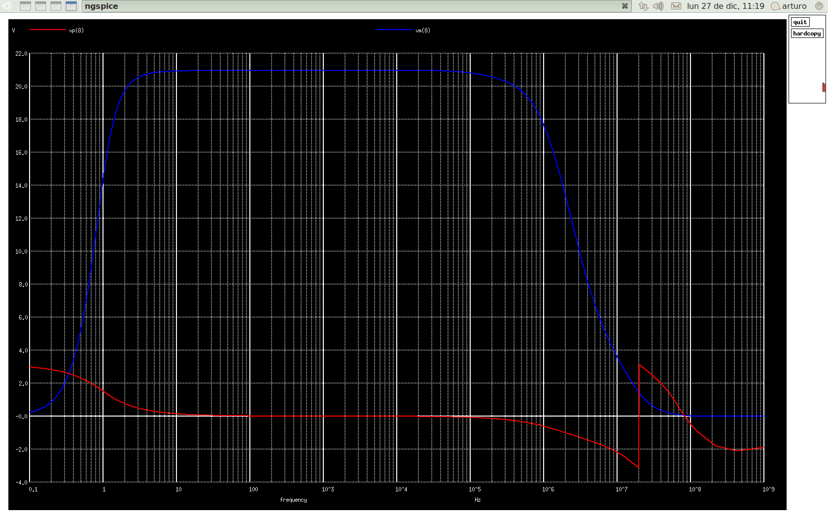

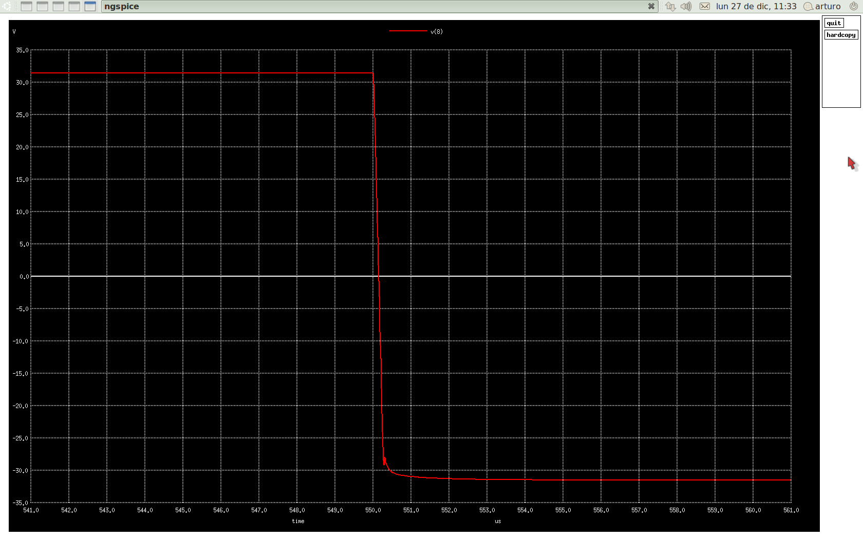

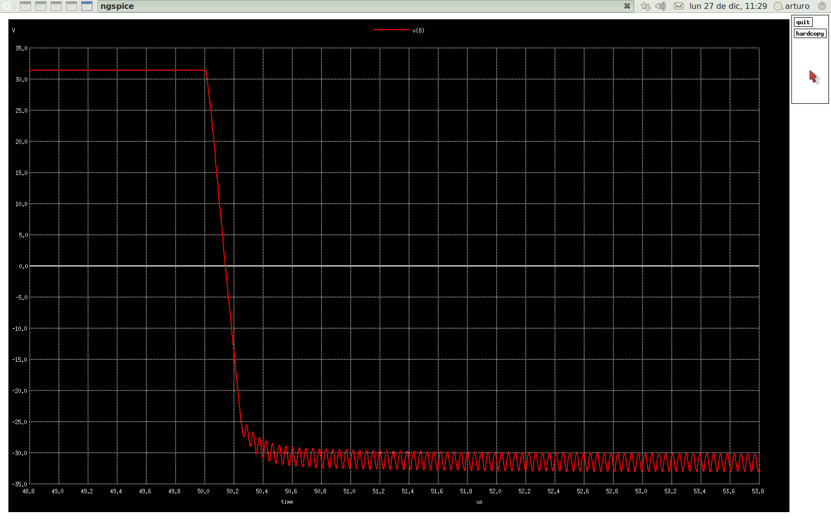

Yes Keantoken, you are right with 1) as a principle (more complicated to explain in detail that what appears in the surface), maybe the sims with LTSPICE regarding spectrum analysis are done at very low input signal amplitudes, doesn't take account of non linear effects at high input amplitudes. Also the two circuits OS and mine despite their apparent similarities are different. Point 2) is no, stray resonances are other issue, and Q12/14 aren't C-multipliers, the cascodes isolates the input so the load network can be abstracted as a pure RC circuit at input Q12/14 (it is in fact is a mixer with Q13/15 !!! ha ha ...). I show the effects attached, without and with the 'so called' HF dumpers. You'll discover that the reduction of BW and slew rate (>200V/usec) are negligible. That's why among other things I could squeeze this thing at unprecedented limits.
1) ringing instability at high dv/dt
2) ringing colapsed with dumpers
3) power BW instablity (the peak) -> unstable amp
4) power BW stable with dumpers
Cheers
Arturo
