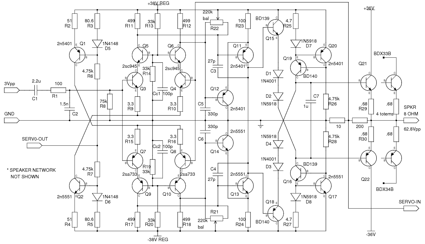

Andrew,
Take a look at Arturo's amp which I have attached.
You know a thing or two about amp design.
Now examine Arturo's design with care and tell me with confidence that he is in clear error concerning thermal drift and output offset.
I think you will realise that Arturo is an exceptionally talented designer, and this design covers just about every base in linear audio amp design. It is smart to know where he is coming from before you comment critically.

Hi, Hugh
There s nothing to criticize over this topology, and it happens
that i use one that is close, although with a different general
design stand point, but what about its implementation ?..
Have you made some sims about it to have a look at its behaviour?..
If you had done so, you should have noticed that the input differentials
degeneration is way to weak, with a high transconductance,since the
tail current is about 12mA...
Their values should be increased significantly as with 3.3R, it will oscillate
with certainity, unless the comp caps are significantly increased
from their current 27pf values that are low considering the input
stage current capability..
The differentials CCS reference voltages are slightly floating since it allow
the DC servo to control the current through the references.
A drawback is that DC variations will change the reference voltage,
leading to variations in the tail current, thus output dc offset will
be varying with output loading while the dc servo will be way too
slow to control this dynamically tighted offset...
cheers,
w

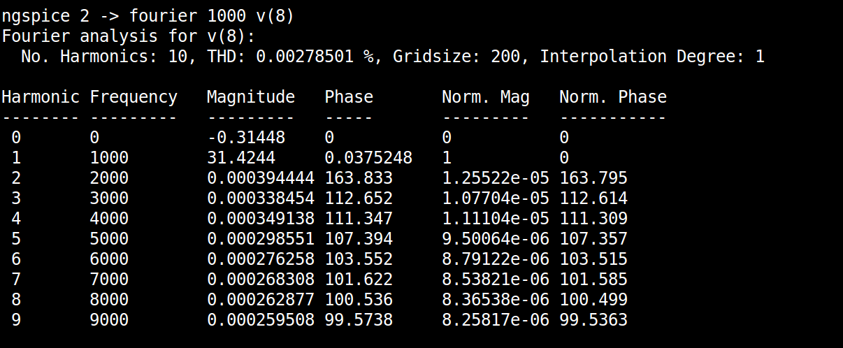

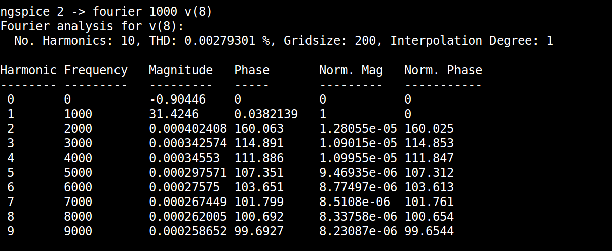

Hi Wahab, (I am the author), the amp is stable (in theory, as I am building it and will take me a while to bring it to real), I simmed it very carefully in several different conditions (even adding lumped parasitics at critical points, and models imbalance), clipping over the hole BW (1 - 10 MHZ), with input signals 150% to 300% the maximum normal which is 3Vpp, and with ridiculous hign dv/dt. input impulses. I short I can say that the 330p caps acts as high frequency dumpers and improves ac stability, without sacrificing too much bandwidth (and distortion), and allow to use a very little degeneration which also improves overall distortion and allows such little Cdom 27pf as you pointed, that way it can achieve 200V/usec slew rate. The DC servo acts mainly biasing thermal drift (also simmed with very low frequency asynchronous signals), but in some way you are correct, it is not perfect, the circuit itself is stable in DC conditions, so the floating condition of the CS's is limited. I can send more detailed information if you wish by other means in a document I am working, but it will take me a while.

I have found that amplifier stability is not always guaranteed through simulations - unless you have wide design margins (and don't rely on an 8Ohm load in your simulations, add 10nF of capacitance go ground for example). Some on-the-bench adjustments to compensation are often desirable for tuning the sonics too.
Yes Bignum, I've also used several complex loads (speakers models), but you are right, simulations are not perfect, anyway I have a big room to avoid unstability, with too much sacrifice it's inherent goods, that will be verified in practice, my take is that it will be very close.

Hi, Artu
There was no pun intended, and anyway, since i prefer
this kind of topology, i can only encourage you to go in
that direction.
That said, if you are building it, just be carefull to increase
the said degeneration in your first live tests, one never knows..
As for other details, contrary to the one mentionned, they will
unlikely prove dangeourous with a real implementation.
Cheers
w
