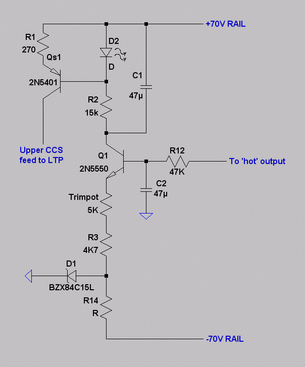

Here it is:
Hope this explains it.... For 11.7mA through R14 with 70V rails, you are looking at 4K7 2W (645mW dissipation).
These values place around 140mW dissipation in the half watt 15V zener, which is lineball for long life.
Hugh

Here it is:
Hugh

Yes, this circuit features on my NAKSA 100, and controls offset very well in the face of some fairly strong thermal drift.
Like you, I prefer not to use ICS because they require a bipolar power supply, and this is tricky to lay out on a wide pcb.
Hugh

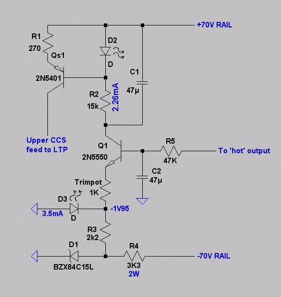

Pete,
I have done the servo again for more current control, since the LED current range required to give a decent variation of the CCS output could be quite a bit more than I'd designed for. Accordingly, an updated version is attached, with much more range.
Perfection is great, but of course you also have to balance it against complexity and cost. I gun for <10mV these days.
Hugh
Hugh just a little question, the behaviour of the servo when clipping?
Well I am not biased against IC's and not so convinced about PCB area issue, also you can do a +/-15V form the +/- power rails with a couple of zeners/resistors, the beauty of IC's is the high CMRR that makes them virtually immune to the power ripple. High end amp also needs FAST speaker protection (a crowbar ...= additionally PCB & circuitry).
So, why not go Mercedes Benz ???
Hi Arturo,
Ah, clipping, always a tricky one!
If positive clip is longer than one time constant, which here is 2.2s (and indicates a LATCH, a serious condition) then base steadily voltage rises to 63% of rail, very quickly passing more current through the transistor and quickly chopping out current in the LED. At +0V6 on the LED, the zener goes into conventional conduction, limited by the 2K2 resistor, but a steadily rising current which won't do much damage. But, a rising voltage across the LED at about 5V will likely destroy it, so a 4148 diode in series with this LED would be a great idea. As for the CCS, it will start to generate high currents as the LED voltage reference is pulling high current.
If the amp clips negative, it will pull the servo device base down, carrying the emitter with it whilst current still flows. When servo emitter drops below -2V, the device will stop conducting, and no current will be pulled through the CCS reference LED. The CCS will then switch off.
Yes, things are not wonderful, Arturo, BUT, if the amp is clipping to this extent (holding rail voltage for more than half a second or so) it will be latching which indicates severe design issues in the amp.
Possibly more work needs to be done here, and an IC servo might be better behaved in these situations. We could limit the range of input to the servo base with diodes, that might be useful......
Hugh

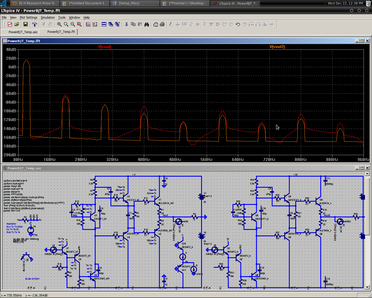

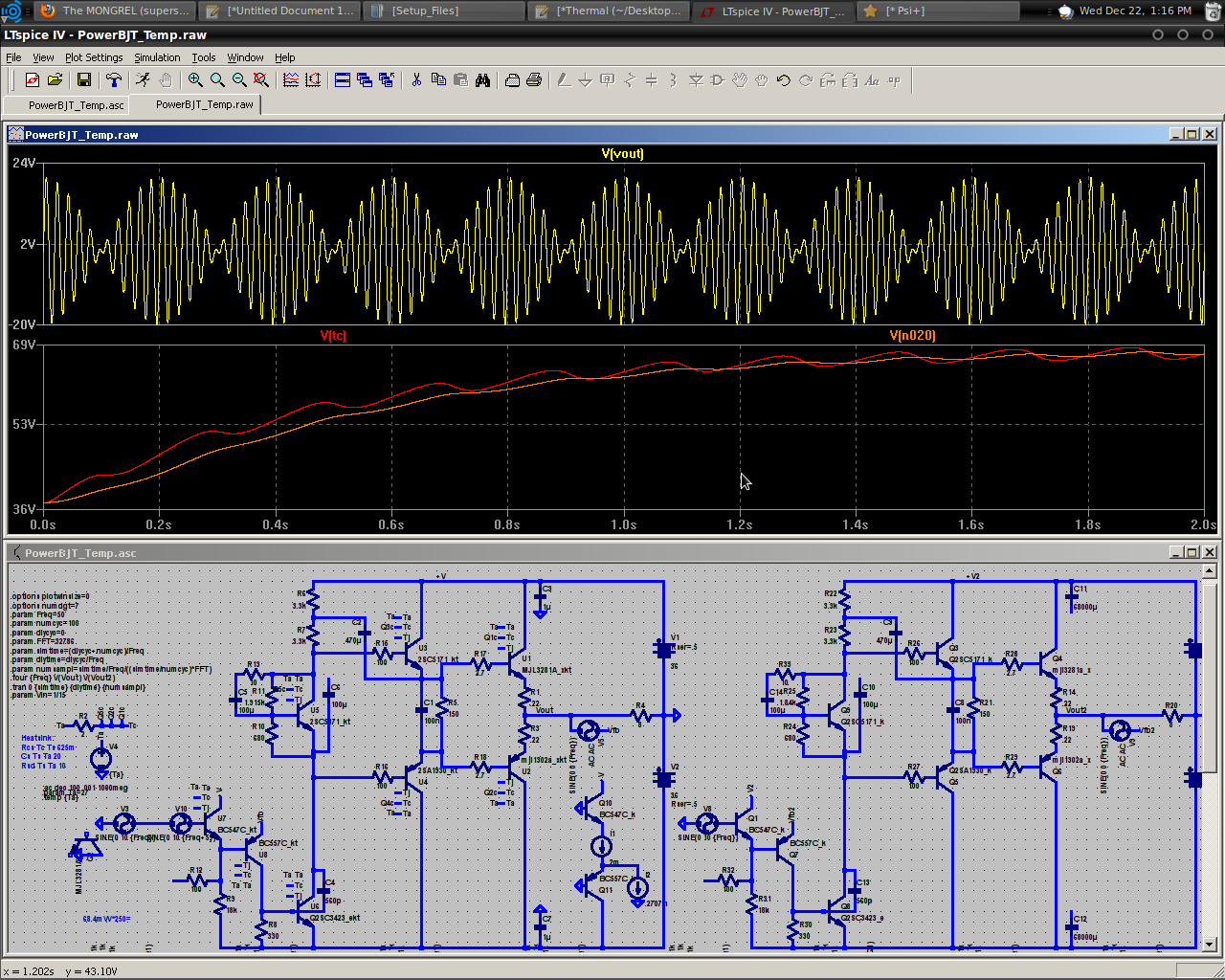

BTW, I'm trying to implement rudimentary thermal simulation in LTSpice. Guess what? you get convergence errors if your circuit has thermal runaway.
Distortion profile changes a lot too. But I would have known this if I had just done the math (Remember, lazy people work 3 times harder). Most of it is increased 2nd harmonics from the VAS. In this case the feedback transistor also contributes, because the test amp has no gain and it sees the full voltage/power/dissipation swing of the output.
So there it is. Thermal distortion DOES INDEED EXIST.
First plot is the FFT with/without thermal simulation (Red/Orange). Second is the heatsink temperature (red) and junction temperature of the Vbe multiplier (orange) at 50Hz+55Hz. Heatsink is 2C/W.
- keantoken
